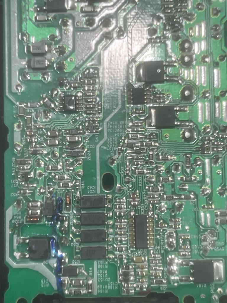

    ps4 slim power ADP-160CR afetr rehot working
    i have a pb with this power supply . after not conected to 220v a few day not working . but i open it and rehot it 3min its working good . i have tested some spart in power supply all is good .can wen help me to repair it ..

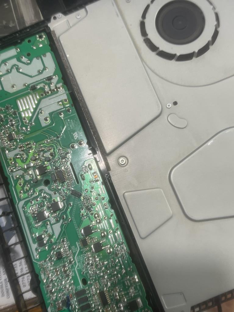

    Sony PS4 slim CUH-2216A power supply ADP-160FR not working after short in PFC
    by modtool
    Dear forum members,
    I'm working on this power supply for ps4 slim, that behaves in a similar manner as other cases but I can't find a way to solve the problem.
    When it came to me, externally the ps4 had standby voltage, clicking the disc eject button made the triple beep (without disc inside) and cliking on the power button made the blue power light turn on and then all turned off within 1 second.
    When I opened it up, I found these components shorted:
    Q6 24N60M2
    IC41 1612A (not really shorted but had a hole on it and all pins measured open circuit but the 9th...
