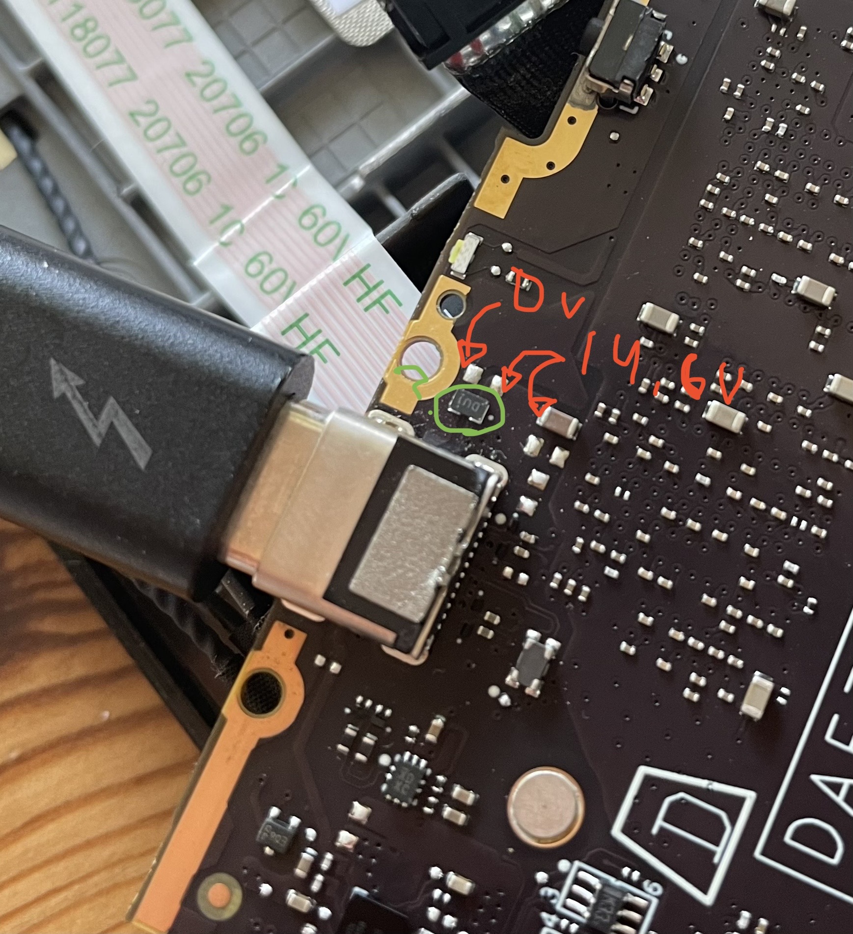

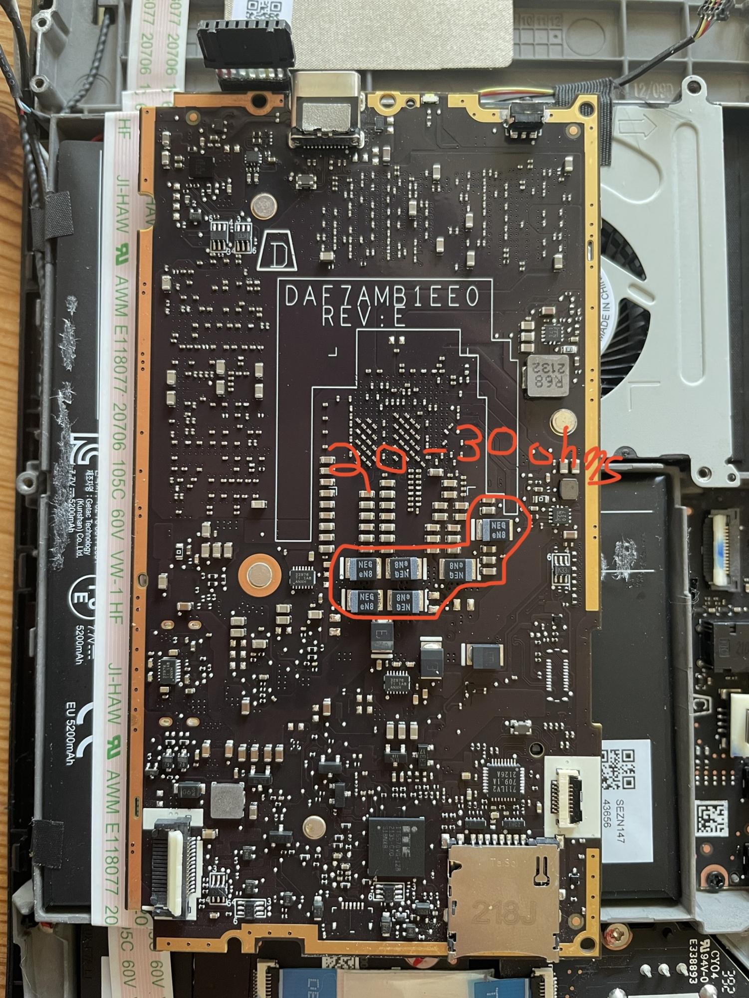

    I have this steam deck that has no current draw. I did a visual inspection and found nothing.
    No dead short either, but these caps show 20-30ohms.
    Any idea where to start? Thank you!
    EDIT:
    Noticed something with voltage. Is the component in green faulty?

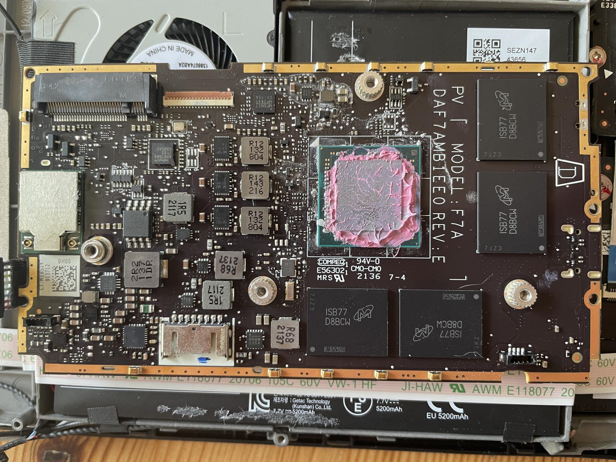

    what is the white staining? liquid spillage?

      Looks like thermal paste, I have no idea.

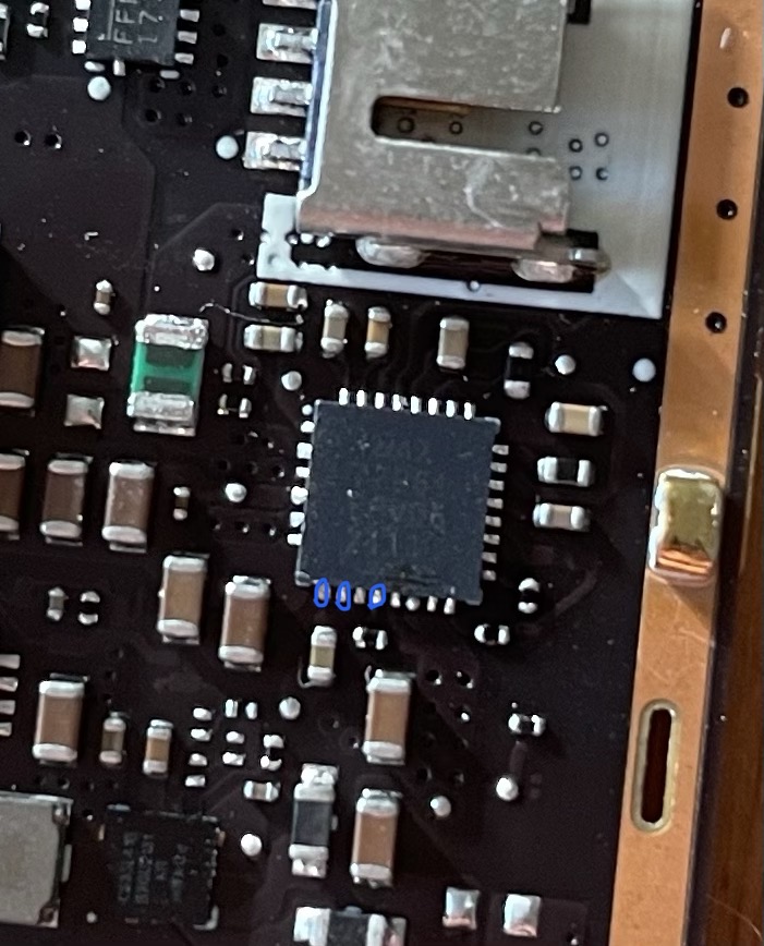

      Upon continuing diagnosing, I have found some pins on the charging IC that have 0.2ohms to ground.
      Here is the IC: https://cdn.badcaps-static.com/pdfs/...b3d10ef42c.pdf
      Is it normal if these pins are shorted to ground? Others are too, but I'll start with these :
      Circled in blue

        the thermal paste is pink,
        the white stuff is all over a buck convertor circuit!

          I have to scratch to remove it. Do you think it could be metal liquid paste, but then later replaced with pink thermal paste?
          I'll try cleaning with alcohol

            those pins may be o.k. - 7,8 & 10
            does this have a battery or just external power?

              it's not liquid metal (galium), that would disolve aluminium and probably solder
