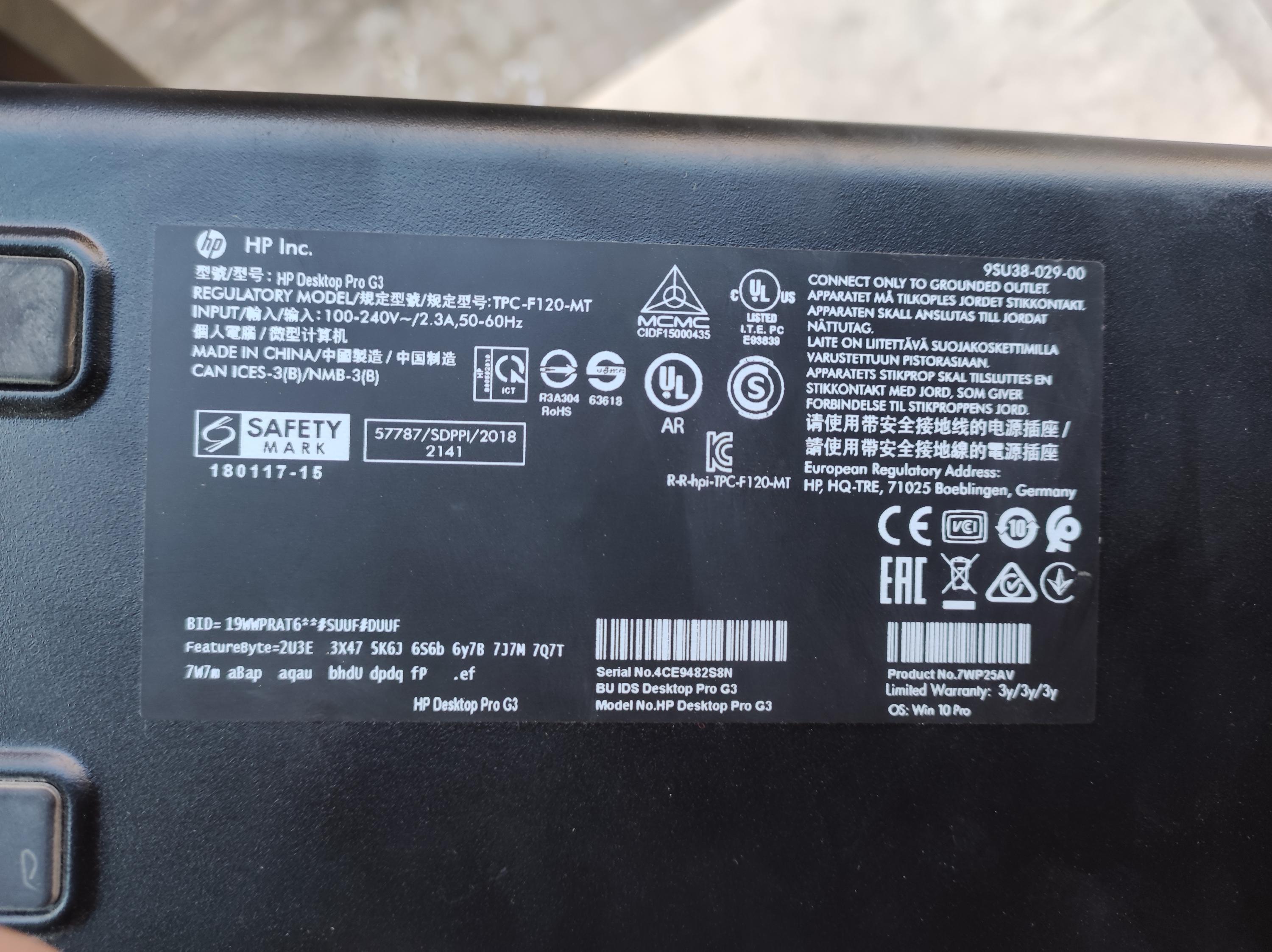

Need bios repair hp desktop pro g3
  • OKRPKCOMP
    • Dec 2020
    • 429
    • PAKISTAN
    Board code : Princetor rev a
  • hoaca388
    Badcaps
    • Jan 2022
    • 11234
    • Viet Nam
    Re: Need bios repair hp desktop pro g3
    HP Desktop Pro G3 MT

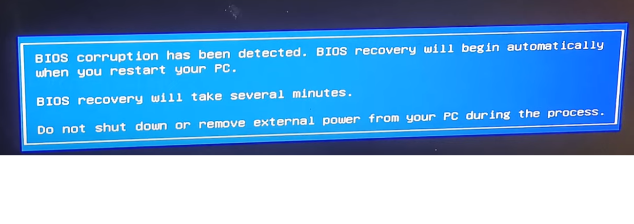

        Thanks sir
        working
        HELLO, THIS DUMP DID NOT WORK FOR MY HP DESKTOP PRO 300 G3 MACHINE SN:4CE0490WSS
        SHE ALWAYS DISPLAYS THIS MESSAGE
        (photo).RECOVERY WITH USB DID NOT WORK
        • cyncomm
          • Dec 2019
          • canada
          Re: News hp machine problem bios recovery
          Firstly, Did the PC do this straight out of the box??
          Or did you attempt to update or modify the BIOS then get this error??
          New HP desktops have a self repairing BIOS. It keeps 2 copies the Picture shows the HP initiating self repair which is copying the protected BIOS over to the operational BIOS. This process could take several hours and should not be interrupted.

            I don't know. machine for repair
            It's a new machine. I created a usb recovery bios from the official hp site. the message persists. I unsoldered the bios ic and I programmed them with another bin file from the same motherboard but still the same message

                      hello!
                      I HAVE PROGRAMMED THE BIOS WITH THIS DUMP EXTRACTED FROM THE OFFICIAL HP SITE, BUT THE BLUE DISPLAY ALWAYS APPEAR WITH 8PEEB AND RESTARTS WITH THE SAME BLUE MESSAGE and the same beeps non stop
                      • hoaca388
                        Badcaps
                        • Jan 2022
                        • 11234
                        • Viet Nam
                        Originally posted by aboumohamed
                        hello!
                        So the error appears not in bios.
