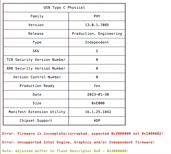

        well, 1st time when you wrote the file I sent you, you said it wasn't work. 2nd time when you wrote it in bios chipset it worked ... so, where was the problem? 32Mb chipset contain Bios_Region so Computrace is in it, no need to modify 16Mb chipset usually but you seem to have also problems with ME firmware. So you need to do a clean ME to your full bios.
Name:	Screen Shot 2025-04-02 at 20.30.23.png

          #184
          I will try to do this myself and report back. First time performing an "ME" clean.
                Hi volinakis , I was unsuccessful and got stuck. I was able to install ME Analyzer, get the same output in you screenshot at the bottom when loading my 16mb file. When I go to find the right firmware (attached in screenshot), I does not seem that my version is available out there to use as a base file for the cleaning process. Do you know of anyone that has gotten their ME Cleaned with version 16.1.31.xxxx? I'm only seeing all the guides go up to version 15.x.x.
                Any help is appreciated, I'm really stuck on this next part.
                Thank you,
                - Brian.

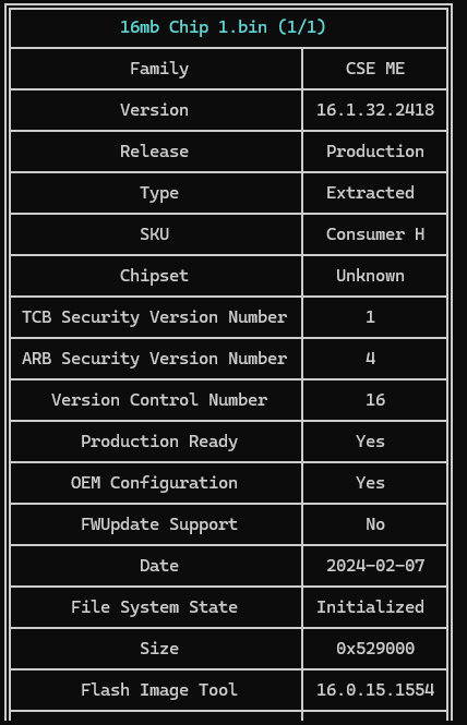

                    Originally posted by redcapangler
                    Is it possible I could just load the bios from this older post to resolve my issue? Or would that not work?
                    Thank you,
                    - Brian
                    I tried this and it did not work. I'm trying another bios from this thread for the 16mb to see if that one will work. Really stuck here.

                      #192
                      Did not work, posting my original files to see if someone else can assist? I'm looking to have absolute disabled in both of these files / cleaned ME please.
                      Service tag is JXHJ5S3
                      I've been struggling for about a month in this thread trying to get this fixed, any help is truly appreciated.
                          - Brian
                          OptiPlex 3000 Micro
                          Service Tag: JXHJ5S3​

                            #195
                            hoaca388 - these worked perfectly. Can you explain how you performed modifications to the 16MB file to clean the ME especially with version 16.1.32? Or can you point me toward any other resources on how you did this?
