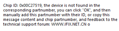

                          Hi everyone. I have a Dell Optiplex 3000 Micro and the issue is device freeze. I have basic knowledge in computer repairing and this is my first time encountering an issue about bios. So, I purchased a cheap bios programmer online which is CH431A. And I don't know if I used the software to get my backup bin file properly.
                          Service Tag: 4SC6ZS3
                          Express Service Code: 10420663971
                          Bios Chip: MXIC MX77L25650FZ4I42A (detected in software as MX25L12805D)
                          I attached backup bin from bios chip.
                          Thanks in advanced, Master and Legends.

                            flash both
                            1st boot, press F2, write service tag, disable Absolute, save, restart. 2nd boot press Alt+F to exit manufacturing mode.

                              Good Evening Rex, I'm sorry for being confused. do I need to flash it to one bios chip?

                                on both there are two bios in that model

                                  Thank you very much, Rex. One last question. What is the best programming software I can use with CH431A.
                                  • rex98
                                    • Feb 2023
                                    • 1293
                                    • Mandaue CEBU, Philippines
                                    #117
                                    neo programmer

                                      Thank you so much. I have one problem now, Neo Programmer was not able to detect my big bios chip which is mxic mx77l25650fz4i42a. I am using CH431A Tool.

                                        install the driver

                                          How to add chip support to NeoProgrammer software for the CH341A Programmer https://www.badcaps.net/forum/troubl...41a-programmer
