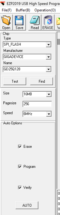

            I have an Optiplex 3000 micro
            Service tag: G3487Y3
            SERVICE CODE: 35017017915
            GIGADEVICE = 25B128ESIG
            GIGADEVICE = 25R256EYIG
            My BIOS had a password.
            I have an Eprom EZP 2019+
            I did the bkp of mine = 25B128ESIG
            I used the (alligator clip) of the ezp 2019+ to read and write the 25B128ESIG
            I did not use it for the 25R256EYIG.
            Now my motherboard only turns on the orange light when I press the (power). To turn it on I have to hold down the button.
            In the list of names
            * EZP2019 *
            GD25Q128
            How to resurrect?

              #206

              Fault backup.

                #207
                Originally posted by hoaca388
                Fault backup.
                How should I resurrect the BIOS,
                friend.
                Thanks.​
                  • 21889
                  #208
                  friend.
                  Thanks.​
                  Change the speed to 6Mhz and try again.

                    #209
                    I don't have a correct BIN then;
                    Do you have one for this board?
