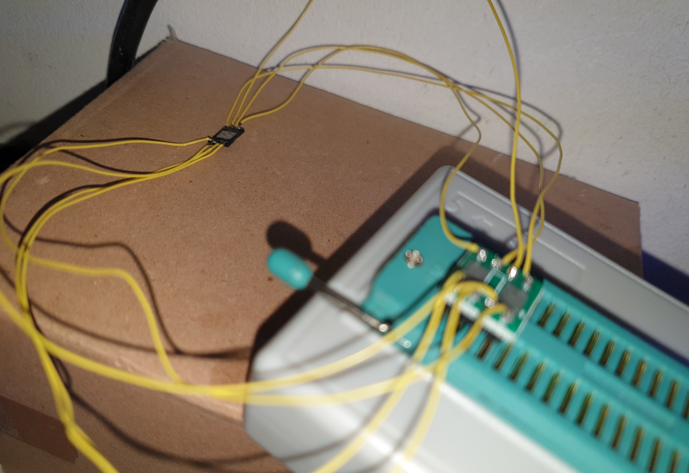

          Just upgraded the XGECU software and TL866 firmware and now the reading is correct...
          here the dumped bios with a correct lenght:
          (i'm using wires directly on de-soldered eeprom)

            • Bartoloni
              • Jul 2018
              • 140
              • Italy
              Re: searching for ASUS Prime X570 PRO bios dump

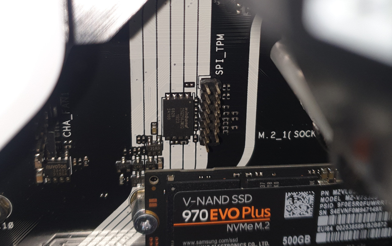

              This motherboard do not provide the ASUS flashback. (is not a feature and there is not the flashback button)
              i saw near the eeprom the TPM module connector... but.. is a TPM connector.. not sure it can be used to connect the programmer to the eeprom..
              as my first try i connected all the 8 wires directly to the eeprom ( directly on PCB without de-soldering the chip) but the TL866II+ was not able to recognize the chip. after that i desoldered it.
              (wires are longer because they was the same used to dump directly on the mainboard but i dumped the chip 3 times without any change on md5.. and i'm pretty sure was not corrupted.. also using my serials-reader a lot of infos are read correctly. www.wcn.it/BIOSdump2license.zip)

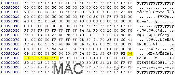

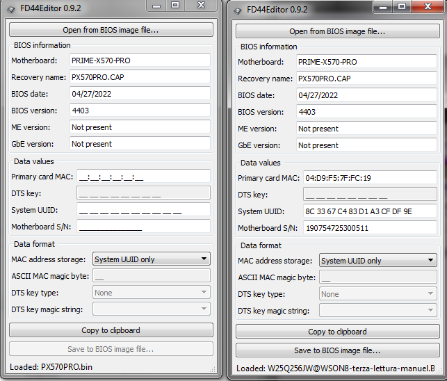

                Bios from the Asus site is transferred from CAP to BIN.
                • lotas
                  • Jan 2016
                  • 4835
                  • Russia
                  But from asus site in bios you will lose SN, MAC, UUID. You need to edit dump.
                  • Bartoloni
                    • Jul 2018
                    • 140
                    • Italy
                    Oh WOW! thank you lotas! i never seen before the FD44 tool, very usefully
                    the dump need to be edited manually using an hexeditor?

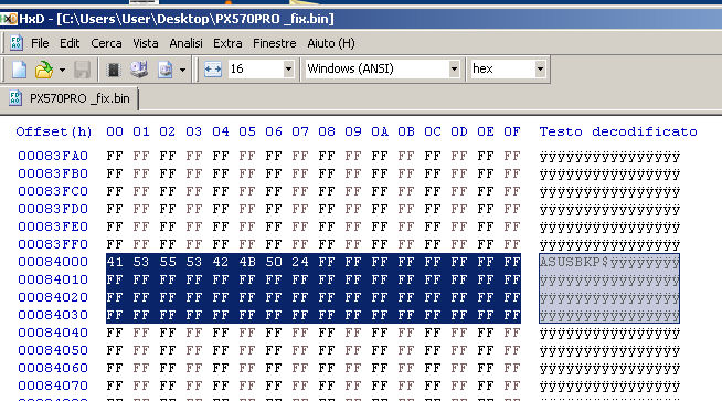

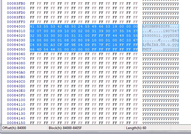

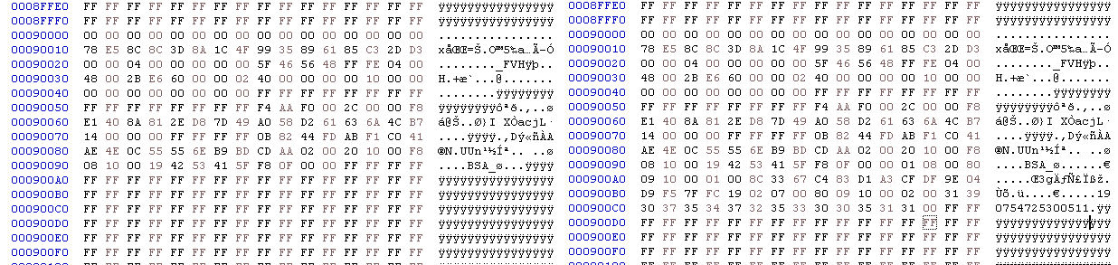

                      • 22097
                      you can do. copy the block 84000 - 8405F
                        PX570PRO _fix
                        • lotas
                          • Jan 2016
                          • 4835
                          • Russia
                          No, just copy from one window and paste it into another window and save.

                            • Bartoloni
                              • Jul 2018
                              • 140
                              • Italy
                              If i can ask... using what tool you was able to identify this address?
                              (sorry for boring you ... but i'm not a bios specialist and i'm very interested on understanding what "happens" on these eeproms)
                              (on the version provided by Iotas, at this address there are no data.. but FD44 tool can read correctly the MAC address and other data)
                                • 22097
                                Using HxD hex editor i searched for the word ASUSBKP

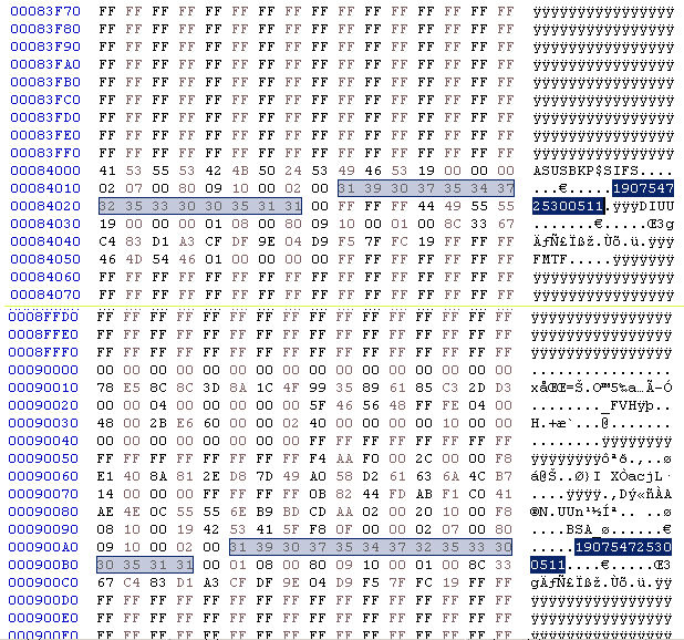

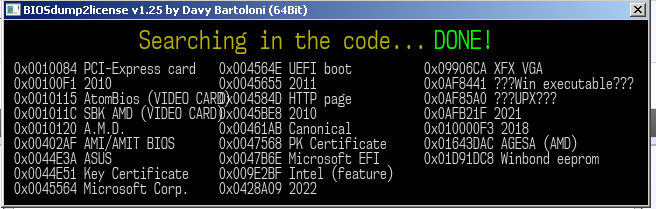

                                  • Bartoloni
                                    • Jul 2018
                                    • 140
                                    • Italy
                                    Looking at original bios dumped there are 2 address related to serial number:
                                    (maybe it's necessary to find BSA ? )
