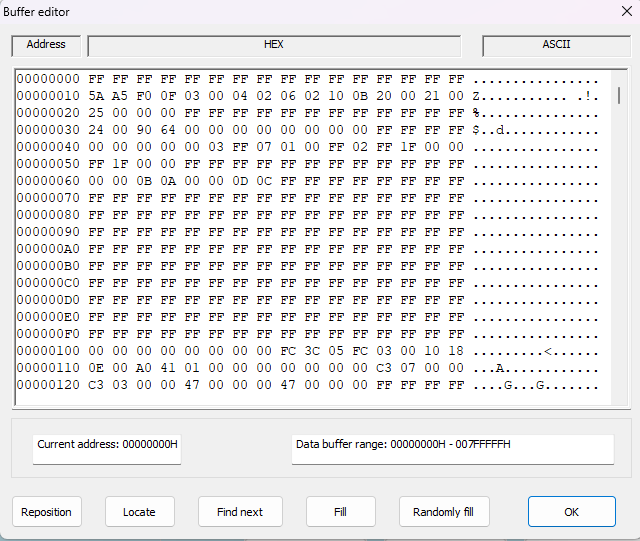

    please help me bios needed original bios i added here

    Re: biostar j1800nh2 ver:6.0 bios request
    Did you look for the bios at the support site https://www.biostar.com.tw/app/es/eo...D=727#download
    Rename from .BSS to .bin if your programmer doesn`t recognise the file extension
      Hello, I downloaded it from the site, the content is very different from the original, so it does not work.
        • 20781
        Its the right bios for the motherboard.It will look different as the TXE firmware hasn`t been initialised until its booted (it will only change if the board is working with no other faults) ,and the NVRAM is not populated until its booted.
        Make another backup and compare with the unbooted virgin bios,if both files are still the same the motherboard isn`t posting,the bios isn`t being read or written to.

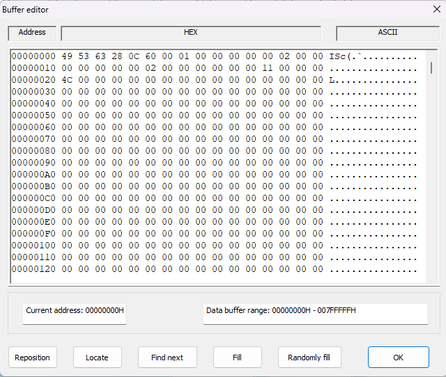

                I wrote the cap file that I downloaded, the device did not work, but there is no image in the original bios.
                  • 20781
                  Is your programmer an EZP**** ,i think your programmer is trying to remove a CAP header that isn`t there. It isn`t a cap file,just rename it from .BSS to .BIN before programming

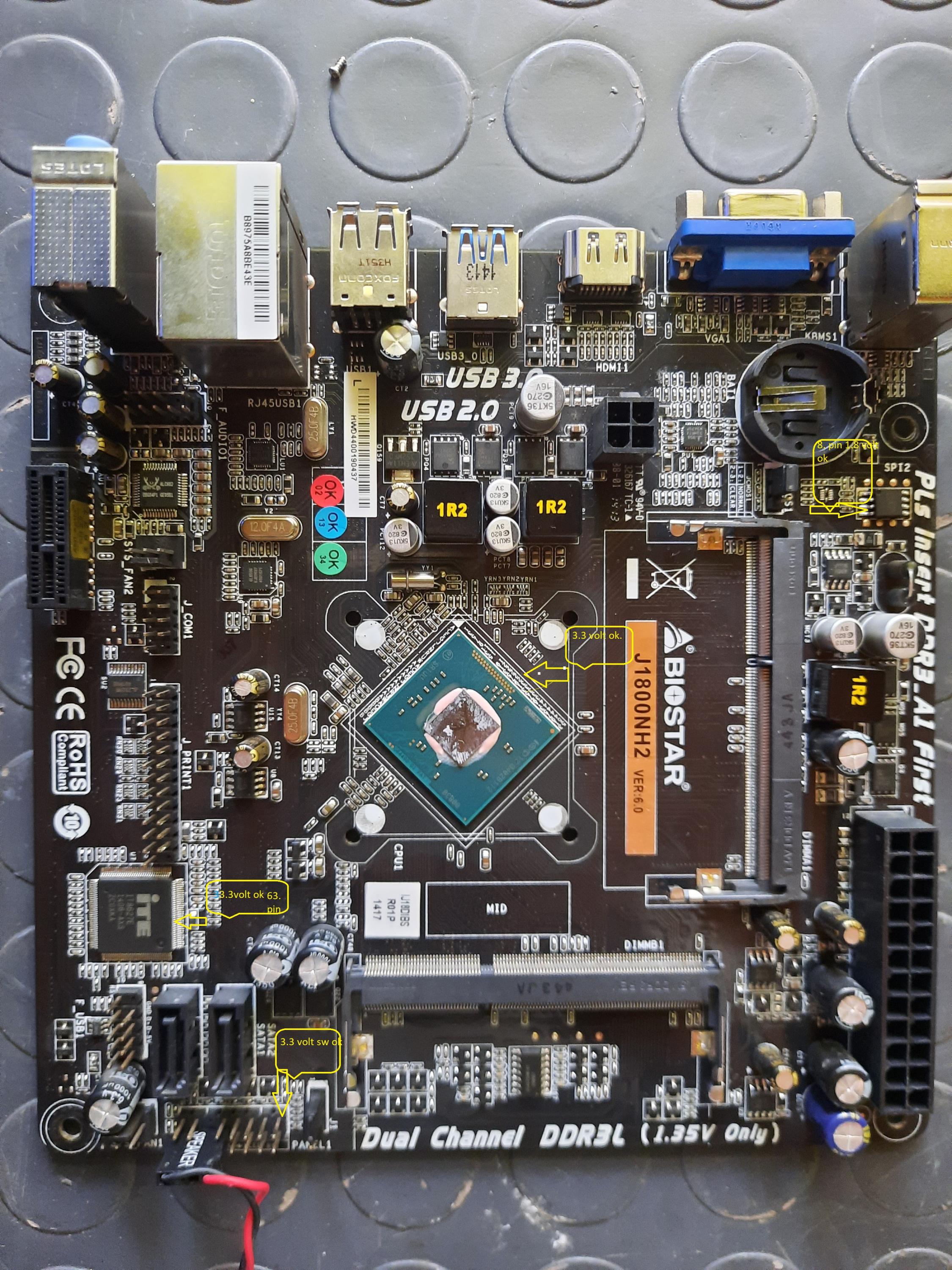

                      Hello, I wrote bios but it didn't work. I added a photo, I showed it in the related volt photo, there is no error, but it did not work

                          biostar J1800NH2 VER:6.0
                          Hello, the motherboard does not start, I have shown the volts in the photo, I really need a working bios, please help, I backed up the original bios.

                            • 20781
                            Re: biostar J1800NH2 VER:6.0
                            Desktop PC bios requests and schematic requests ONLY go here: https://www.badcaps.net/forum/forumdisplay.php?f=15
                            Desktop PC repairs (Not bios requests or schematic requests) go here: https://www.badcaps.net/forum/forumdisplay.php?f=14
                            The two parts of the forum are seperate. There is no need to post the same bios request again, i have posted a fully working bios for you.
                            When you write the bios select the chip manually,do not use auto-detect, the chip part number is etched on top,choose it from the support list. When you have written it it should automatically verify. Read it back again from the chip to make sure it has actually written to it,and compare it with the file i posted using a hex editors file-compare function. I use HxD hex editor,its free and there is a turkish language version.Just open both bios with it then select Analysis -> Data Comparison -> Compare .If they are the same then the bios has been written correctly and the problem is somewhere else.
