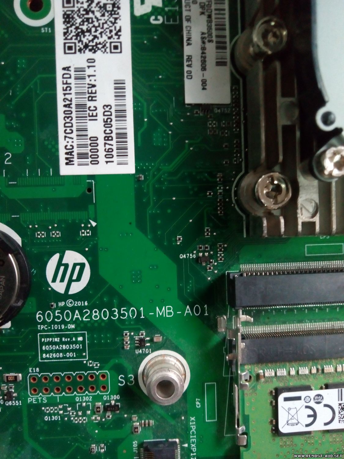

    HP 260 G2 6050A2803501-MB-A01 bios
    HP 260 G2 anakart 6050A2803501-MB-A01
    bios
  • satishkumar
    • Sep 2015
    • 164
    • India
    Re: HP 260 G2 anakart 6050A2803501-MB-A01
    bios
    pc resim ekte var
    upload old bios and serial number

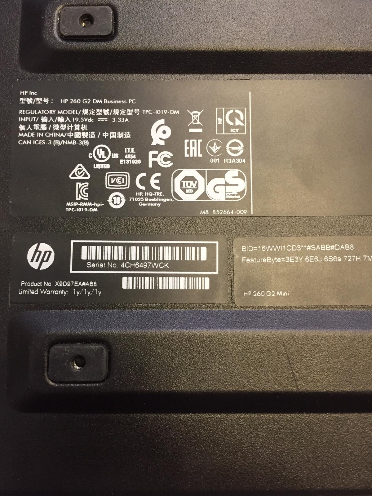

          hello this bios worked for me but serial numbers are missing i am throwing old bios if you can help i would appreciate it
          sn:4CH6368VKT
            • 21145
            Re: HP 260 G2 anakart 6050A2803501-MB-A01 bios
            sn:4CH6368VKT
            The posted bios is corrupt. Use HP BCU Bios Config Utility to enter the missing DMI.

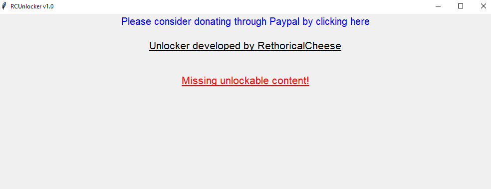

                  Have you read the bios guides and tried RCUnlocker ? https://www.badcaps.net/forum/troubl...=4#post1622423
                  • maddmaxx
                    • Nov 2024
                    • 3
                    • Portugal
                    I Have a HP 260 G2, and I tried everithing I remember to remove password. I tried to use the RCUnlocket, however the message in the picture is showed. I assume this Bios is not supported by the software.
                    Have you any idea about what can i do to solve this problem?
                    Thank you in advance.
