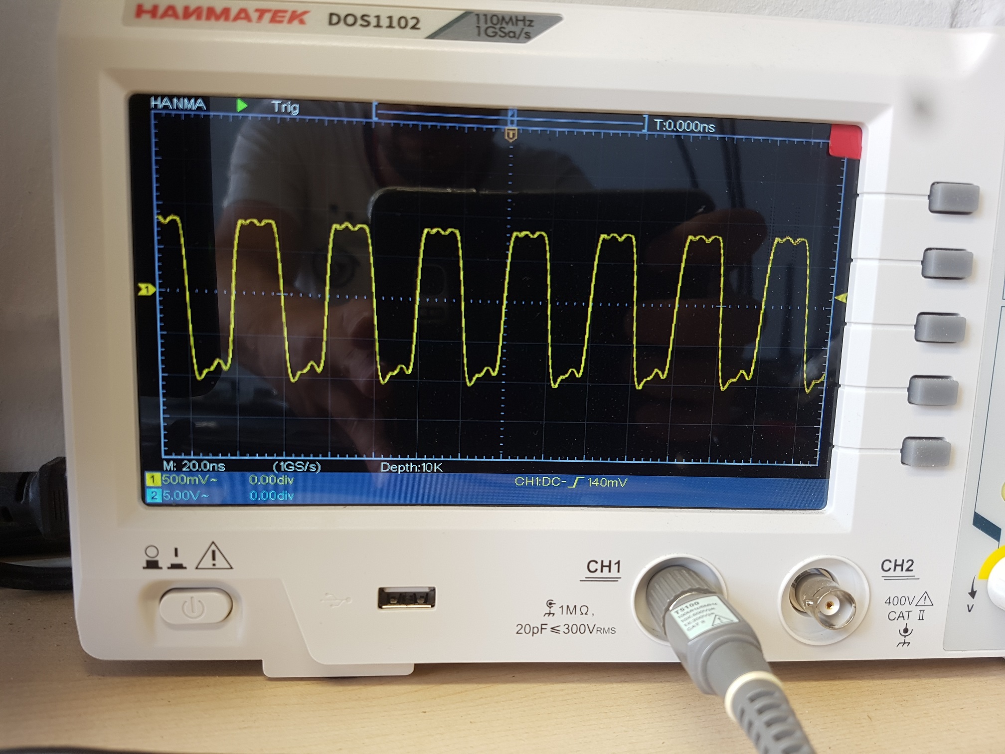

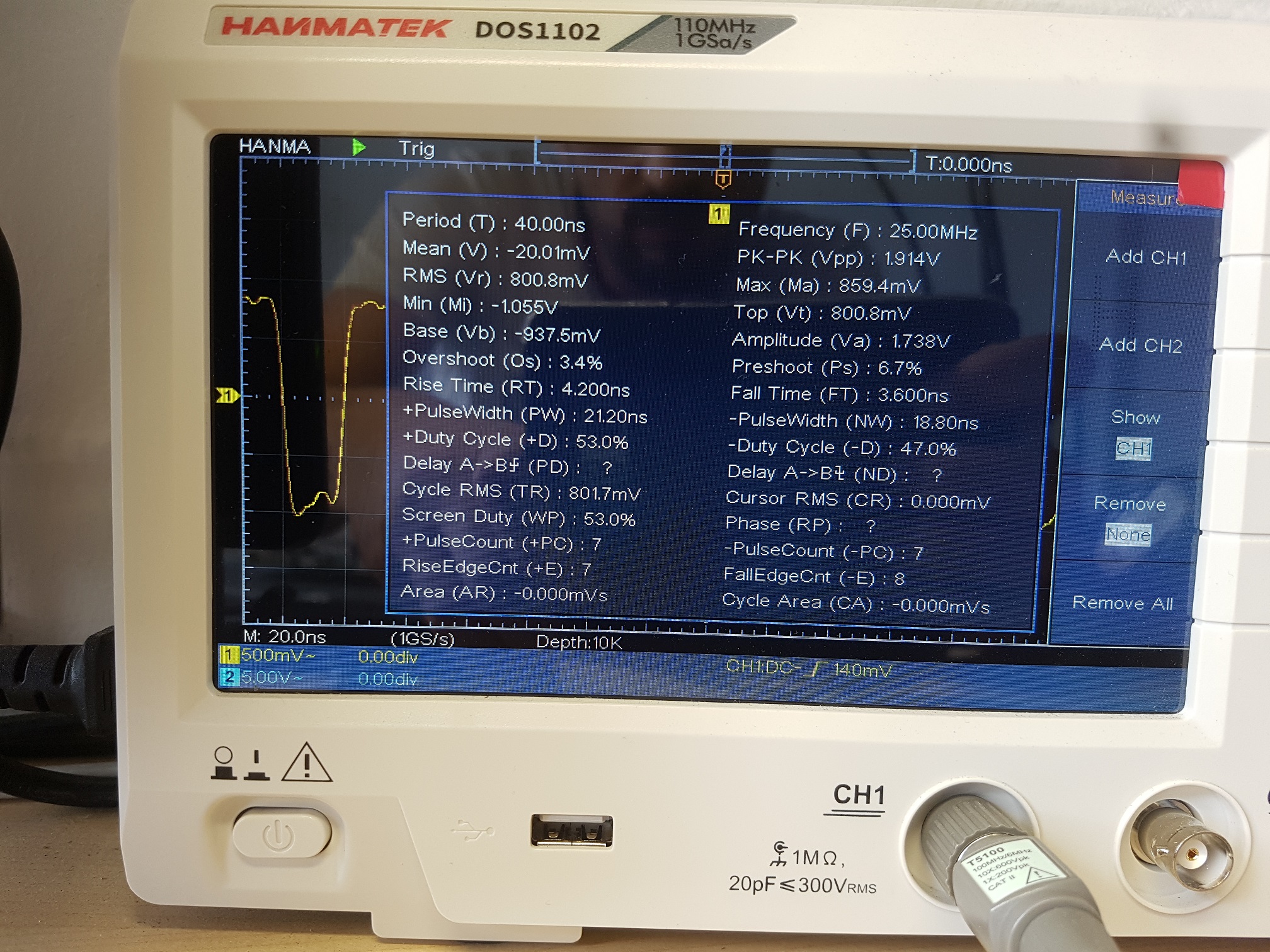

        Re: NAS QNAP TS-651 - Long shot, anyone with BIOS dump?
        Sorry forgot to upload the 8MB main BIOS
        Here it is.
        I also got a file from QNAP support, I also upload it here in case someone needs it.
        I flashed the dump support sent me and same thing.
        Heres a pic of the clock of the LPC connector.
        Its fine right?
        Tried with pullup and pulldown 100ohm resistor, still no boot...
        Think ill give up on this unit
        Cheers
