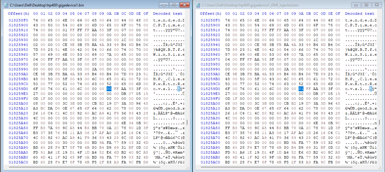

              Hello all, I have a question. I have HP Prodesk 400 G7 SFF, SN CZC134C1DB, it had bios password so i read the chip, removed password, flashed file back and password disappeared but all the fields like SN etc are empty. When i tried to inject DMI from the original file to unlocked one (without password) , password came back. Have you got any suggestions on how to fix it? I attached bin files, original one with password and cleared one. Thanks in advance for any help

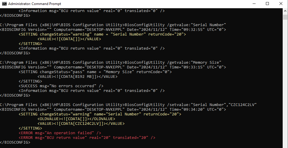

                Use BCU to restore DMI.

                  #68
                  Thanks for your answer. I tried to do it, I have created a file using BCU, then I've added SN, Build ID etc. but after setting config and reboot it's still blank. Any suggestions? When i try to change it with command I'm getting this error

                    #69
                    I found different way which in my opinion is much easier than removing password, injecting DMI etc. I want to share it with you guys but I've tested this only with one PC so I may be wrong. If you edit ClearPwRtcRemoval hex it enables password removal after removing bios battery and all information like SN, SKU etc. stays untouched
