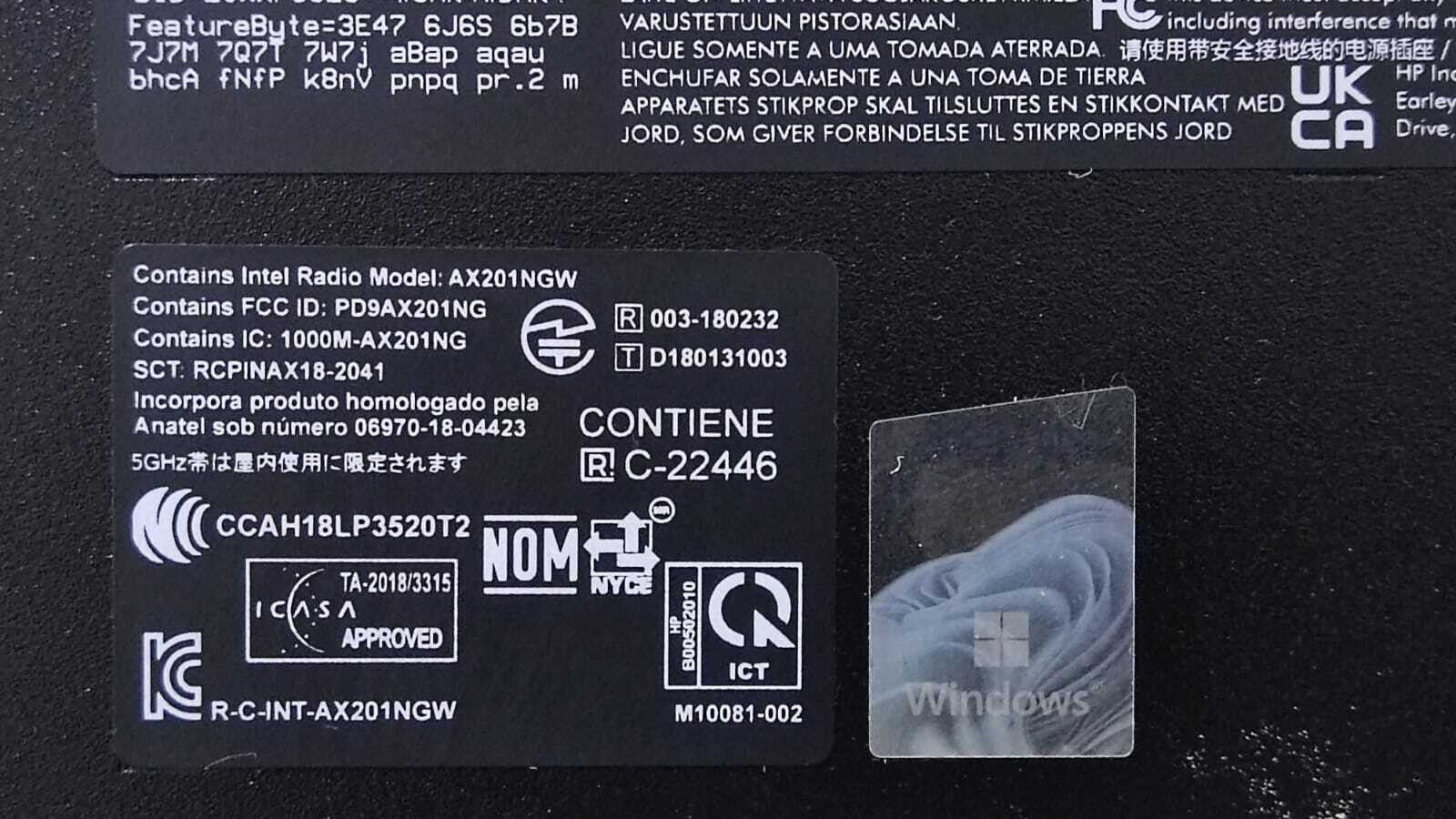

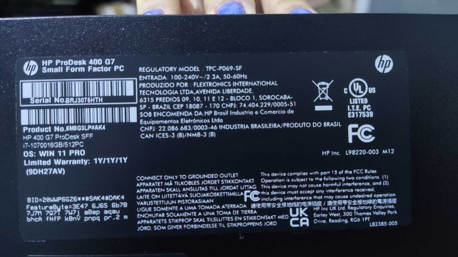

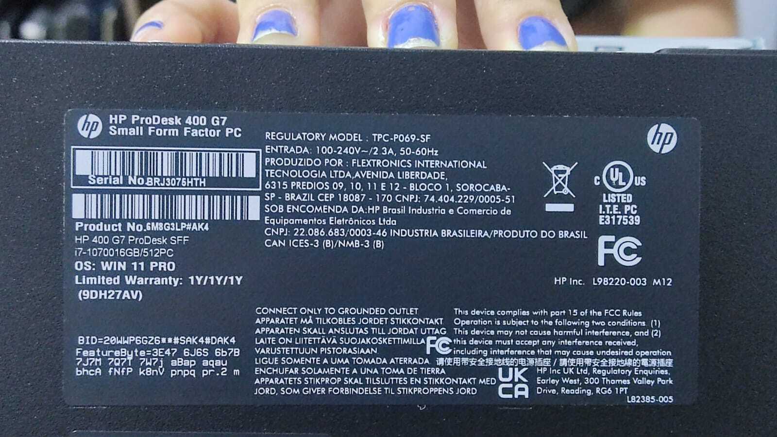

    • All original system stickers (Serial, SKU, FeatureByte, BuildID, Board ID, etc.)

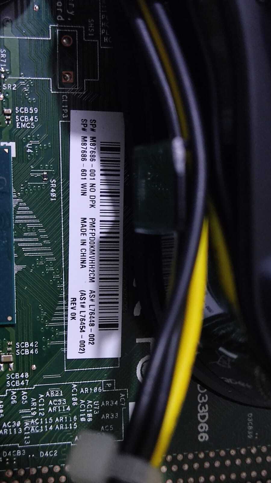

    • Motherboard part numbers (M87686-001 / L76448-002 Rev 0K)
    • Photos of the board and labels
