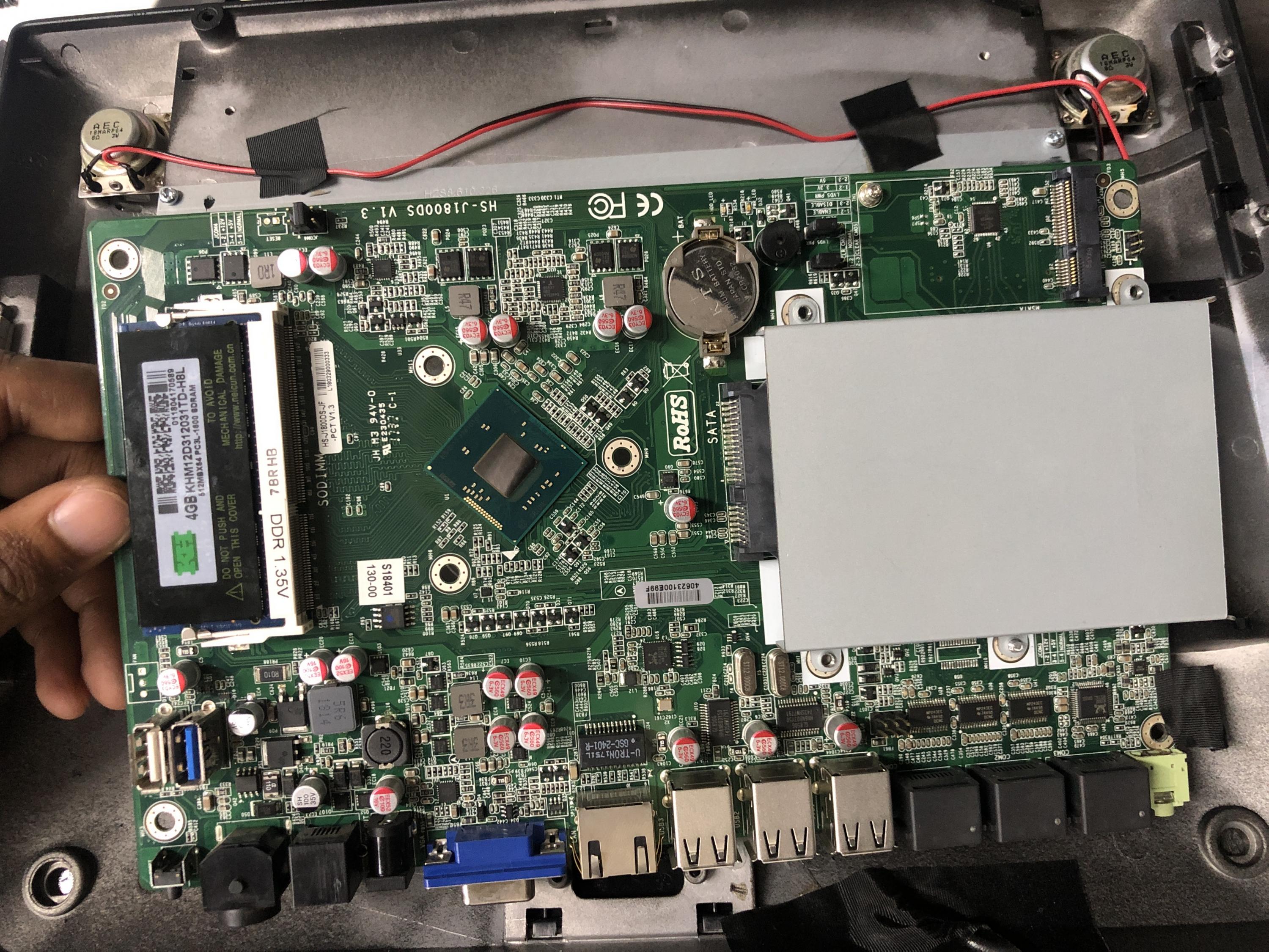

Hello guys I'm looking for Hisense Hk570 bios , it used on till , but the board is same for laptops
Hisense hk570 POS terminal bios needed
Re: Hisense hk570 POS terminal bios needed
Did you manage to find the bios? I have the same machine, all voltages are good but no picture, it restarts cyclically. -
I am attaching the original BIOS with a clean TXE-region for the SR1UT processor.
If the CPU on the board is replaced with the SR3V5 model (newer version, stepping D1), the BIOS with the appropriate microcode must be uploaded. Without this change, your computer will run very slowly.Comment
