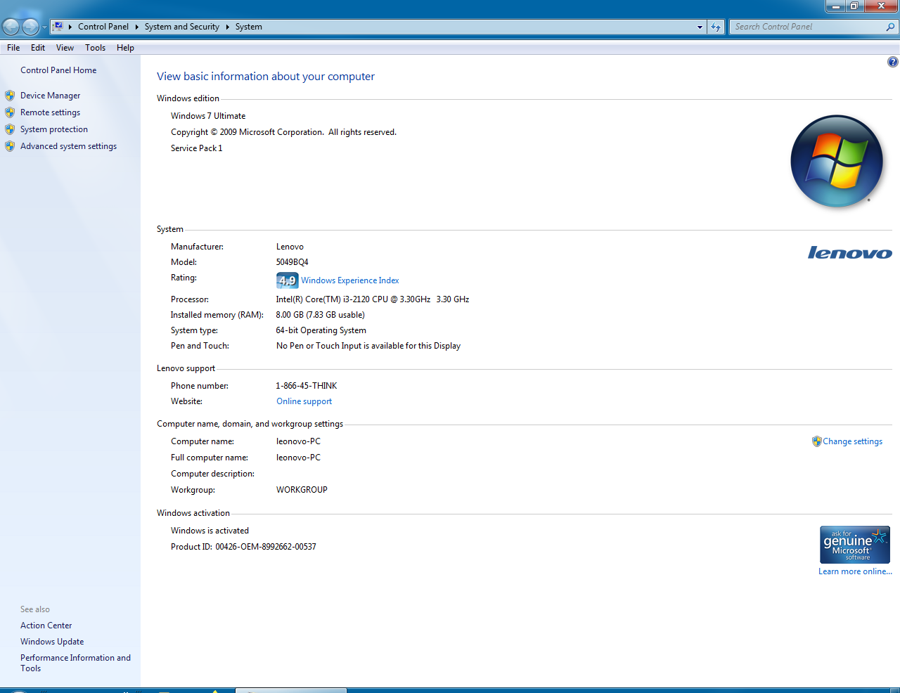

    Machine type 5049
    Product ID: 5049BQ4
    Motherboard: Lenovo IS6XM REV1.0, FRU 03T8182

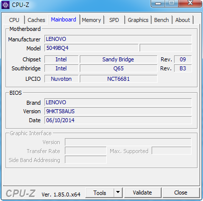

    Flash BIOS update - ThinkCentre M81, M91, M91p / ThinkStation E30 said 9hj958usa is the latest release of BIOS but I remember that the latest 3 word were AUS, not USA.

    Update, I found screenshots:
