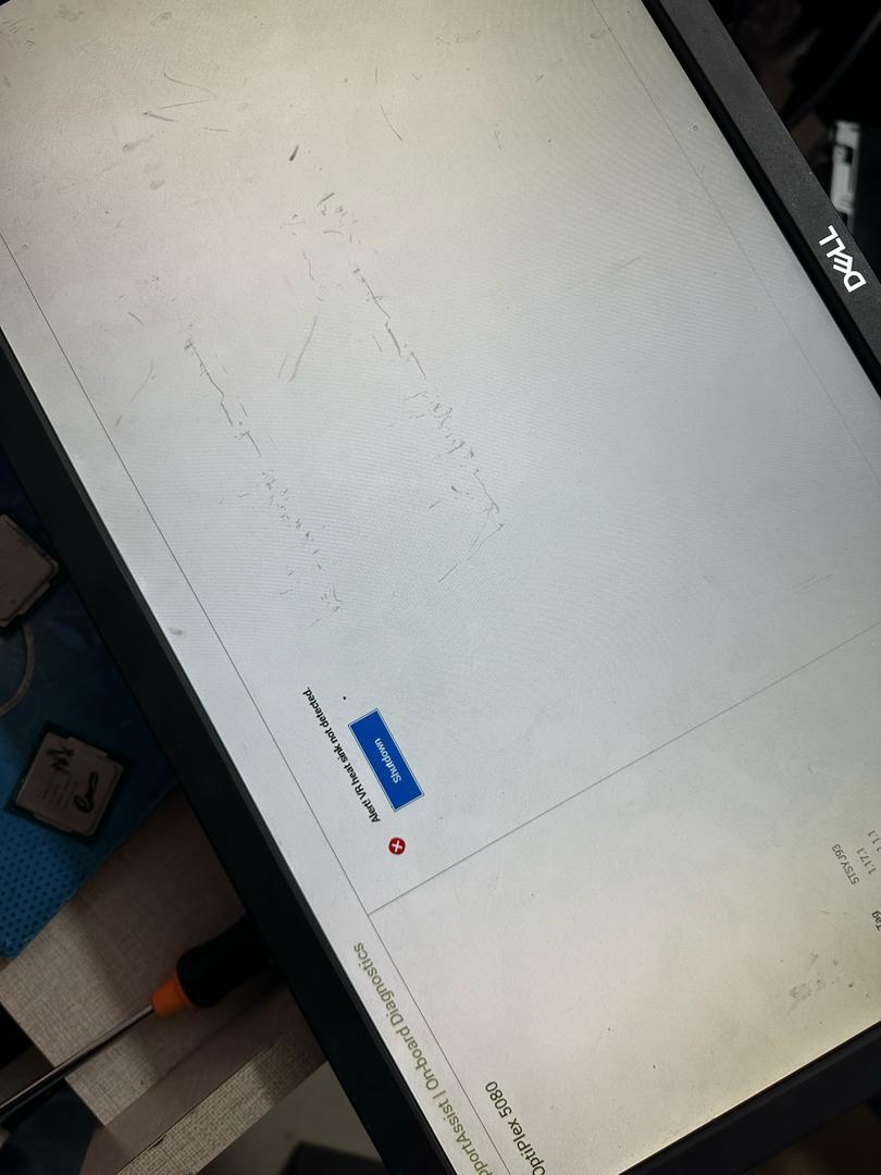

                          I recently upgraded my Optiplex 5080 SFF from i5-10 to i7-10 th and after that, on every boot I received and error showing this message: Alert! VR Heat sink not detected.
                          how to bypass this error without installing this vr heatsink? i update the bios but same problem
                            There is no problem with the bios. Similar model here - https://www.dell.com/community/en/co...e27cad9?page=2 ,bridging a wire between the 2 screw holes will work, but it is still recommended to install the heatsink.
                              thank you it works with bridging a wire between the 2 screw holes
