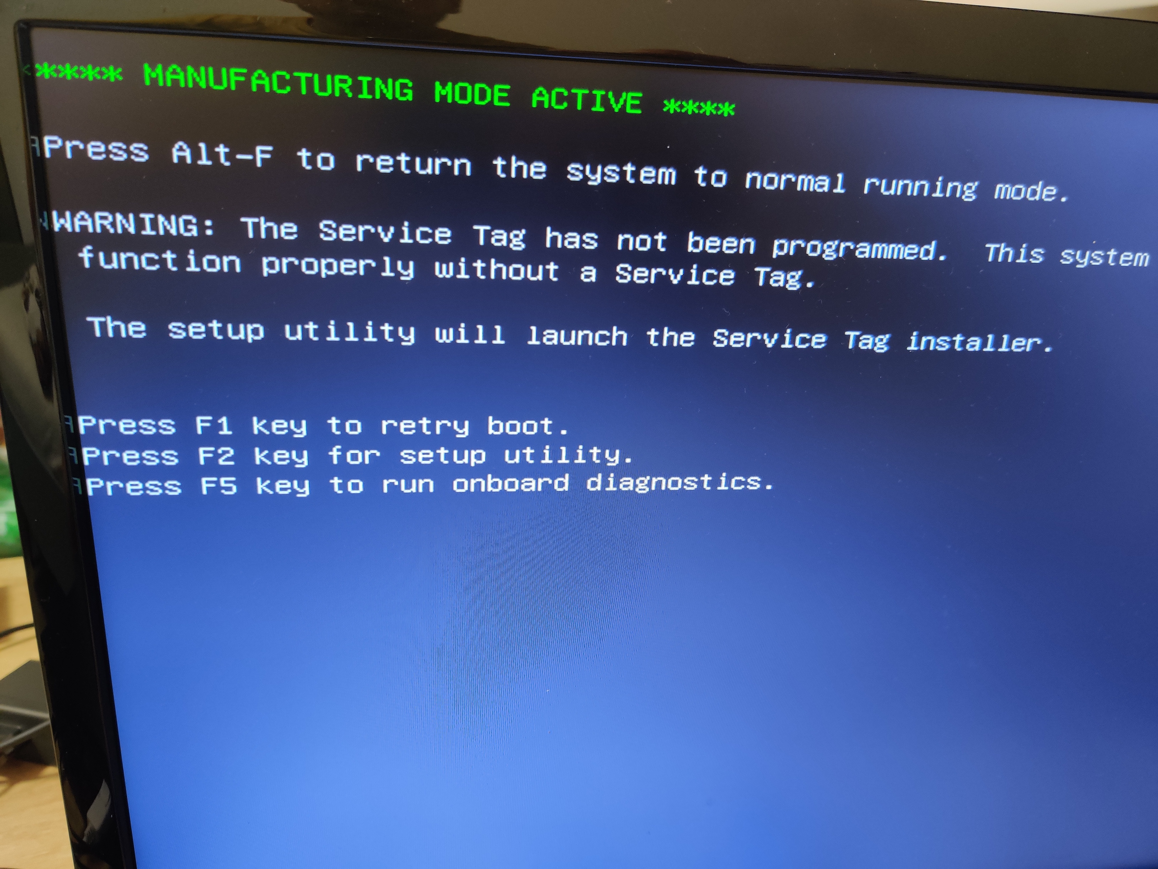

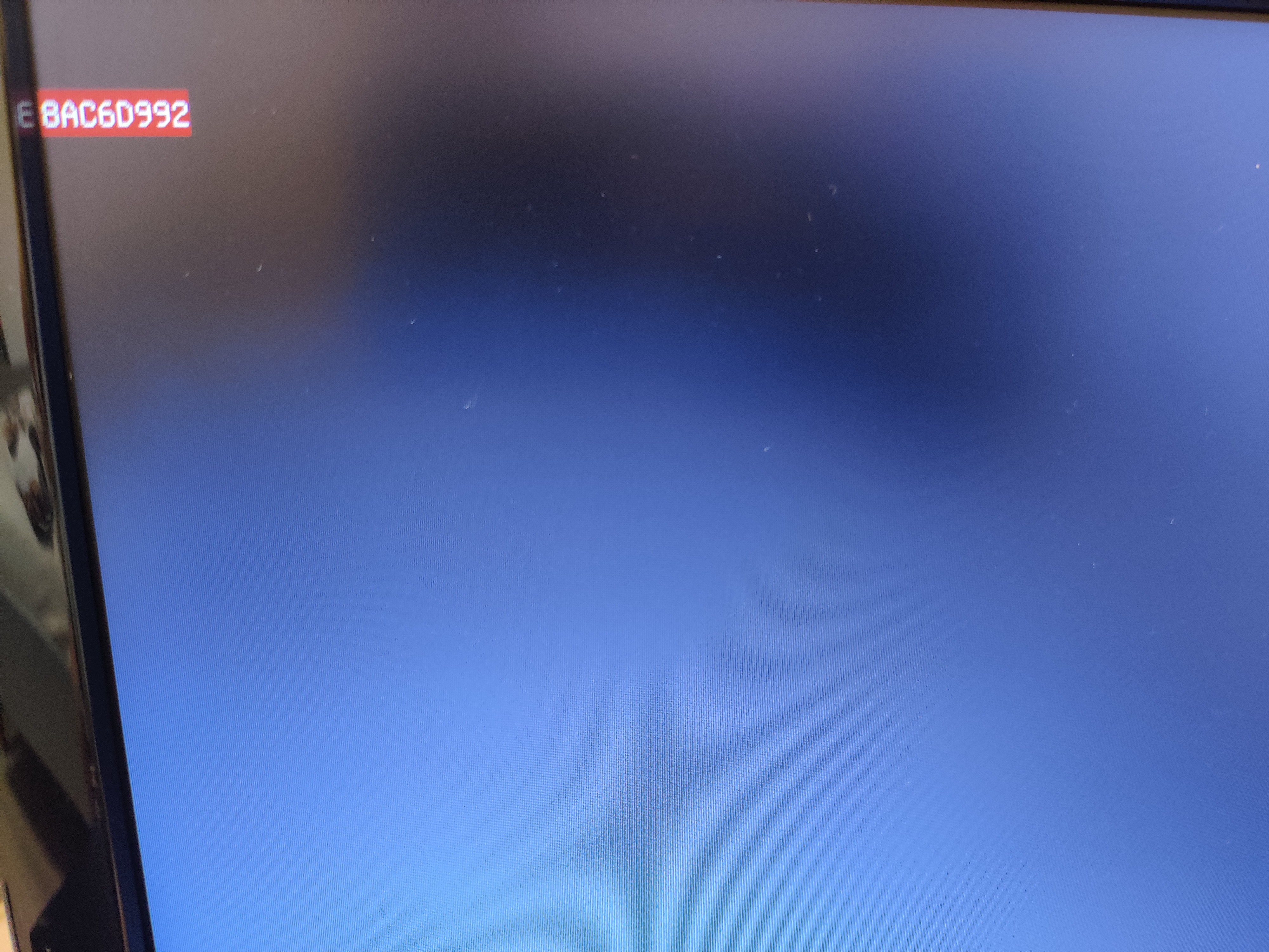

                                      Unfortunately none of those two versions works. Still the same error. I tried to save the service tag in the BIOS but after it reboots it's the same again. Like BIOS won't remember service tag and PC's always in the same loop. Thanks a lot for your time and effort.

                                        Hi
                                        How you get option for change service tag ?
                                        I try replace in bios part with dell update one, and get maintenence mode but no option for change service tag in my old 5070 this method works for changing service tag
                                        Can you explain what you do "...I just removed a chunk of data from the EC region manually..." to get option change service tag ?
