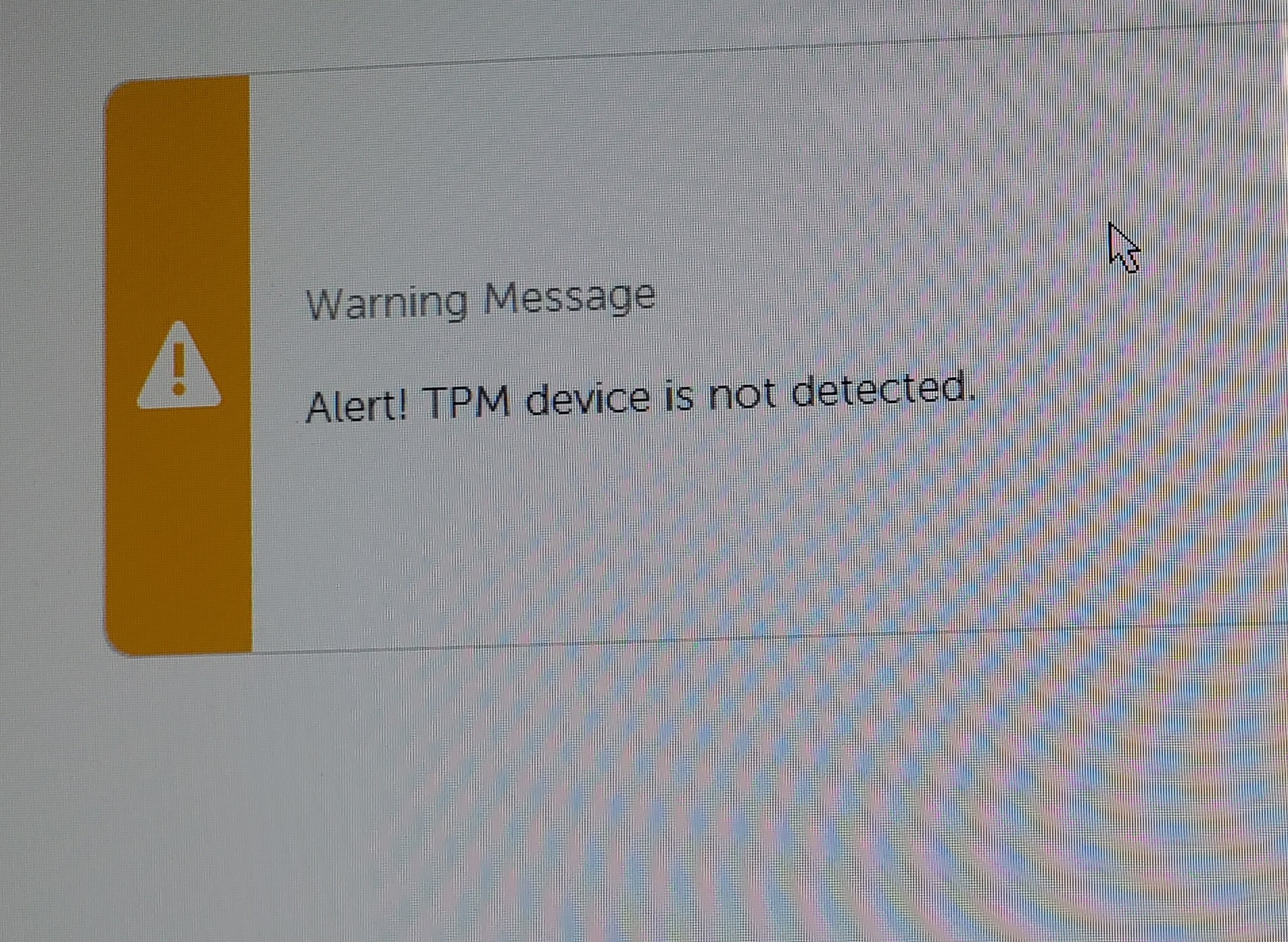

          this one work 100%. the bios at post #1 works but has problem with tpm
          • marek_1980
            • Jul 2015
            • 2
            • poland
            Re: dell inspiron 5490 (24inch)aio working bios 100%
            TPM not detect !
            HD Drive not detect! :-(
              Originally posted by marek_1980
              TPM not detect !
              after uploading this bios
                    both files tested on 7790. tpm error
                    • tugrul63
                      • May 2015
                      • 94
                      • türkiye
                      i tried all them, it gives TPM error
                      • elton_002@
                        • Jul 2021
                        • 4
                        • BRASIL
                          Originally posted by elton_002@outlook.com
                          thanks you.
                          my All in one wouldn't turn on at all, now it's turning on with this BIOS, the SATA port isn't working, I can use the All in one by installing the system on the M.2 SSD, the TPM error message is still appearing, but Even with the error message, the bios allows me to continue and access the operating system, installed on the m.2 SSD, I believe that my all in one has more defects, but the bios I downloaded is perfect, later, I will solve the sata port defect
                              someone fixed the tpm error? I have the same message here, Dell 5490 AIO, i5 10th with nvidia graphics
