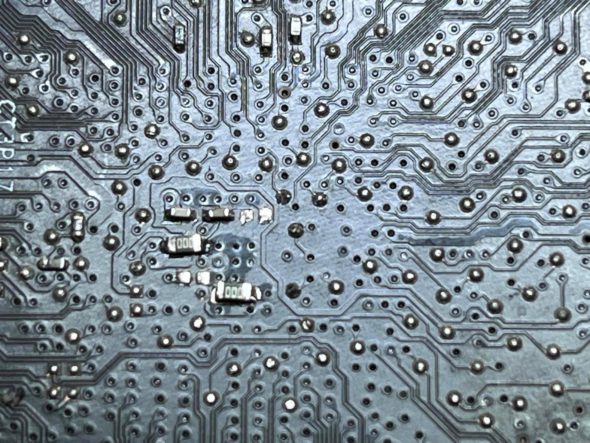

    1st look and test:
    Lots of missing components under PCH + Socket damaged and tracks ...

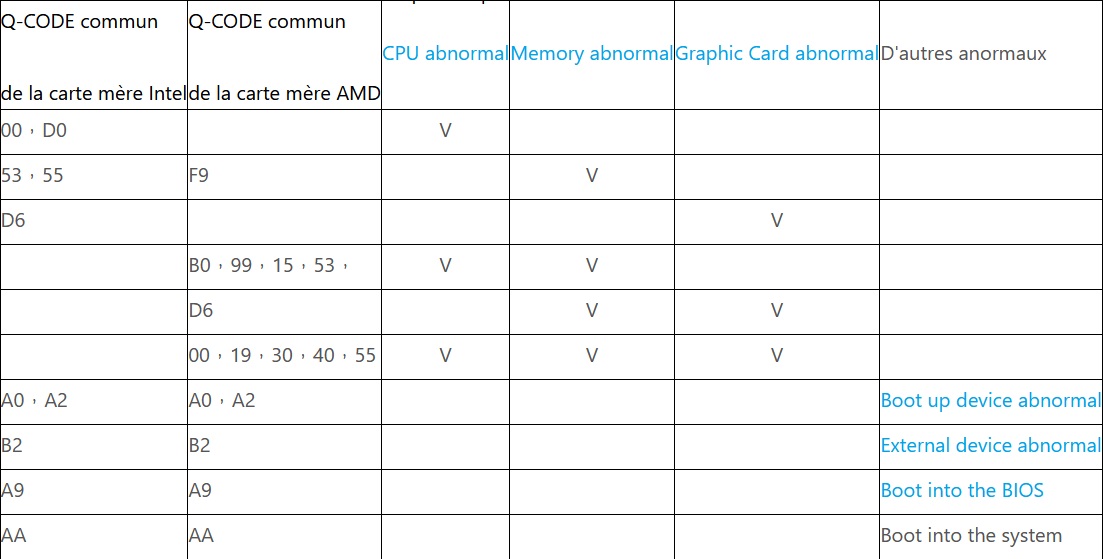

    Lights up, starts but no reaction
    initialization remains at code Q 00
    following :

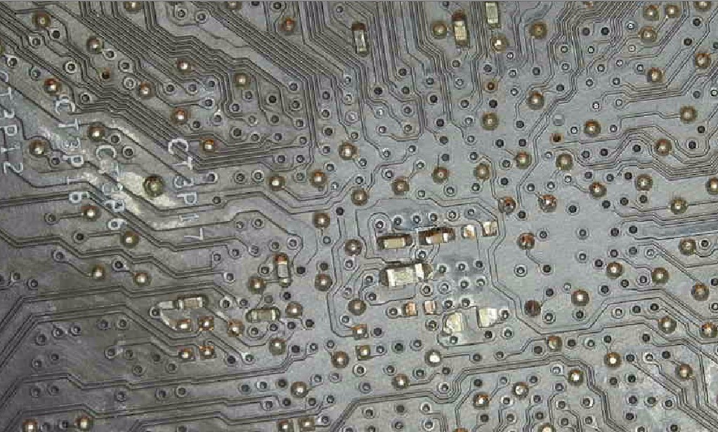

    after inspection and replacement resitor and repair track
    I replace the 0 ohm resistor under PCH and add another 0 ohm. (look pics)

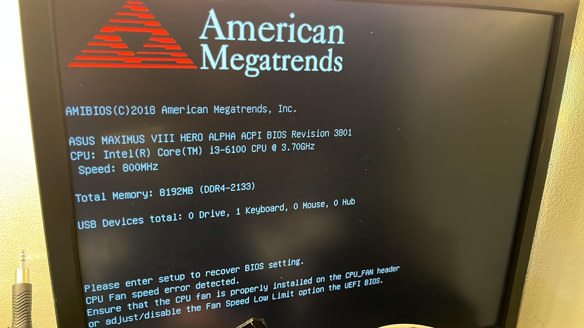

    NOW, motherboard start
    but missing I still think 2 caps under PCH.
    But problems are still present
    1 pin of CPU socket is broken DDI 2 (I believe)
    So no internal HDMI but with graphics cards it's OK
    and many components are still missing somes places

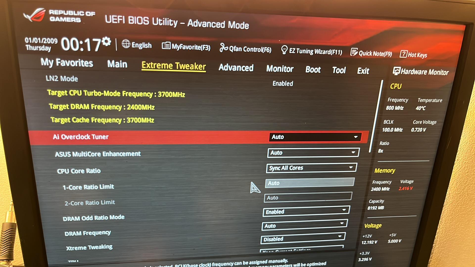

    Another problem, the BIOS indicates DDR Voltage 2.4v but directly on the ram it is 1.2v
    I haven't been able to do a lot of testing so far, I don't have the heatsink

    I don't have access to paid circuit diagrams either.
    My motherboard just randomly stopped working.
    If I short out the 2 PSU connector pins in the pack q code 00 shows up.
    As soon as I let go, everything shuts off.
    I did a visual inspection, nothing seemed off, i dont know what to do, any ideas?
