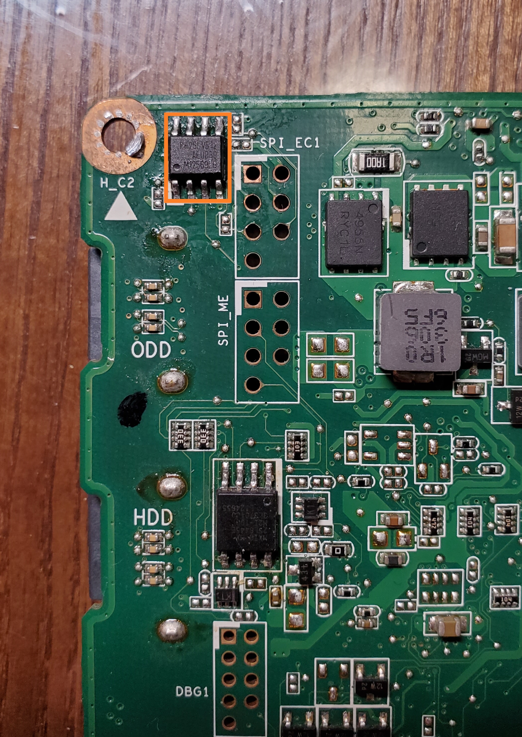

        Re: Asus P1801 all in one bios
        Hi all. I am looking for EC BIOS.
        Motherboard: P1801-AIO-MB REV. 3.1.
        The PC shutted down by itself and after that not turning on. No damaged component or short circuits is observed. The 5V and 3.3V always on are present.
        On the Asus site i found "BIOS 1002" but seems EC part is absent there (I tryed to do a search with keywords of EC chip like "ENE", "KB3926", "KB" but nothing found)
        Also I was tried to read dump by CH341 programmer but unfortunetly it couldn't detect the Pm25LV512 SPI Flash (attached photo). The SPI flash was unsoldered from motherboard and soldred directly to CH341's SO-8 footprint pads.

          Here are SPI flash ME and EEPROM dumps that I was able to read.
