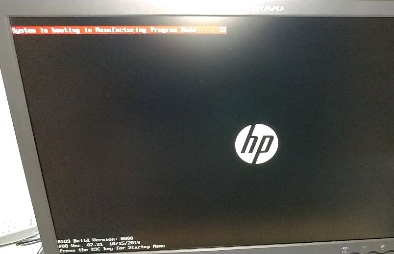

    Good morning everyone
    I know that this is not the correct section to request a dump of a desktop computer, I have not found anything about these computers in the forum. I ask here if it is not annoyance and if anyone, by chance, has a BIOS dump for this HP model.
    Thank you.
    By the way, does anyone have the Phoenix Tools? I had it saved but the HD has broken down and with it I lost the program.
    Thank you in advance to whom or who can give me information.

      Re: BIOS Dump HP Prodesk 400 G4 SFF
      Good day,
      I put here the original factory BIOS of the equipment.
      Link: https://drive.google.com/file/d/1M3Y...ew?usp=sharing
          Good day,
          The board jumps with sound error code 5.2 (the integrated controller cannot find the valid firmware.).
          The integrated controller cannot find the valid firmware.
            Originally posted by Graku
            Good day,
            Ok, try this new bios .
              Thank you, I am going to try. Hopefully it works.
              Thanks again.
                Good day,
                A while ago I tried the new version you provided me. And works!! You just need to configure it internally. If I have any questions, I will tell you.
                Thank you thank you very much.

                          Hola / Hello
                          I have an HP Prodesk 400 G4 computer with this error. I'm familiar with electronics, but I'm not familiar with how to load new firmware onto the motherboard. I'm new to this.
                          Could someone please explain the procedure to me?
                          Thank you.​

                            Originally posted by Lacademia74
                            Hola / Hello
                            Thank you.
                            you need an SPI programmer...here is a video for example..https://www.youtube.com/watch?v=DWWi...nnel=ThisIsHow
                                Thanks! I'll buy a programmer. Is there a specific one that's affordable and can program without removing the motherboard's memory? Best regards.​
