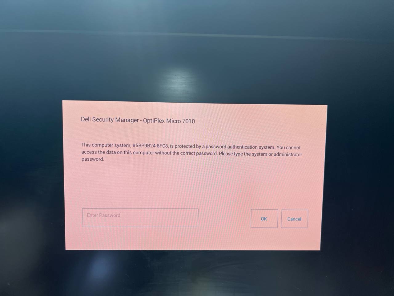

      Hello Friend´s my bios is locked, help me please. Dell Optiplex Micro 7010
      MB: d13_mff_luxor_low 212045-1
      Service Tag: FRJKK24

        try..

          Thanks man, it's working, you're the best

                                Hello Teams my bios is locked, help me please. Dell Optiplex Micro 7010.
                                Service Tag: 274SF14
                                  https://www.badcaps.net/forum/troubl...l-8fc8-patcher
