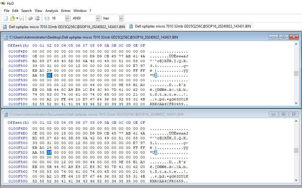

                            • mtherana
                              • Jan 2013
                              • 122
                              • South Africa
                              #74
                              Please find the second Chip attached
                              ST; H9TG8Y3
                                • 22806
                                #75
                                ST; H9TG8Y3
                                Unlocked + absolute disabled.
                                At 1st boot press F2, write service tag, disable Absolute, save (Apply changes), restart. At 2nd boot press Alt+F to exit manufacturing mode
                                Badcaps relies on your donations to pay for hosting , site advertising goes nowhere near to covering these costs. If you have found my reply or post helpful please consider making a donation , thank you.

                                  #76
                                  Hi I flashed the bios with both files however they still seem the same (unmodified) the machine came already with the Service tag programed and Absolute grayed out.
                                  • mtherana
                                    • Jan 2013
                                    • 122
                                    • South Africa
                                    #77
                                    comparing the files I can now see there were some changes but results still the same, also removed the 3v cell, but the same, also not booting in Manufacture programing mode, its booting normal with the service tag already programed on the board.
                                      • 22806
                                      #78
                                      try this bios region
                                      • mtherana
                                        • Jan 2013
                                        • 122
                                        • South Africa
                                        #79
                                        Hi I tried this one and doesn't respond no power light no fan spin, I have checked the 32mb chip a couple of times and its sitting properly. if I restore then the machine works again (In the old state with absolute)
