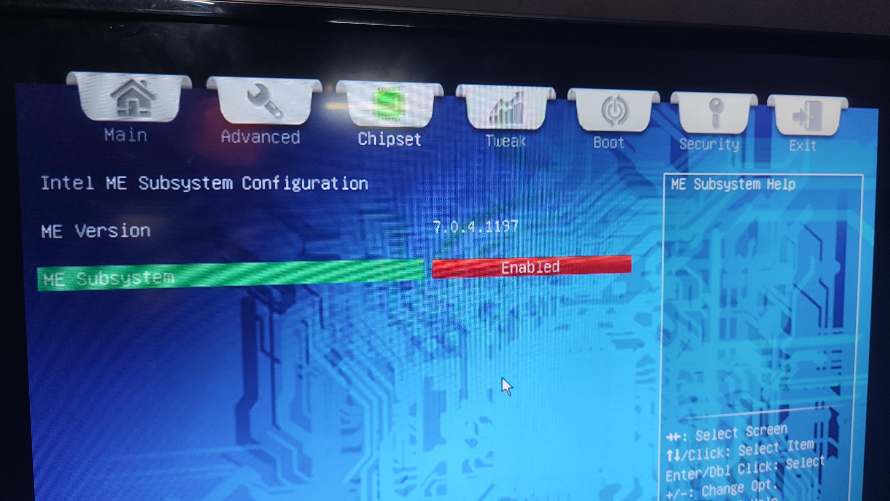

                      So I've little experience updating BIOSes and am trying to update the BIOS on an old ECS H61H2-M2 1.0 motherboard so I can use an i7-3770 CPU with it.
                      Got the latest eBLU BIOS Live Update software but all it does is keep giving me a "connection to ECS server fail" message and won't let me do anything.
                      Have a couple of BIOS BIN files for the motherboard but can't find a way to select them in the eBLU program.
                      How can I install the BIOS update without the eBLU software?
                      Thanks in advance!

                      Go to ECS support - https://www.ecs.com.tw/en/Product/Mo..._V1.0/download ,on the drop down list under Driver / BIOS & Others Download there is BIOS/Image & Manual/EDM at the bottom. Select that and you`ll see 2 bios updates,. Read the Update Description​ carefully about the ME warning and check your ME version before installing any of the bios updates.

                        Hi and thanks SMDflea!
                        Followed the instructions and ran the CPU EVO II for the motherboard to update first (since the board BIOS shows the ME version at 7.0.4.1197). Finished and it updated the BIOS seemingly well, new settings were there and set everything properly, and it rebooted and the Windows 10 SSD that worked before entered automatic repair mode. Walked away for a bit and came back a few minutes later to find the PC had restarted and wouldn't load to bios, with the computer turning off and turning back on every few minutes. Now it just runs continuously after powering on without going to BIOS, and with no keyboard response.
                        Removing the RAM has the computer giving three short POST beeps in sequence, which stopped once put back in. Replaced it with a few other supported DDR3 sticks but it didn't make a difference. Nothing seems to make a difference. Swapped the PSU to no effect. Replaced the CPU (i7-2600) with a few other gen 2 CPUS I have, but nothing changed.
                        Any advice would be greatly appreciated, since I'm at wits end.
                          SMDFlea commented
                          Editing a comment
                          Sorry i didn`t see this post until now. Upating the bios is always risky. I can only suggest that you buy an SPI programmer and flash one of the bios in this thread.
