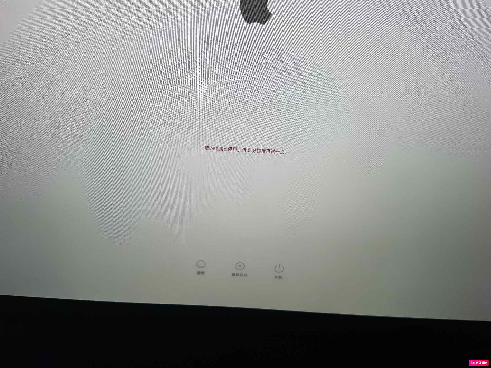

          I have an iMac A1419 EMC2546 with a corrupt bios.
          Dont think the original file is good, as when I zip it has 71 KB
          Can anyone help me getting a working dump for this?
          Right now the machine turns on first led steady green. then turns on 2nd and 3rd led for half a second and comes back to first led only.
          Repeats this like in 5 secs intervals.
          Thanks for any help!

              before seeing the post I managed to get the iMac booting with the one in attachment.
              But I get chinese language and apparently its locked (cant understant what it says )
              Can someone help me getting a working dump and if possible in english?
              Thanks!

                Re: Imac 27" a1419 emc 2546 bios bin
                It says "Your computer has been disabled, Please try again in 5 minutes"
                  Did you try to boot with "ALT" pressed when power on?
                  if it has No EFi Lock when in Boot menu then you just have to "fresh" install OS via bootable media.
