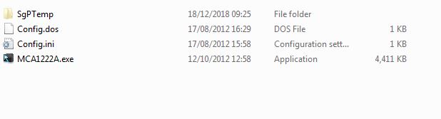

    Hi there, maybe somebody has a desktop board ECS H61H2-M version 1.0 bios dump. Sorry for posting in laptop bios req section, couldn't find desktop req section.

    Download the bios from the ECS site:
    http://www.ecs.com.tw/ECSWebSite/Pro...5-LL-Intel-RR-
    Next, set your folder options to show Hidden Files and Folders (if using windows) .
    Run the bios installer ,and in the same folder where you run the exe from, a new folder will appear called SgPTemp ,inside that folder is the full bios .

      Thank you, tried it, have the bios dump now. Well mainboard acts the same as before, some fan spin and turns off, might be that the kbc dump gone bad or something else. Thank you for the tip, I tried it before, but dind't go far enough with the bios update, just need to get an error message and the bios dump file will be in that folder.

          I guess bios should be good now, but board is still acting the same as it was before, changed the bios ic and used your bios, still does the same, tried it with original bios ic - still the same. Might be something else that failed. Thank you for your help mate.
