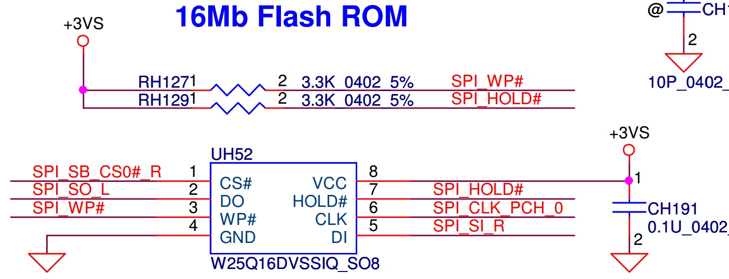

          Ok i program the chip but now i have a problem.
          I attached the picture to help you to give me a solution to fix them!
          how can I repair the slopes jump??
          Thanks in advance

            Please HELP ME, only way is find a schematics of motherboard desktop?
            I found this target on mainboard maybe is del part number:
            AS#782450-001 REV 0D

              Re: Bios hp 280g1 mt
              Thanks in advance
              here,

                Hi Rioreno Thanks to Reply.
                Ho i can fix the tracks? With i Wired? How Tool i need to fix them? and HOW i Scratch the Tracks to see the copper for solder?
                Thanks in advance

                  yes using wire to jumper,
                  to scratch use excato knife\cutter to remove coating..

                    if the tracks is broken and not recoverable, the unic solution is find the schematics of the mainboard and find the pin in my case 5,6,7 where goes to to create a bridge with a wire.
                    How can i find the schematics of my mainboard?

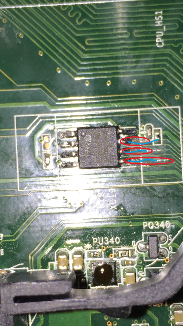

                      I solder the chip again but unforunally the pc is poweron the fan is worling but the monitor still black.
                      I don't now if because i solder bad the chip or because the file fixed1 is bad, anywal during solder micro caps or resistance i dont'now is dissolder, then i solder again how i could.
                      I attached a photo so as you can see if something wrong to solder, i make a circle blu around the component unsoldered.
                      You think is a lost case? or it's possible to try something to fix?
                      Thanks in advance for support
