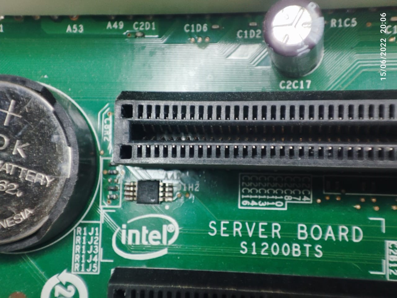

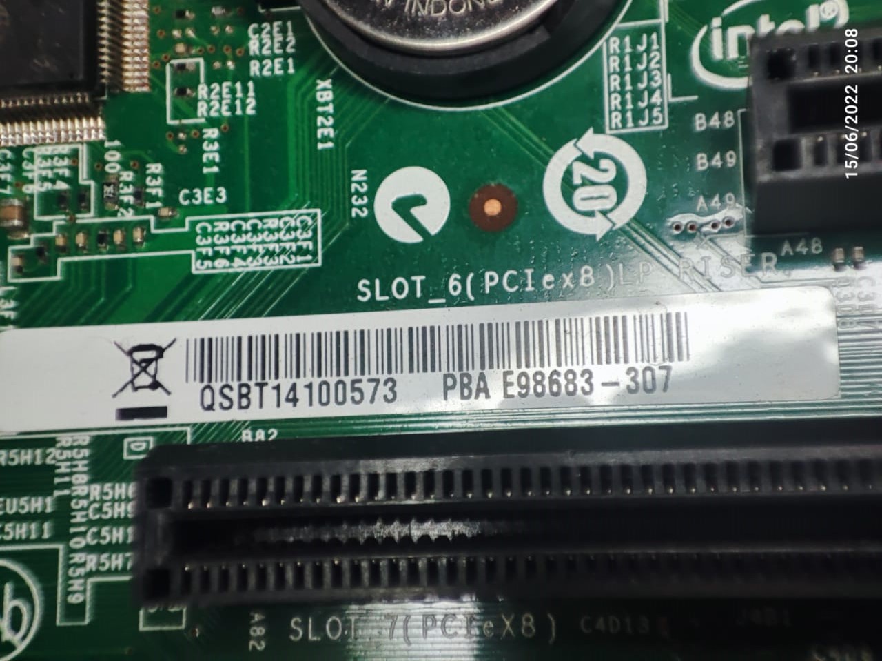

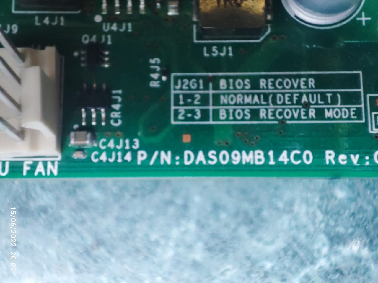

                  Re: intel server board S1200BTS bios dump required
                  bios corrupted during updation
                  INTEL SERVER BOARD S1200BTS
                  PN DAS09MB14C0 REV C
                  corrupt 8mb 16 pin bios attached here
                  Thanks in advance

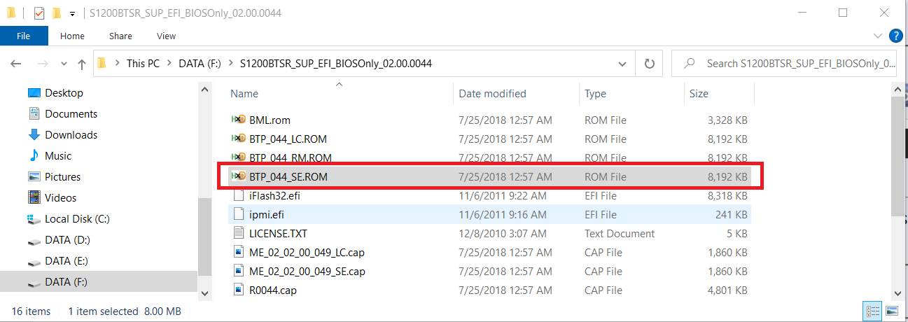

                    If anyone does not have bios for this board or the corrupted bios cannot be repaired then please somebody let me extract the bin file from the intel site bios
                    • hoaca388
                      Badcaps
                      • Jan 2022
                      • 11773
                      I think you need 044_SE.ROM
                      • OKRPKCOMP
                        • Dec 2020
                        • 429
                        • PAKISTAN
                        U r partilly rite bcz from 044_SE.ROM display comes out from external vga-card, not from internal vga port. and and when it come out from inter vga port then there is too much detortion. Also it not turning on every time. and also missing sometimes first display
                        Any more suggession???
