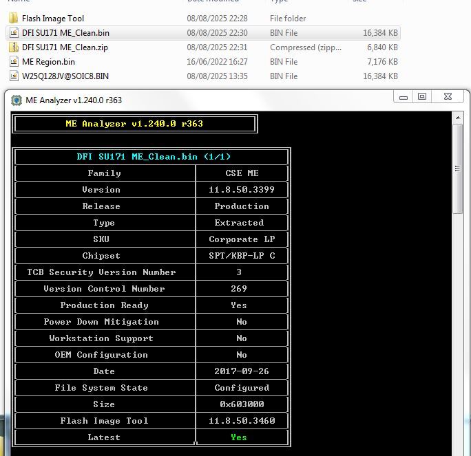

    Hi!
    Brought in for repair DFI SU171 board
    She doesn't start.
    Someone has already tried to repair it.
    Apart from drivers and instructions, there is nothing for this board.
    I read the BIOS chip firmware and I think the firmware has an error.
    Here is the error that MeAnalyser gave
    Intel Me Tools 11.8 read the firmware and did not return any errors.
    Can someone help determine if there are errors inside the dump?

    Try the attached bios.

      Have you added a newer version of ME region?

        It is the same version, configured and clean.

          Thank you!
          There is no start yet.
          We are trying to replace the processor with a working one from the donor board.

            Tell me, can I somehow find another copy of the BIOS for this board?
            There is a topic in a parallel thread.
            It contains links to files, but they are not currently available for download.
            We replaced the processor, but the board does not start.
            The video core phase does not turn on.

              The files in the other topic are no longer available due to a server problem. DFI support might send a bios if you are lucky https://www.dfi.com/contact/support
