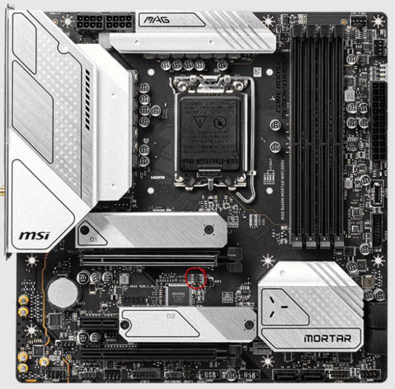

    Hi all I hope im doing this correctly,
    I need a firmware dump for the Nuvoton NCT6687D‑M controller (EC flash chip: W25X20CLNIG) used on the MSI B660M Mortar DDR4 (MS‑7D42, revision 1.1).
    I acquired a ch341a black to reflash my bios, and was so excited to use it that I tested it on the W25X20CLNIG 3.3v chip as I didn't have the 1.8v yet for the bios chip itself.
    Being a total newbie I straight up corrupted the EC flash chip, and now the power button does nothing, PS_ON# does not change, and when I manually short the PS_ON# pin it immediately turns off when I stop shorting.
    The chip still works, after trimming the cheap soic8 clip I now have a reliable connection.
    If anyone has a working dump from the same board, I would be very thankful.
  • mizuh0
    • Jul 2025
    • 7
    • singapore
    opps i meant MSI B660M Mortar wifi DDR4, but i think that the non wifi one works too.
    • noname2024
      • Aug 2024
      • 294
      • CỎ MỸ XỊN
      MAG B660M MORTAR DDR4
      U30
      • mizuh0
        • Jul 2025
        • 7
        • singapore
        thank you noname2024 for the u30 chip firmware, my front panel headers now work after shorting the controller pins as i think the controller was in a semi bricked state.
        im now trying to fix the msi ez led debug light where it is showing yellow despite me having a ram stick
        could it be a bios issue as i flashed a clean msi bios with no dmi information?
        • noname2024
          • Aug 2024
          • 294
          • CỎ MỸ XỊN
          Bios msi you can get it from homepage msi
            • 31249
            pretty sure you need a matching pair of ram.
            not a single stick.
            • mizuh0
              • Jul 2025
              • 7
              • singapore
              Oh nice I got it working with a new ram kit I got, but I am still plagued with sudden shut downs I had gotten before I corrupted my bios and ec.
              It reports 0 degree for system temp and some of the reported voltages are bogus readings but these shouldn't be the cause of the random shutdowns because i already had them before.
              Somethings gotta be weird with the ec controller or pch or even the cpu lol.
              any idea on how to pinpoint this random power off issue
