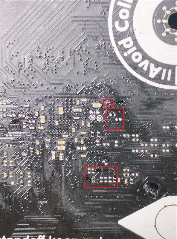

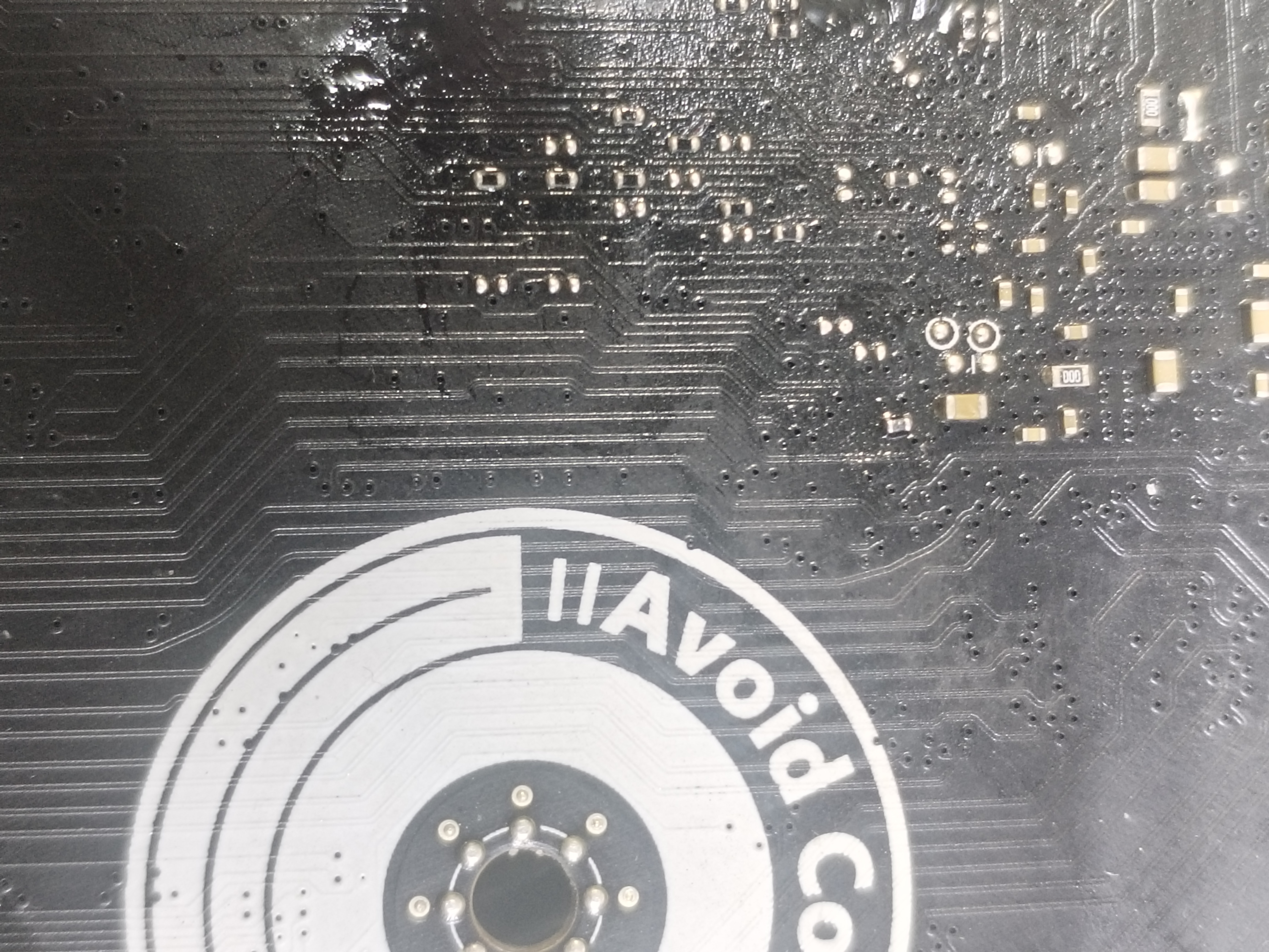

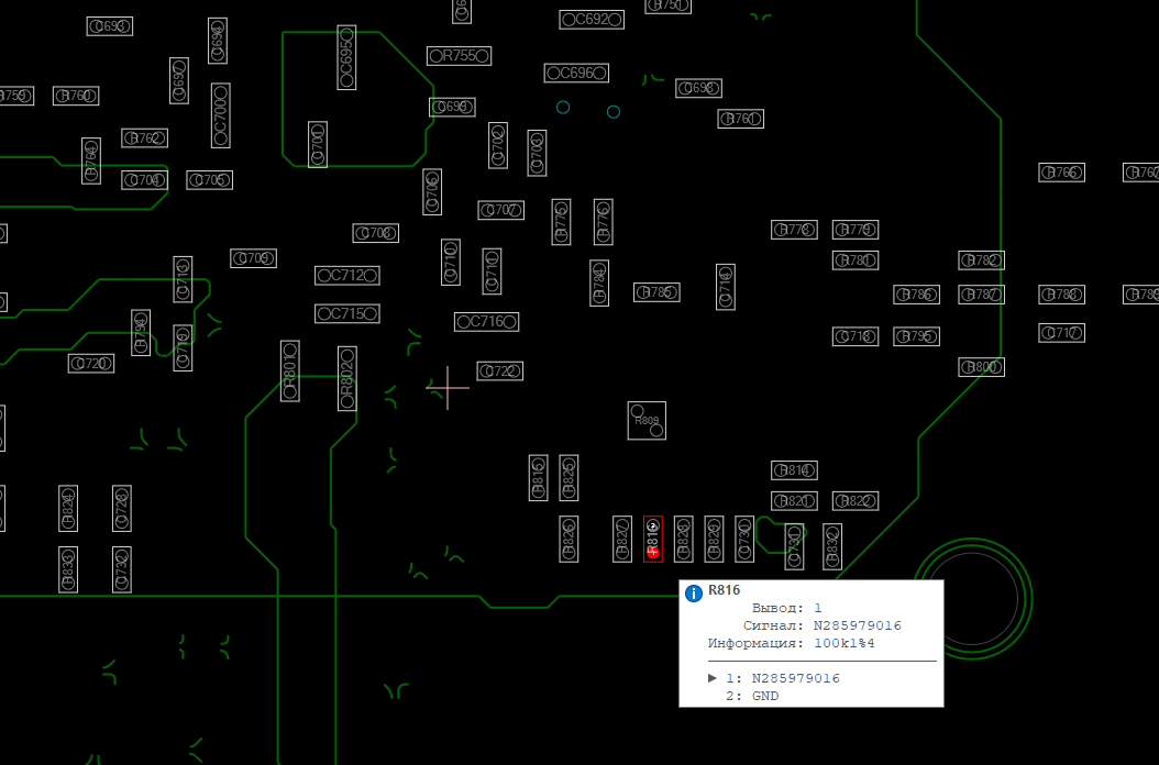

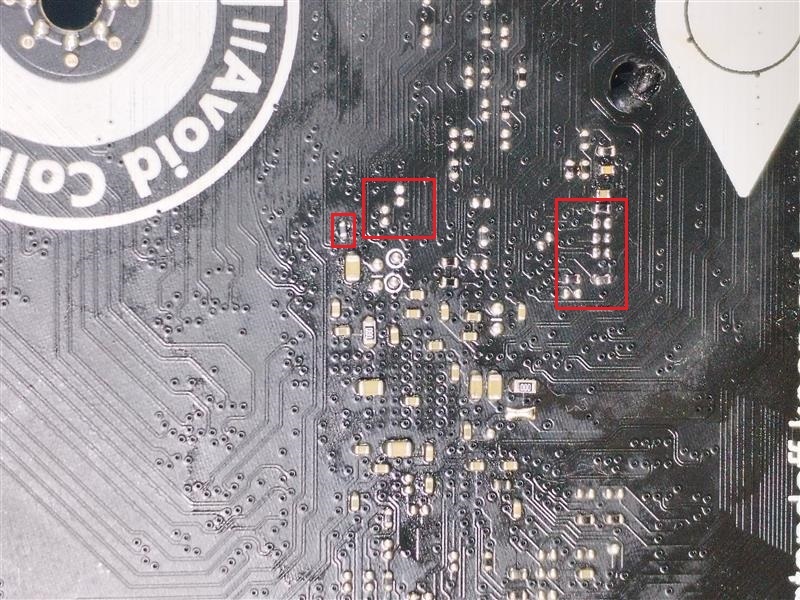

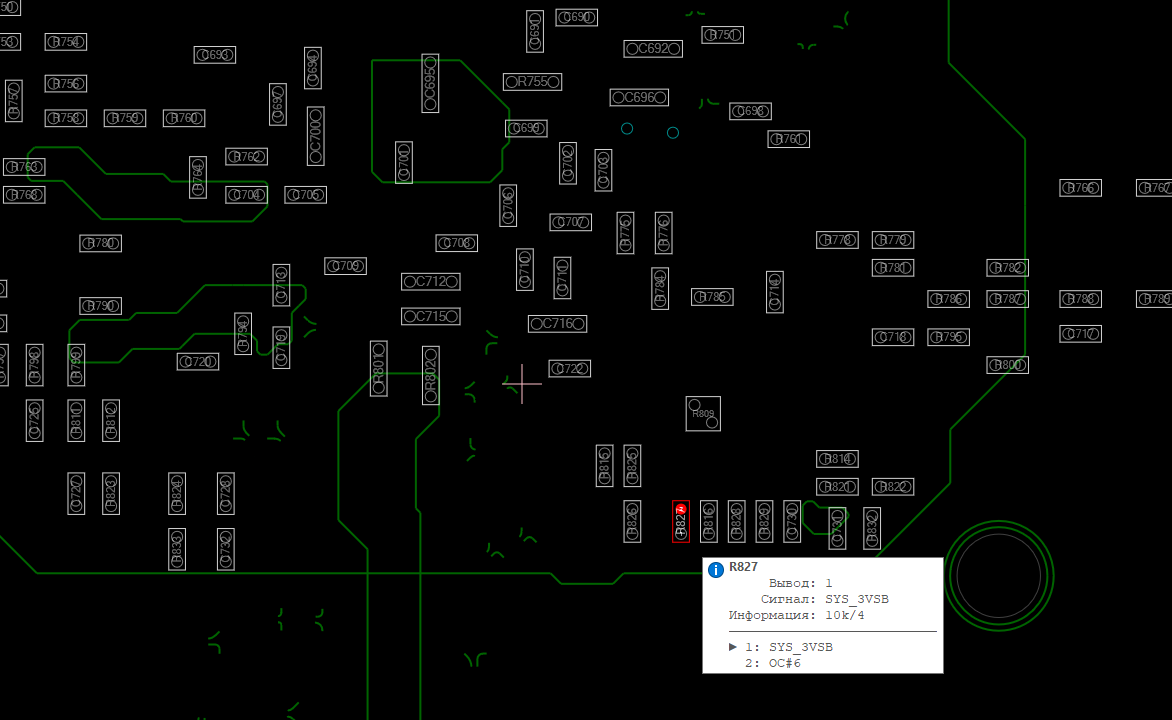

HI! I need boardview for MSI PRO B660M-P DDR4 because some components on the back side are missing(resistors). the motherboard just stop on BOOT light.
Boardview for PRO B660M-P DDR4
