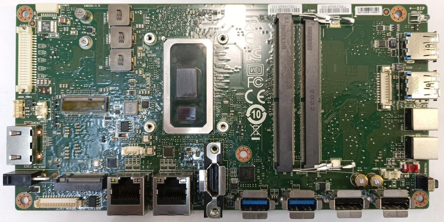

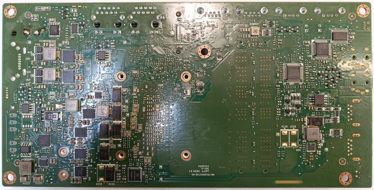

    Hello Everyone. I need bios file. Please help.
    Model: MSI Pro 24X 10M
    Motherboard: MS-AEC21 Rev 1.0
    CPU: Intel Pentium 6405u
    Bios chip: (MX25L12872F)
    Problems- turn on power only got screen backlight on few second will auto off/on repeat issue. no display input.
    my english is not good hope can understand. πŸ™ Thanks

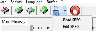

                  also i want know if using NeoProgrammer flash need to set Unprotect and SREG ?

                      • 21843
                      Originally posted by foo007
                      have try still not working... 😐 no display input
                      No, don`t mess with any settings,leave it as is,it should program without any problems.

                          my CPU: Intel Pentium 6405u
                          Nuvoton NCT5567D-M
                          OMG.. because of last time my friend help me to flash bios have Accidentally press unprotect already... So what can i do now Need to edit SREG ?
