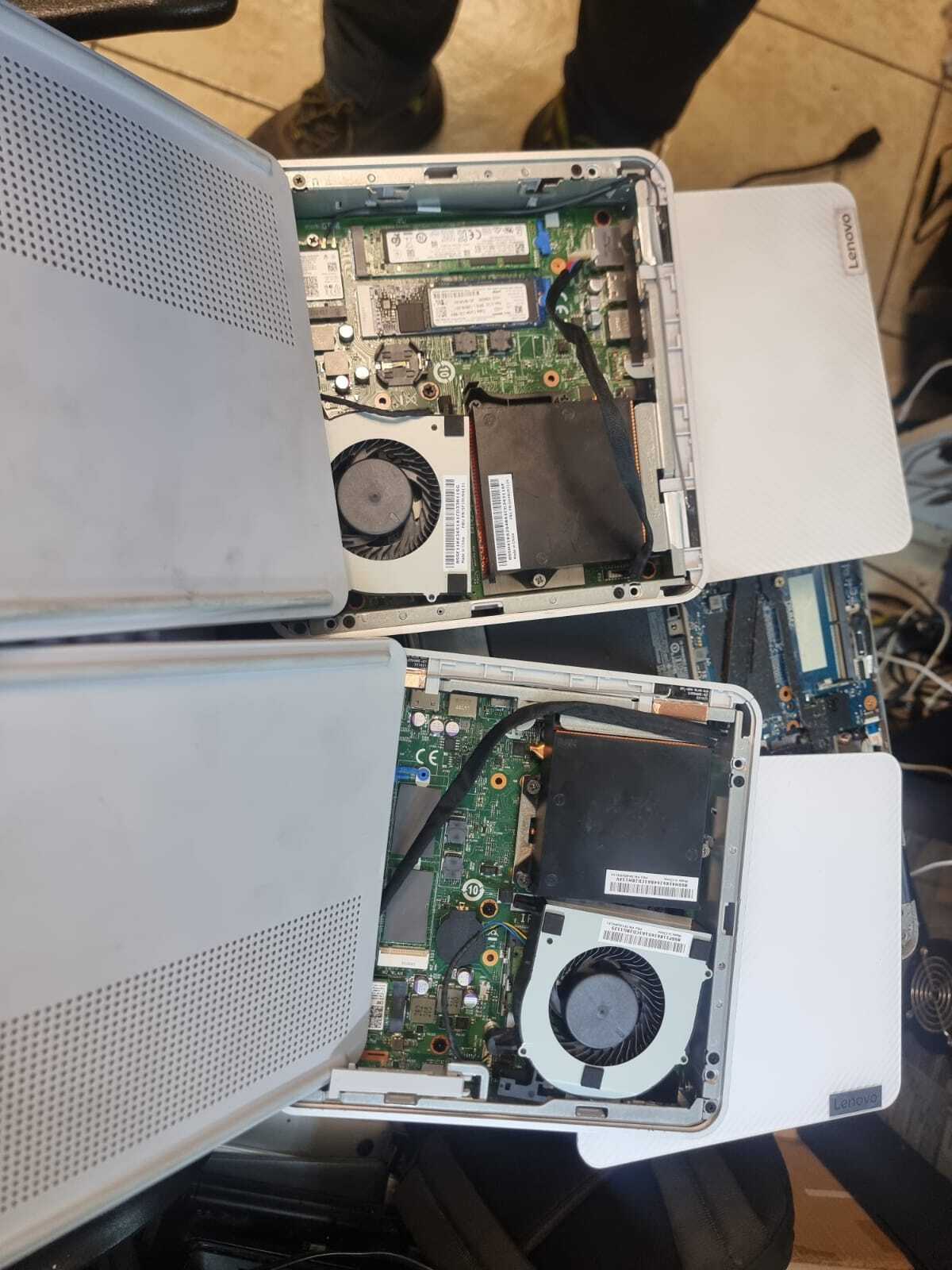

      thanks for your reply,both machine has no label ,stickers or whatsoever taht shows serial number,the data that i got is from the bios settings information ,seems that both machines are from production or some type of demo units
      i upload a picture of both machines withb their covers ,it is something that we can do?

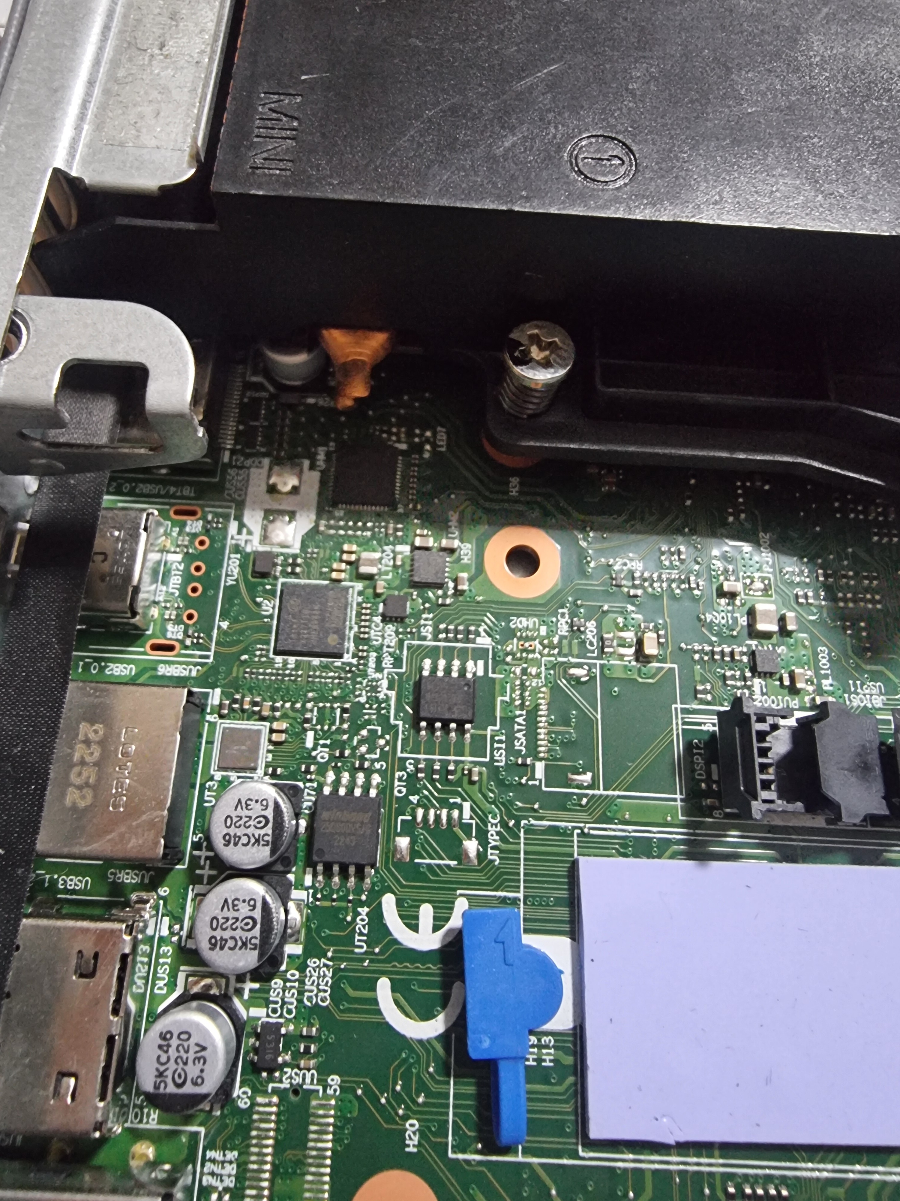

        under fan are some stickers, near RAM slots

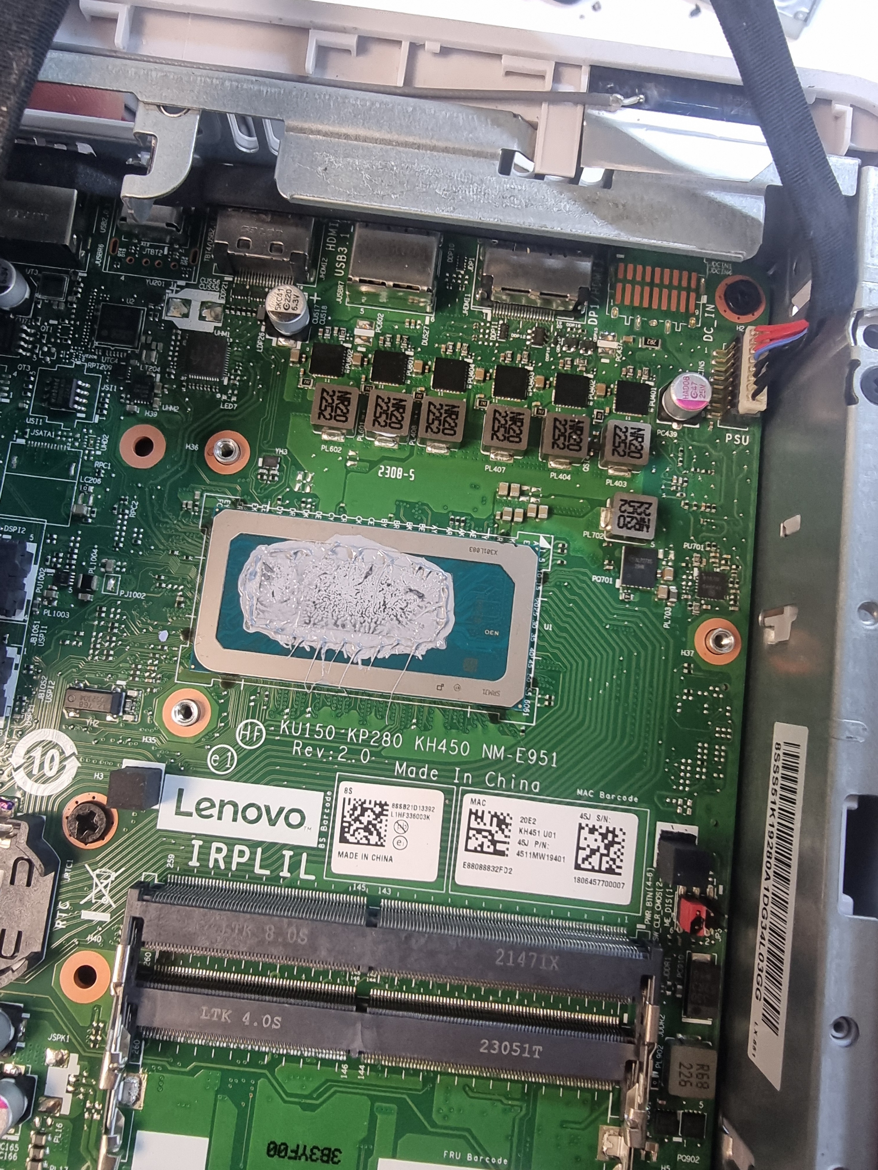

          Hi hera are the pictures ,ive check it but seems to be some kind of part number any other information you may need ,let me know ,
          thank you for your time

            IdeaCentre Mini 01IRH8
