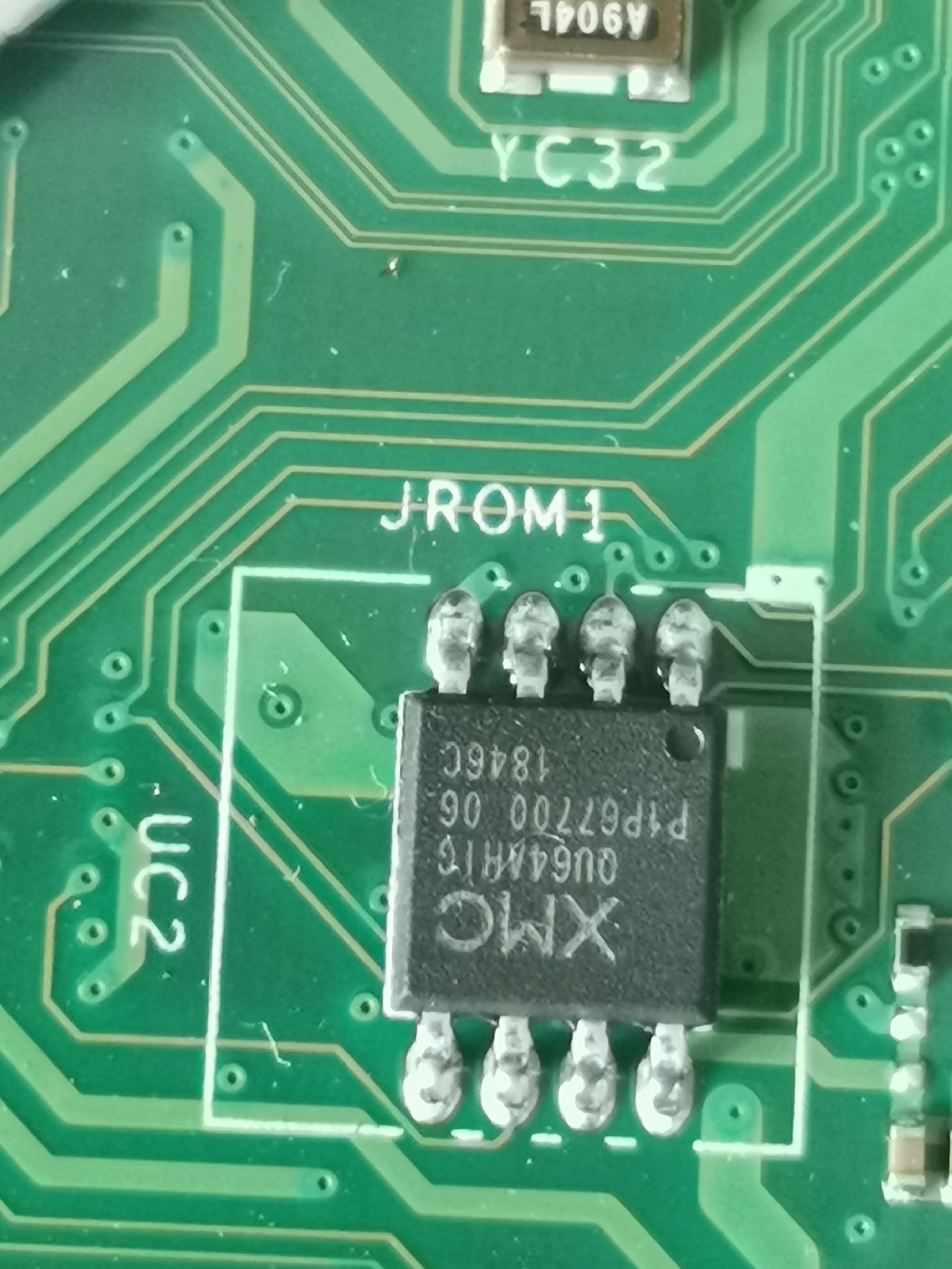

    Good evening, i have a huge problem. I think i bricked my AIO.During windows updates and thanks to lenovo onboard program bios update my power went down. Now i have no display.
    After i conect my CH341 it shows that it is XM25QU64A.I`ll attach bios chip photo and backup of the "damaged" bios. I would be really grateful if someone could help me <3

    can you send me motherboard Number?

      Of course. Thank You for the reply.
      EOC41 LA-H672P
      Rev:1.0
      2019-03-27
      I have to add that i extracted "rom" file from bios update provided by lenovo on their website:

        And this "rom" still doesnt work. I still get no display at all.
