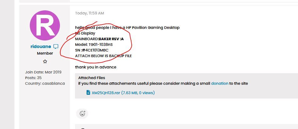

      hello good people i have a HP Pavilion Gaming Desktop
      No Display
      MAINBOARD:BAKER REV :A
      Model: TG01-1038nS
      SN :#4CE1013MBC
      ATTACH BELOW IS BACKUP FILE
      thank you in advance​

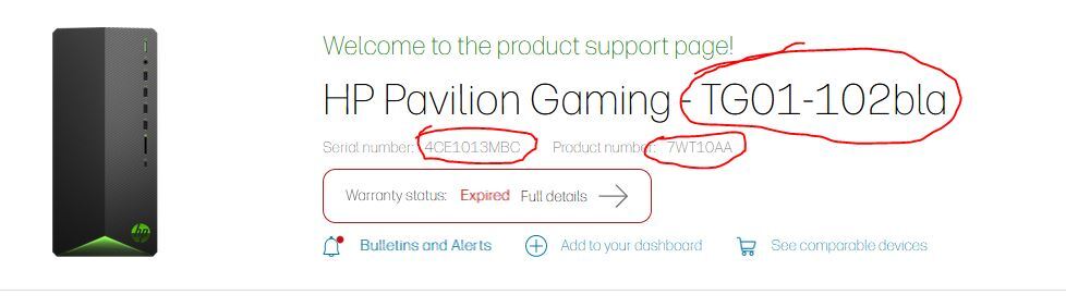

        The thread topic is for the TG01-1038ns you posted the model number as TG01-1038nS in your thread title, which is why i merged your thread with this one.
        The serial number you posted is for a different model - TG01-102bla .Which is right ?

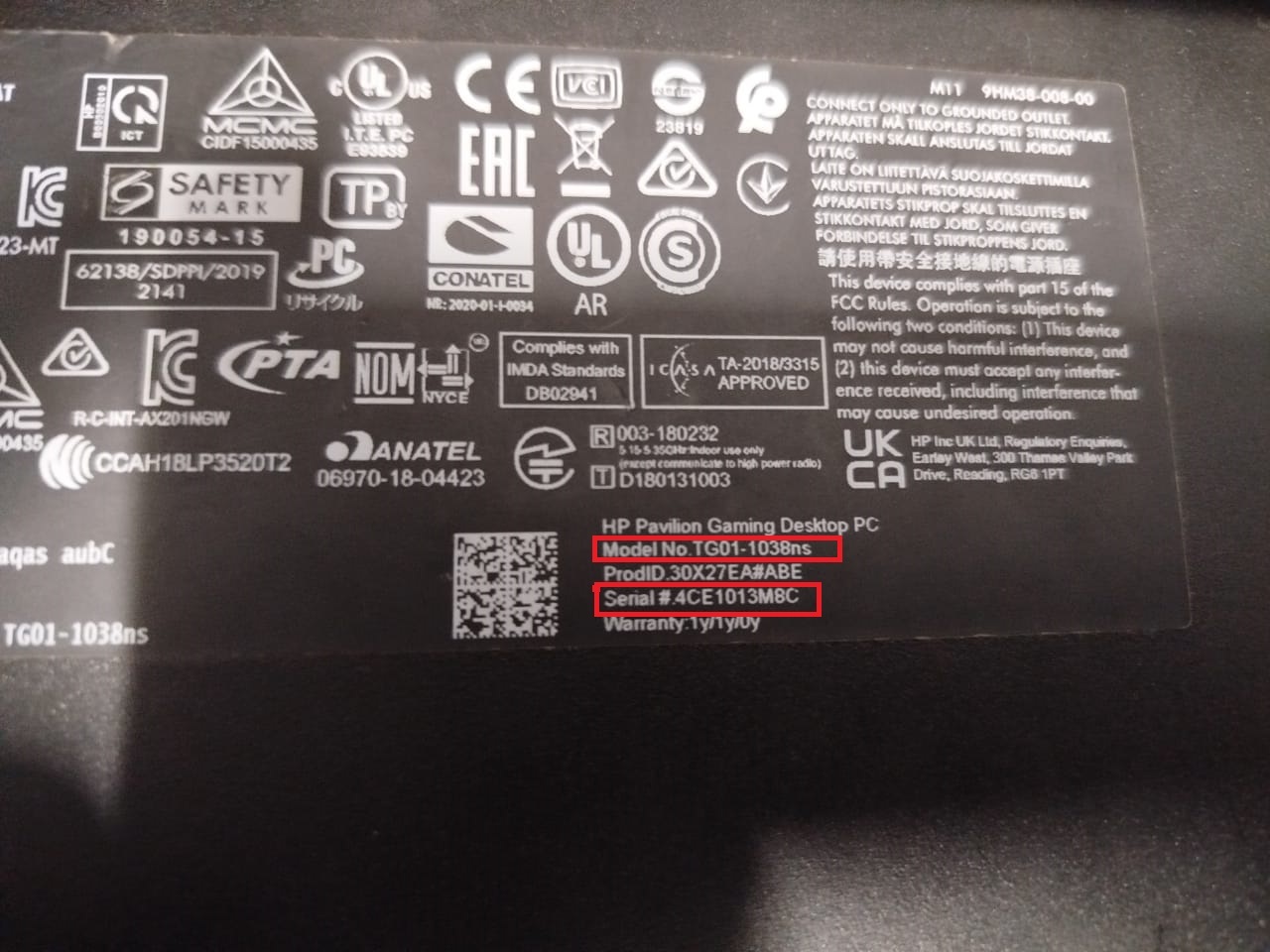

          Hello Mr. SMDFlea:
          The nameplate of the desktop PC reads :
            • 22293
            Originally posted by ridouane
            Hello Mr. SMDFlea:
            The serial number is 4CE1013M8C .Try the bios at post 2 ,it`s the same BID 08767.
