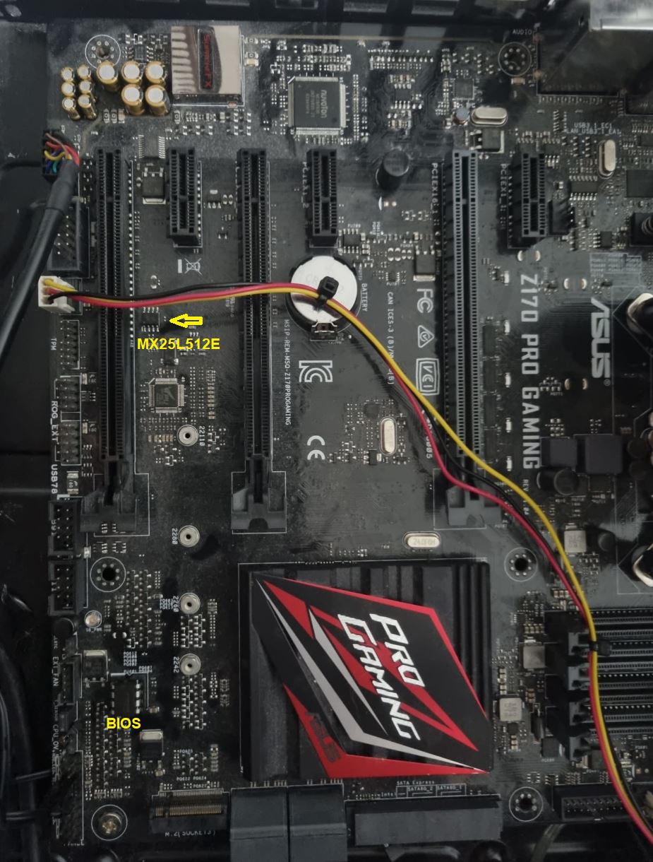

    I've had something similar with Z170 Pro Gaming. One morning, it wasn't booting. I replaced battery CR2032 then it boot once, I could access BIOS and that was the last time after I restarted it never boot again. I didn't change anything from BIOS. I've tried with no RAM with another CPU... real headache.
    Now when I press power button, fan spins for 2 secs then stop... again spin 2 secs and stop and it will repeat this sequence forever. Asus support said I should buy a new one.... I've reflash Z170 PRO GAMING BIOS 3805 with my programmer but still same.
    Looking at my Z170 Pro Gaming, I've identifed MX25L512. i've read it using SOIC 8 PIN connected to EEPROM prgrammer and I get a 64K file. I've attached BIOS and TPU. Now I need to figure it out.

      Thank you but I have the BIN file however I don't know how to get the TPU.
        • 20848
        Re: Asus Z170 bios and TPU request
        Ive extracted the TPU FW from the bios at post #2 and its exactly the same as your backup.

          Hi, how could you extract the TPU FW?
          I dumped the contents of a TPU chip, i de-CAPped all the bios versions, but i cant find the first row of the TPU fw in any the BIOS files, using HxD. (I expect that i have mismatching TPU flash and BIOS flash chips on the board!)

            samstown​ if you still in the need...
            Im stupid, it was easier to just pull both from the working board.
            Bios version 3805 and its TPM flash. Both pulled from a working board.
