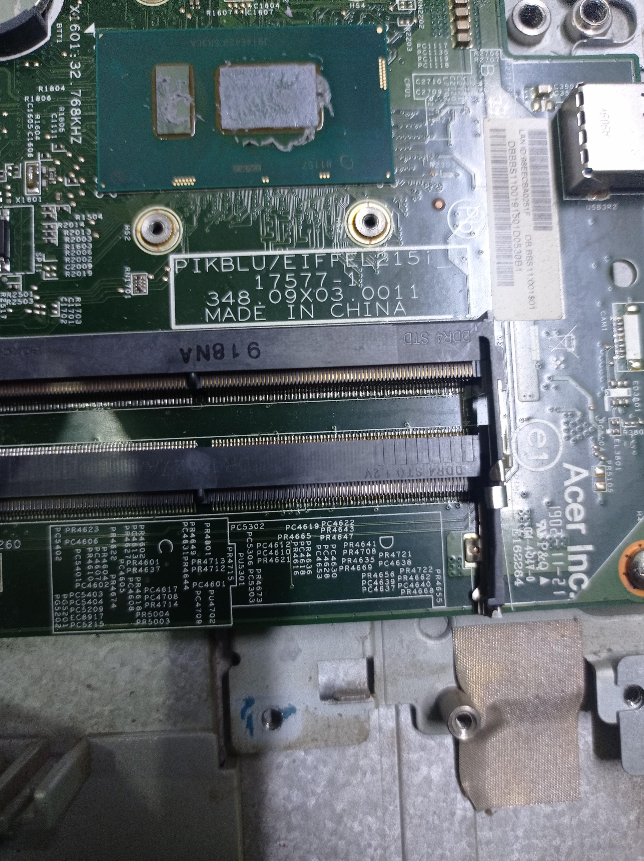

    Re: Help..need bios acer C22-865
    Board number photo?
    File problem? No disply or laptop off?
      thank u for reply...problem laptop on but no display.

        Re: ACER ASPIRE C22-865 bios
        please clean me this bios.
        power on but no screen. Average consumption 430mA
        sometimes it starts
        motherboard:PIKBLUE/EIFFEL 215i_R
        some time 650mA a normal mode 1.25A
          sometimes it starts
          Can someone correct this bios. I don't know if the bios is the problem, according to the symptoms it seems the bios is corrupt.
          All sources are on, except for the GPU.
          I tried with several utilities, me inject, fit, uefi tool, but maybe I made a mistake somewhere. Thank you
          11.8.50.3460_CON_LP_C_NPDM_PRD_RGN
          According to Me analyzer, this is the right me
            I want to try
            before cpu replacement.
            i7-8650U SR3L8
            it's more easier
              try..
                thank you , tomorrow will be the first thing I have to do
                yesterday I made a small donation, the forum must go on
                  it doesn't work, probably faulty cpu
