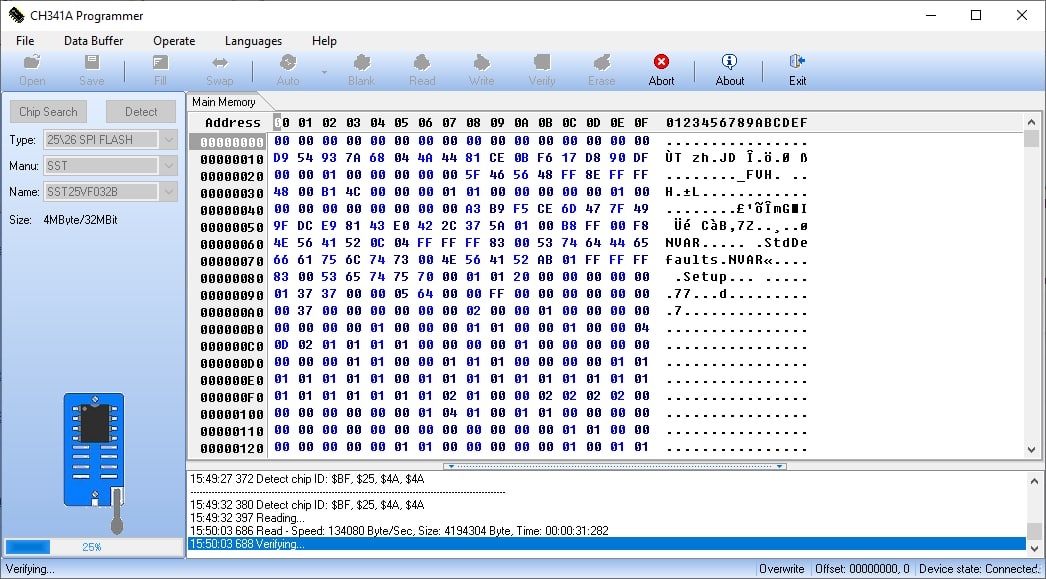

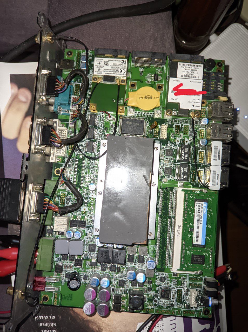

    Hi
    I have VBOX-3200 mini pc and bios supervisor password set by manufacturer and only knows by service stations.
    I need to clear the bios password (or maybe hash for bruteforce) for everyone who uses it, not just me.
    Bios Information:
    Ami Aptio 4
    SORRY MY BAD ENGLİSH Sad AND THANKS FOR YOUR EFFORTS.

    Try this Password: 111871

      Thank you worked. Can u teach me ?. I tried open dump with HxD and search AMITSESetup but i saw encrypted some thinks.

        You can use this tool, it works in a lot of time. Otherwise you should Decrypt the password manually.
        https://www.badcaps.net/forum/showpo...0&postcount=20

          Thank you bro again. i learned something new.
