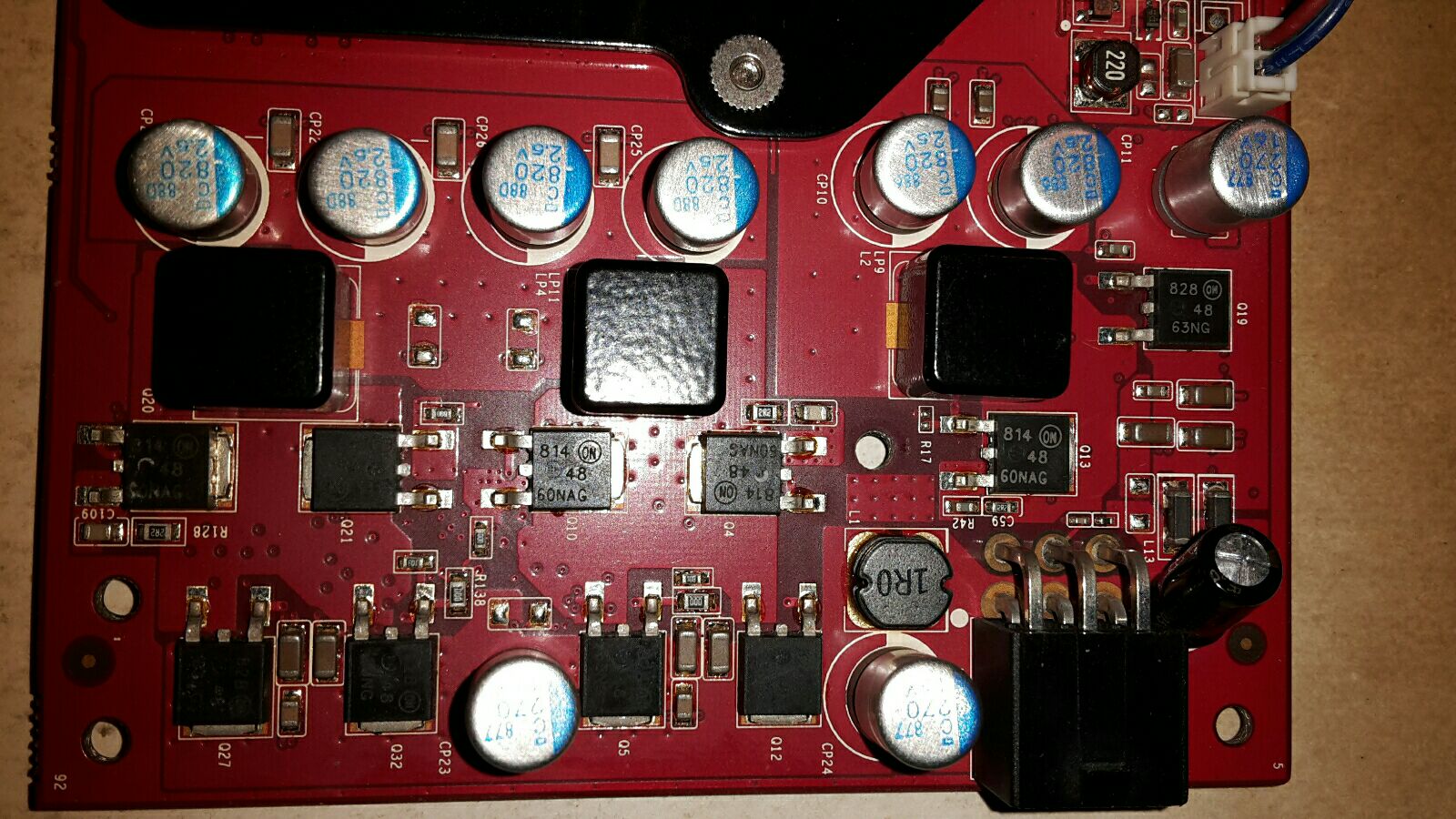

    Old GAINWARD XNE/9800TXT352 shut off quickly

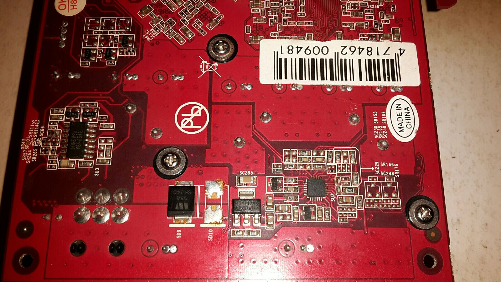

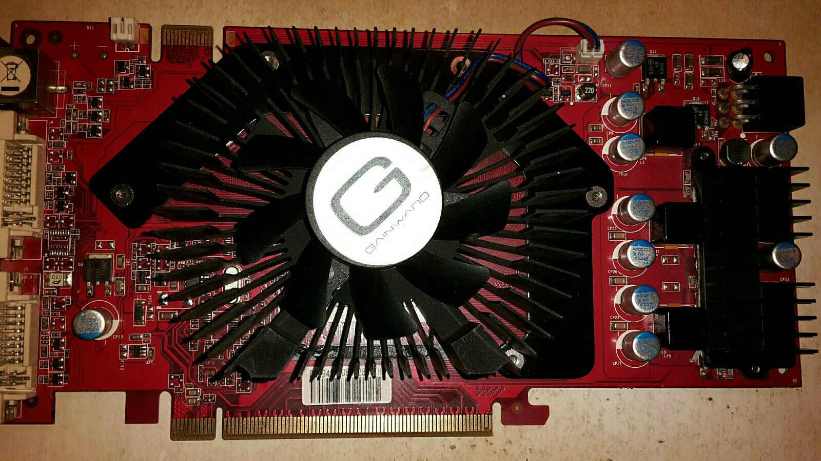

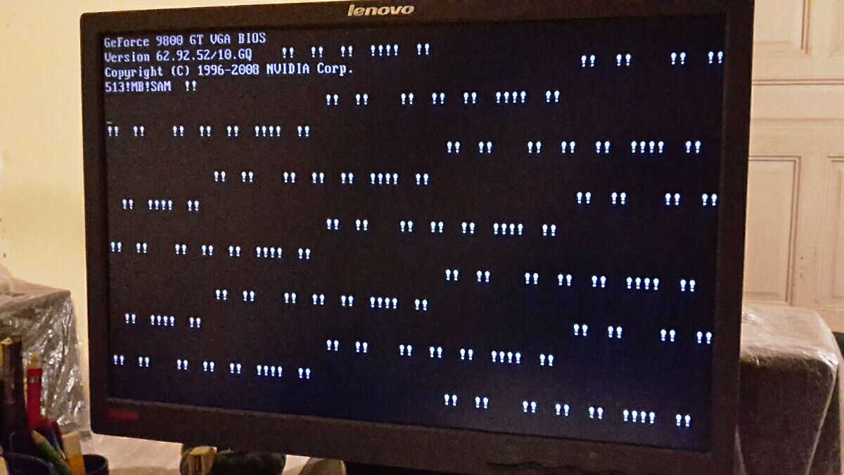

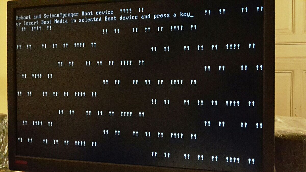

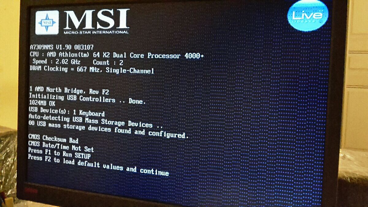

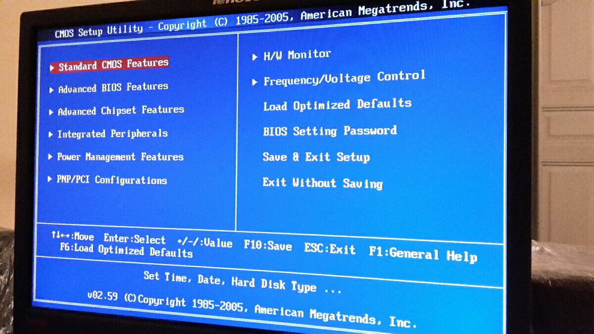

    So, boot screen is messy, and in bios is ok...

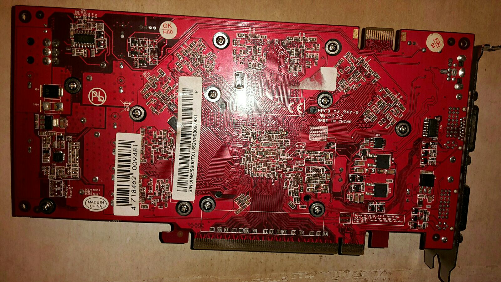

    The big cube inductor and Q13 after few seconds go insane hot (over 100 C for shure), and hold 2.15V. Resistance to ground is 53R. After about half minute spend in bios, it shows black screen (like cutoff, not reboot). When I try again after cooldown the same thing happen. The gpu and their 2 coil is not hot, its warm that I can put easily finger on it.
    I replaced failing cap right on picture.
    I am interesting to know why is this inductor so hot, is voltage and resistance ok, and how to aproach to investigation of black screen.
    This is for education, to learn one thing more
