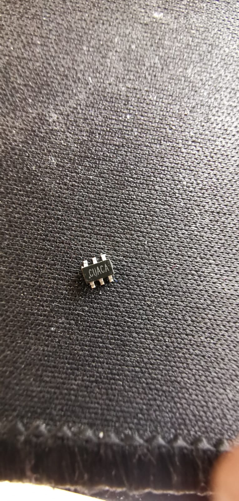

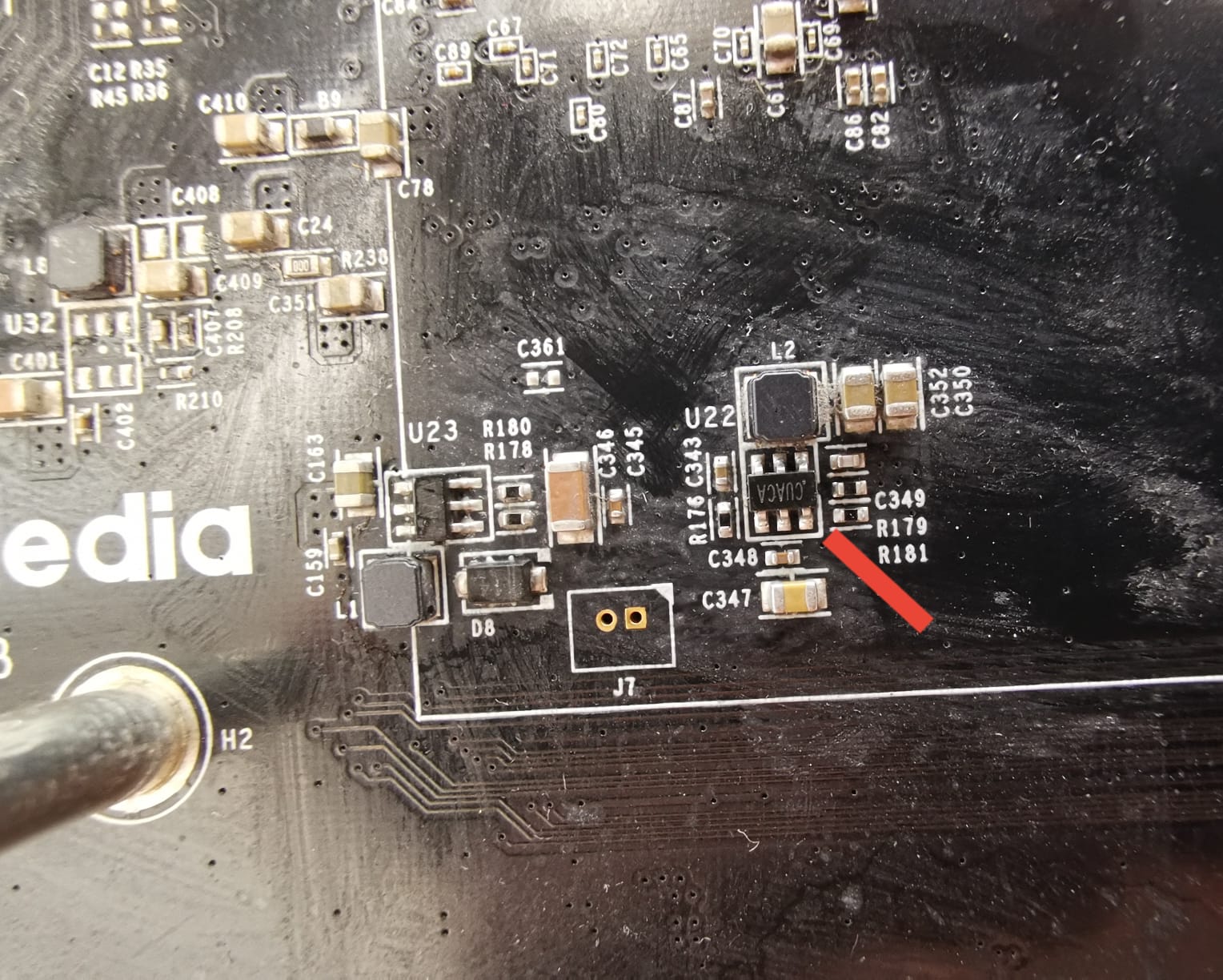

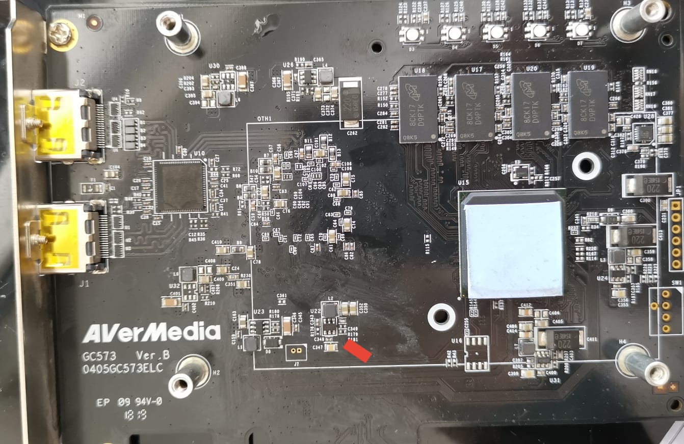

I need help identifying a component.
I attach a photo.

It should be a Silergy SY8009BABC
Silergy-Corp-SY8009BABC_C79314.pdf

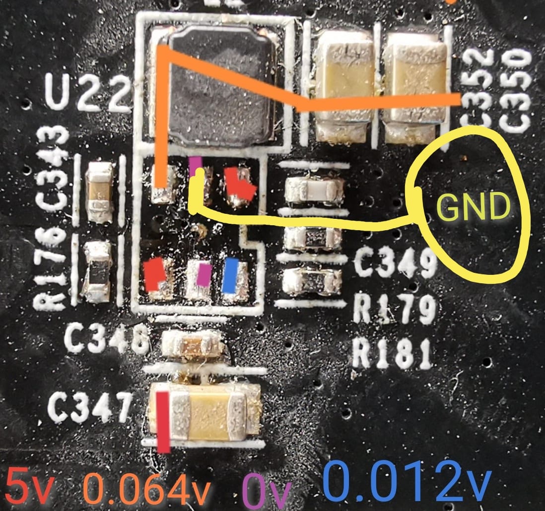

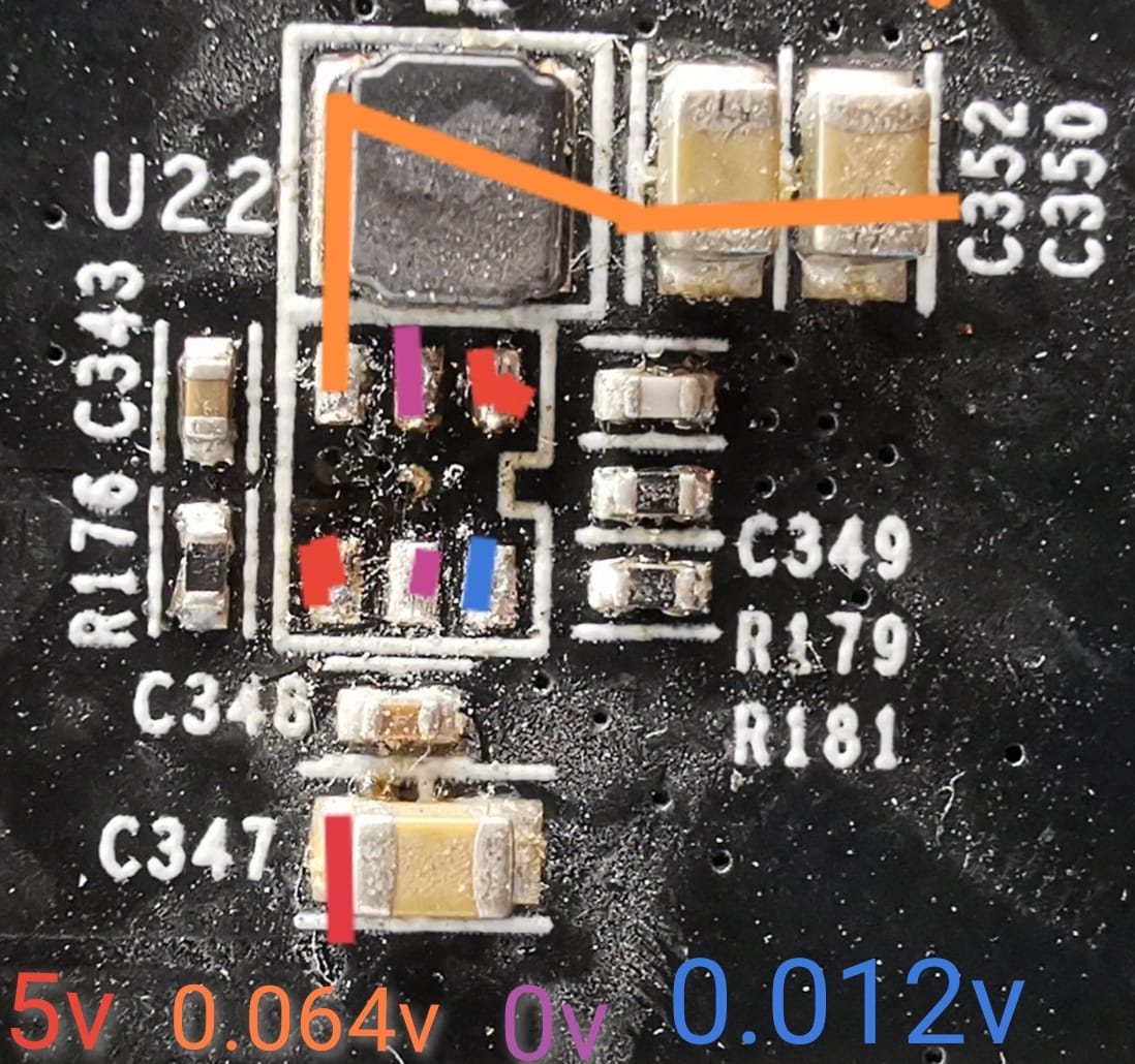

thank you very much for your help, i have some voltage data that may help confirm that it is the correct part (attached photo).
I reviewed the data sheet you provided me, i see that the pin or pad 2 is gnd matches.
