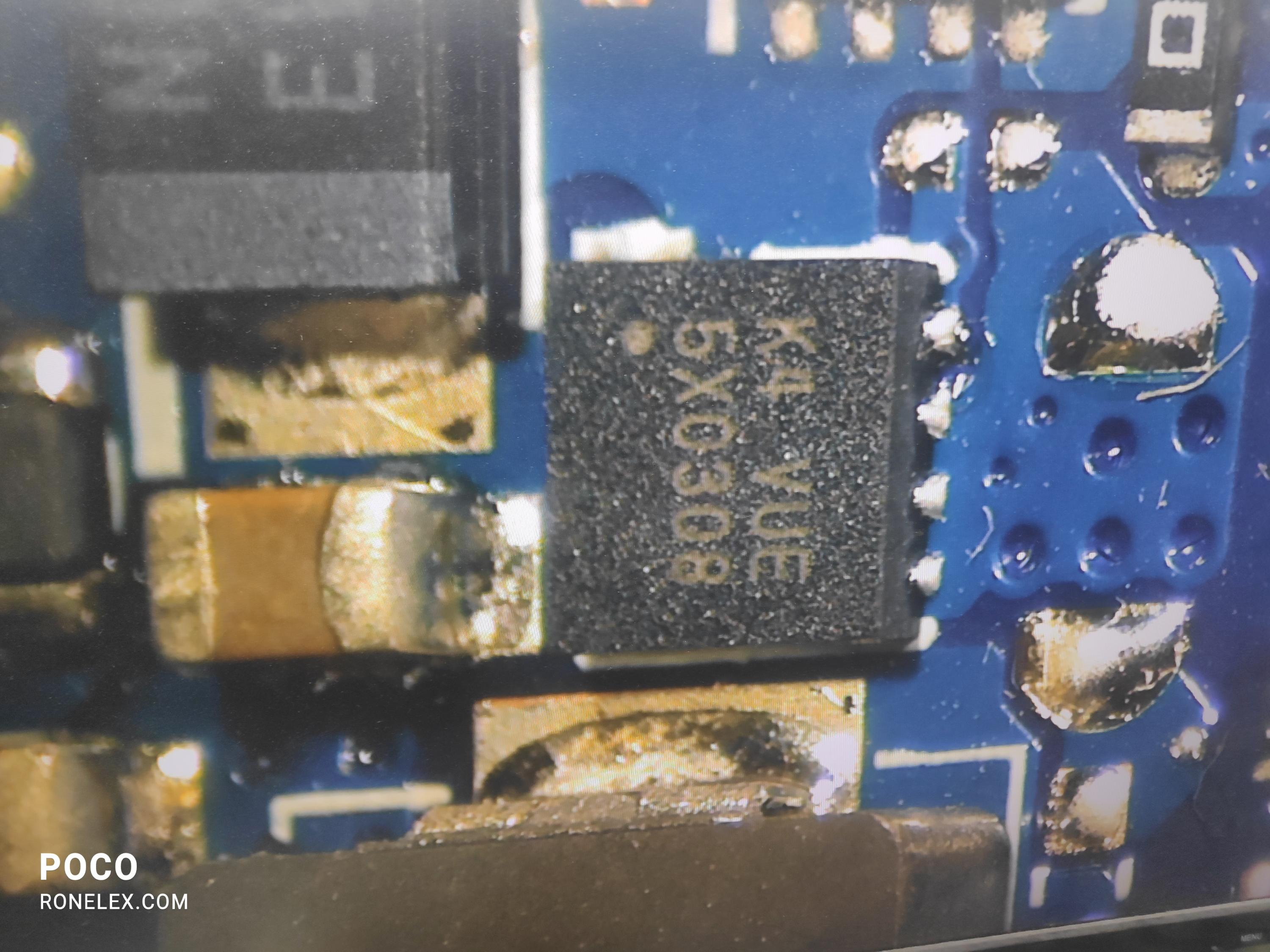

    Hello, does anyone know the part number of this IC in the unit I have repaired
    with a marking code:
    K4 VUE
    560308
    I think it is a dual mosfet
    The unit is Asus UX363 and no boardview available and schematic

    Re: Help Identify Parts in Asus UX363E
    PE642DT
    Datasheet here
      Originally posted by Bonzas
      PE642DT
      Datasheet here
      THank you so Much sir

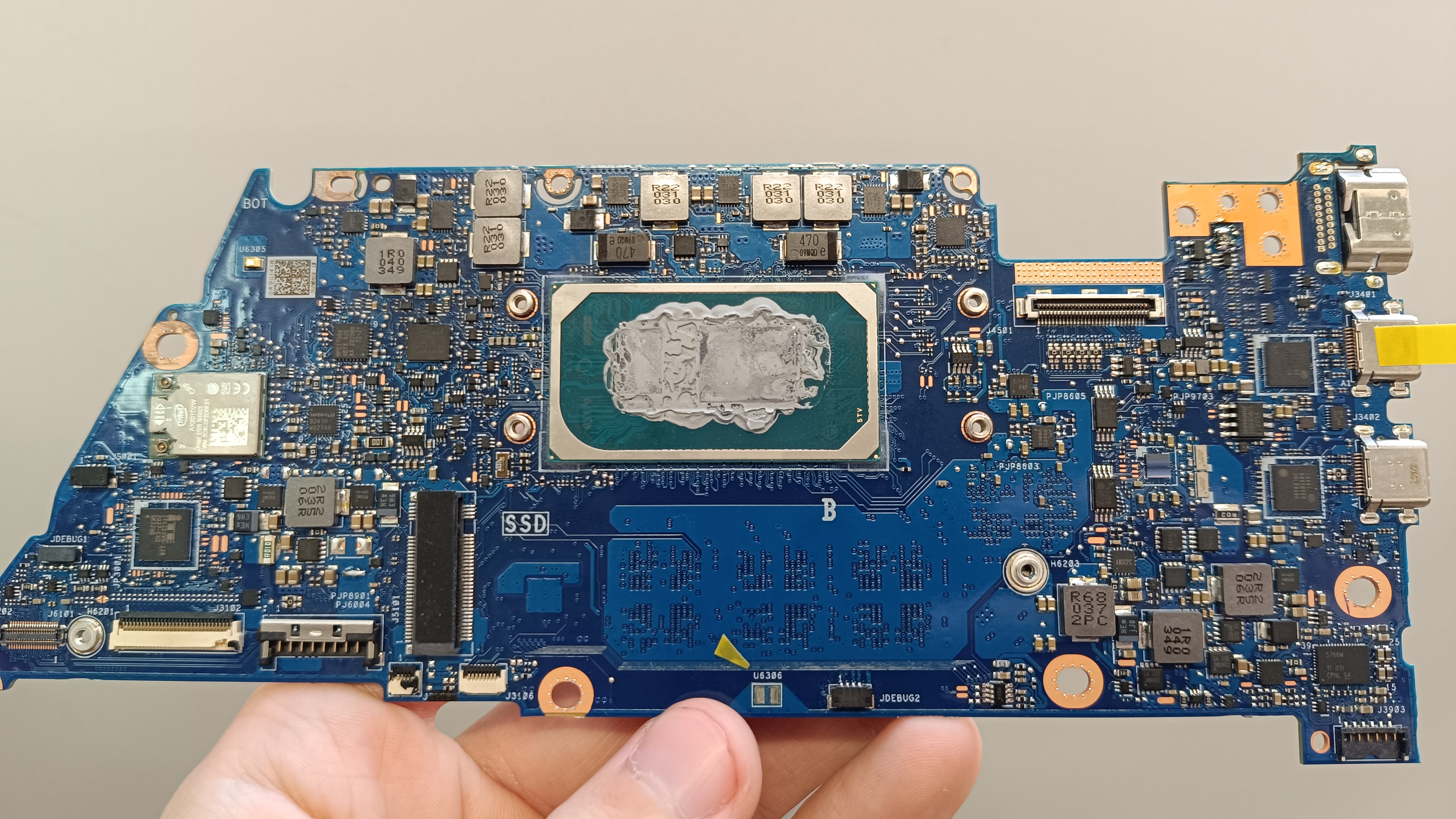

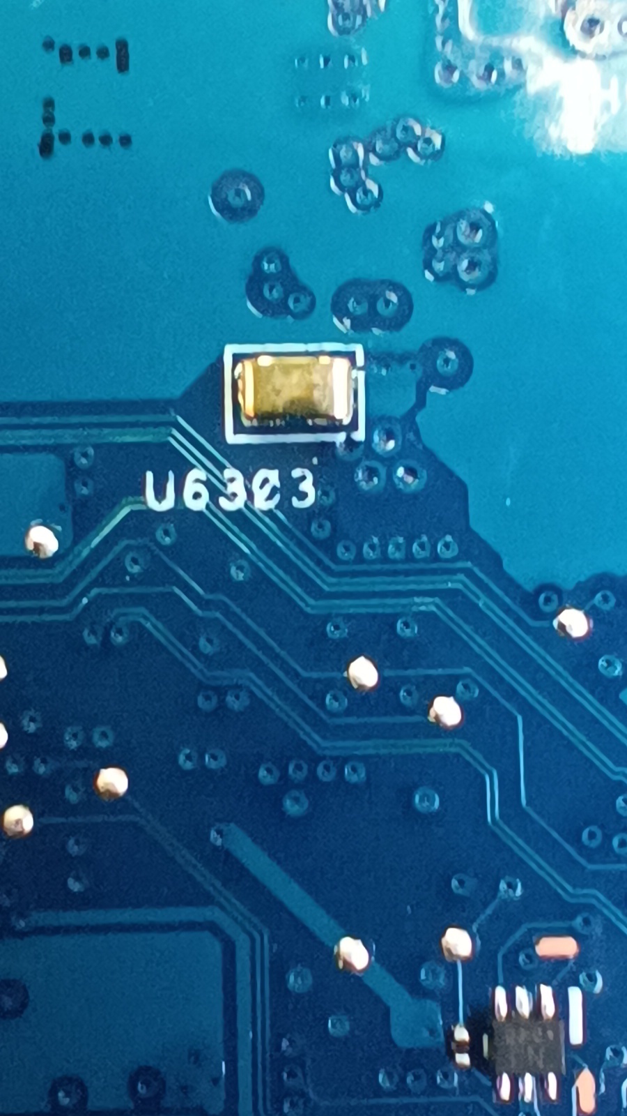

                    Hello, i need to find the component in front of the red arrow on the same motherboard, for a repair, but i dont find any shematics, can you help me ?
                          Looks like FUSE.....

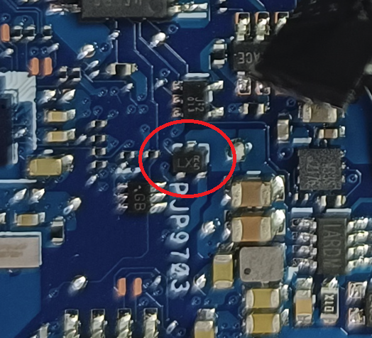

                            Hi, does anyone can help me to identify the part number for this IC? it has "LXR5" mark on it.
                            Board model: UX363EA​

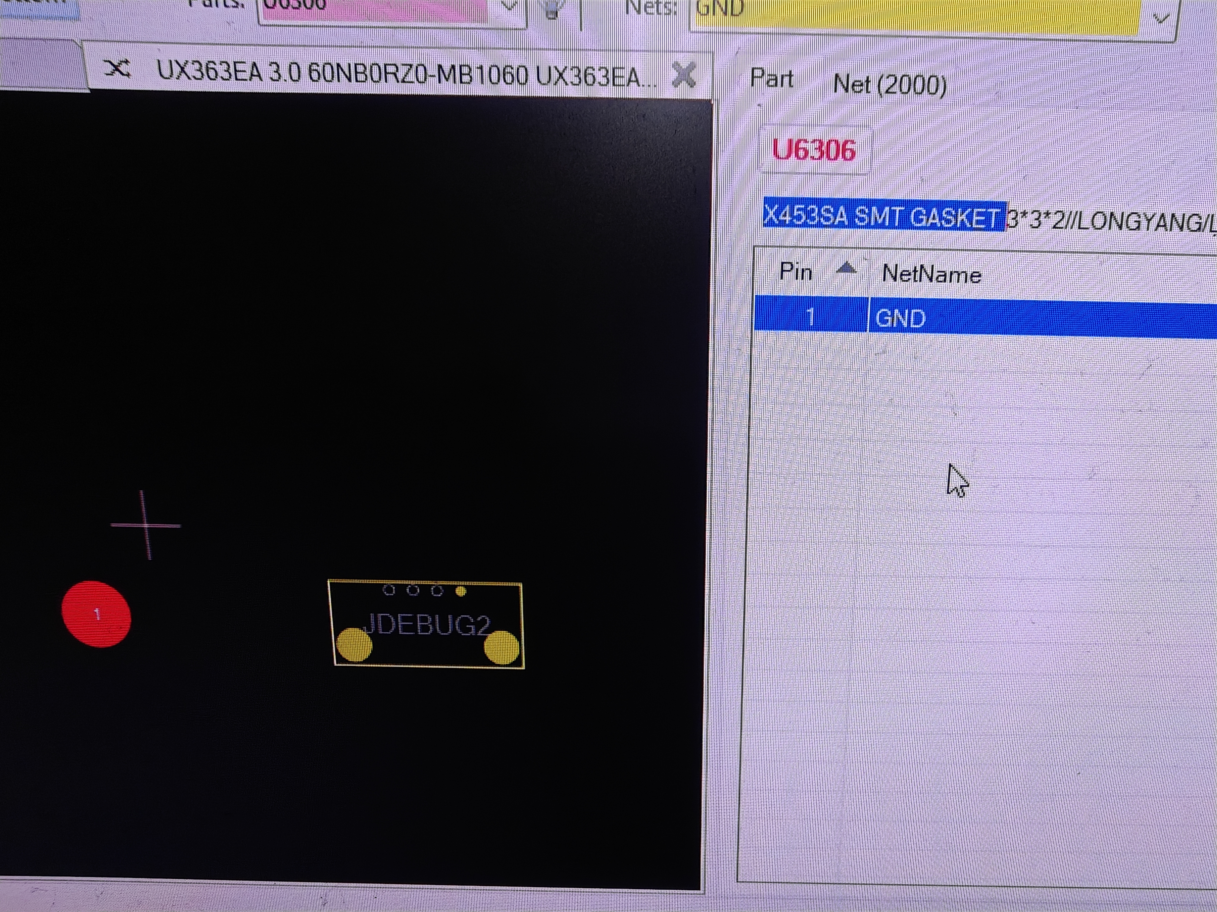

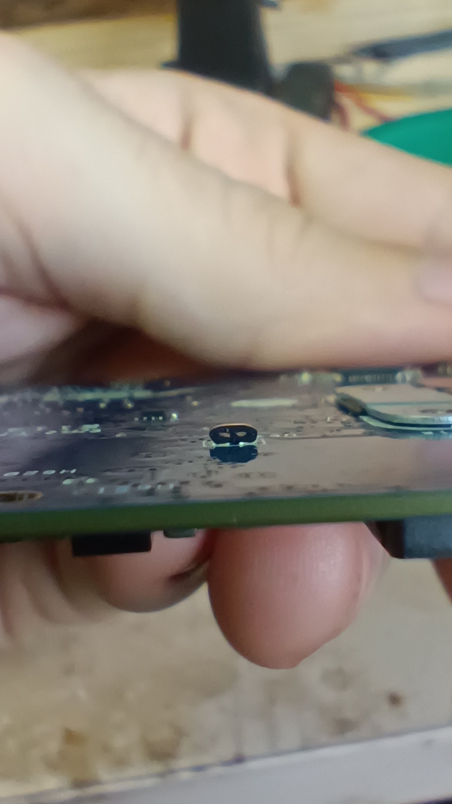

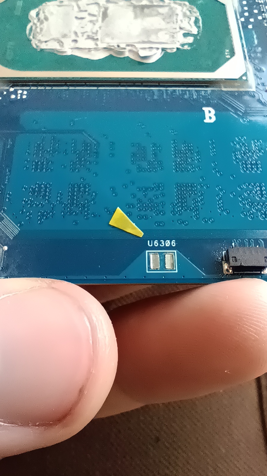

                              Hello again, I was able to replace the fuse that was faulty, but I am missing another component that was completely corroded, it looks like a small metal sponge and is marked U6306. I am attaching the photos below.
                              • noname2024
                                • Aug 2024
                                • 295
                                • CỎ MỸ XỊN
                                Gnd Click image for larger version
