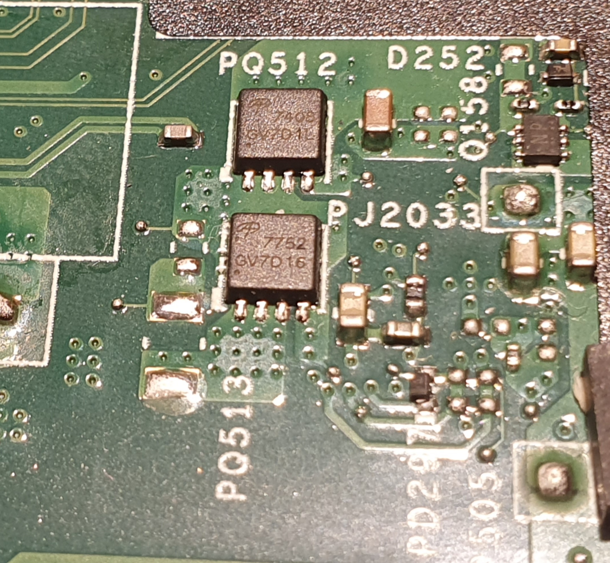

    Lenovo Yoga370 CIZS3 LA-E292P Identify parts
    please someone help to identify part PQ512 . IT IS A SMALL mosfet and is burned out
    thanks
      thanks
      If you still looking for that:
      https://www.aosmd.com/sites/default/...ts/AON7408.pdf
