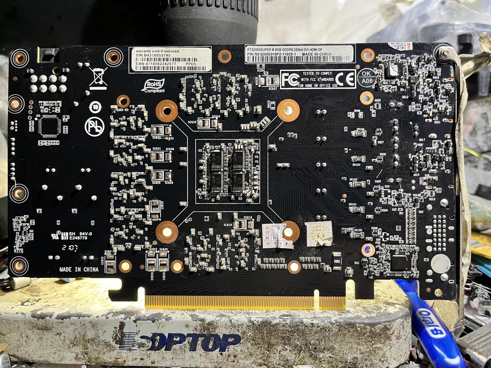

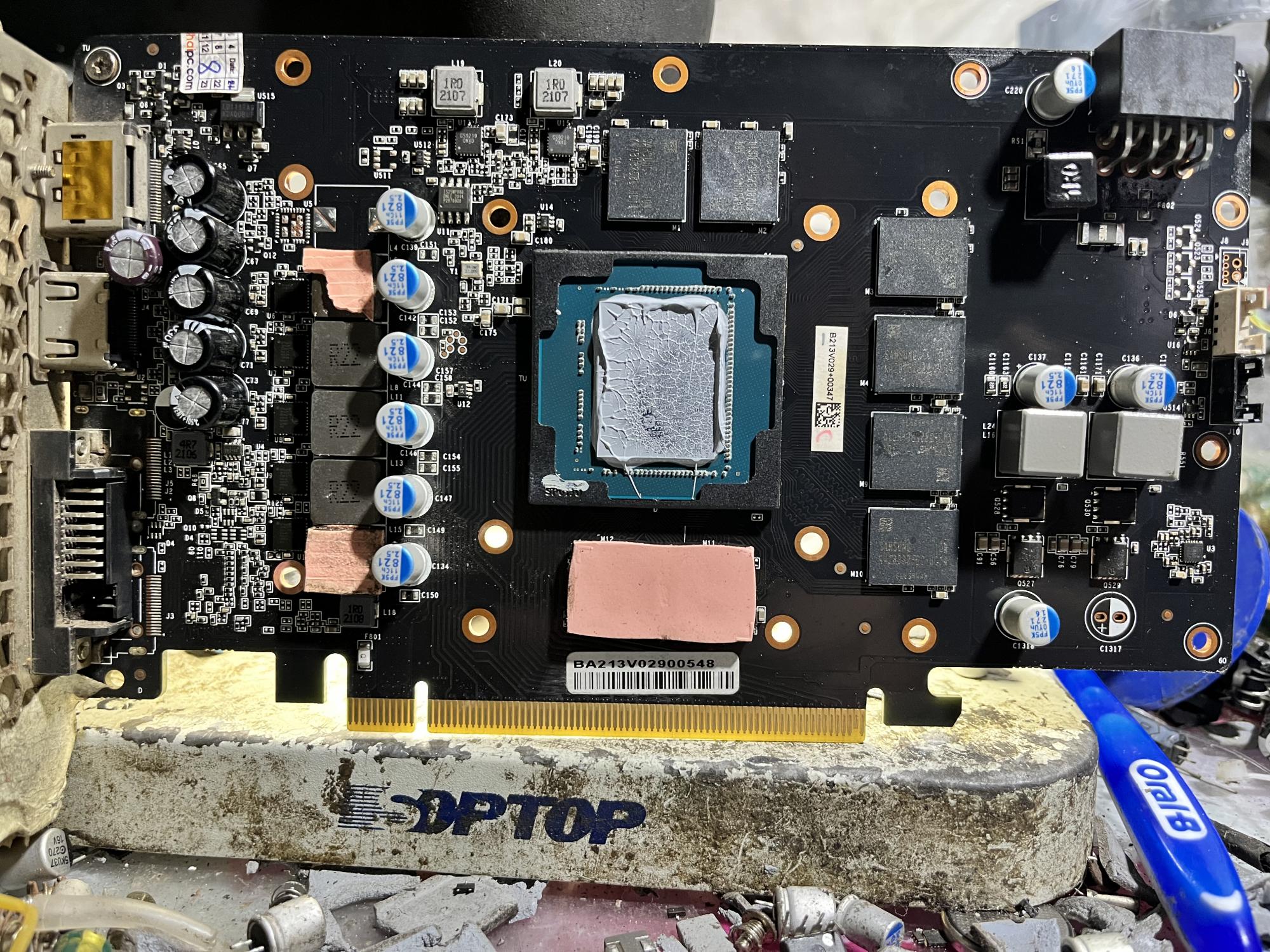

    Board picture PNY RTX 2060 SUPER M 8GD6
    This board was repaired by me
    Pan on this board is short circuit of 12v pex because dead mosfet u6 and all filter capacitors of VRM block are weak.
    Is there a board view for that model?
