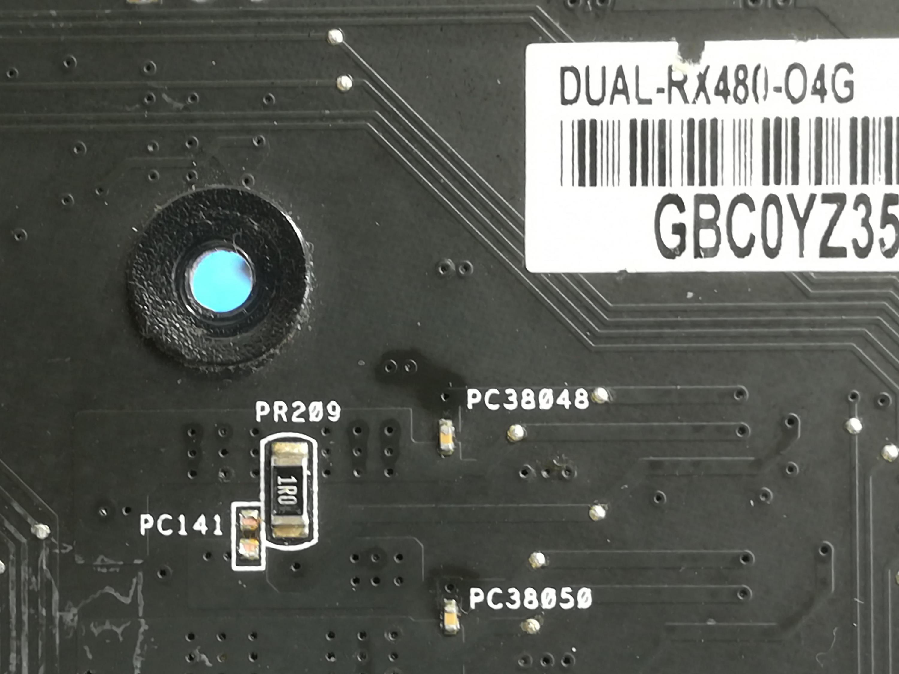

    I have an Asus Dual RX480 graphics card which is missing a capacitor, the component in question is labelled PC141 and I have no idea what value to replace it with.
    I have searched the forums and had a look at the MSI RX480 schematics which has helped identify a couple of other components but there is no reference to PC141 or similar that I could find.
    The missing component is located in the top right hand corner on the back side of the card (not far from the HDMI connectors). I have attached a photo in case it's of any help.

    Measure both pads of the PCB, if one goes to ground, probably is filtering and work without it, unless it´s bootstrapping a data line...
    That resistor seems to be as a shunt, maybe

      Thanks bajinchi, just waiting for one more missing component to arrive and I'll give it a try.
