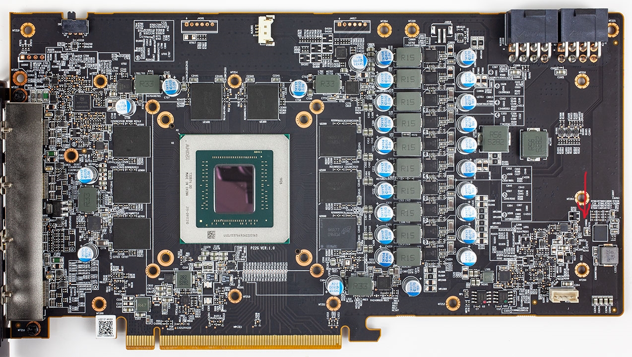

    Powercolor rx5700xt red devil
    Can anyone tell me what farads this capacitor is ? # C8898 on the board.

  • ongobongo
    RX 5700 XT shorted power rails
    by ongobongo
    I just received a non working Powercolor RX5700XT Red Devil which I'm trying to repair.
    Card does nothing so I dissasembled it and tested for rails.
    12V is fine, as well as 5V and 3,3v.
    Problem is that 1,8V and 0,75V both dead short to ground (and to each other).
    I tried injecting 0,75V into the rails, but the only spot that is lightly glowing, although set to 3A, is a little spot on the edge of the APU-die.
    Am I right in assuming that the APU is dead and the card is for donors or did I miss anything?
