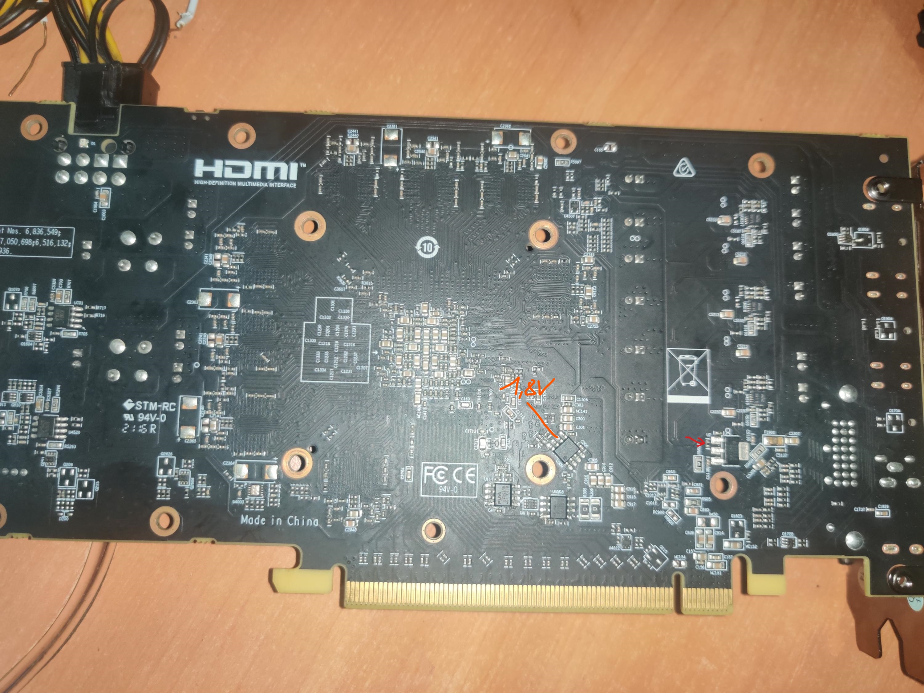

    I bios modded one of my xfx rx 580 and then it never worked again. I realize that I flashed wrong bios ( my memories are hynix but I flashed micron bios). Card never booted. It has 2 bioses and switching bios also did not work. I used ch341a programmer to flash original bios it did not work too. Now when I plug the card blue led is on ( near the 8pin 12v connector ) but card not recognized of the system. I made lots of research and tried everything still no luck. Then I found cad file of another card some components are same. Then I started to diagnose. And I found something, on U300 component there should be 1.8v but my card has 3.3v. Also no voltage on display rail ( PC919 sorry if I'm wrong ). In the cad file there is a component that generates 1.8v but I couldn't find it on my board.

    I took your photo, 1.8V is on the pin with orange line.
    Could you do me a favor and measure the resistance (not powered on) over the resistor next to the 5V LDO (red arrow) ?

      Measured between 1.8V and 5V LDO 0.467KOhm
      Thanks for help and sorry for late reply

        Hi, I meant just the resistance over the resistor next to the LDO.
        Reason I'm asking: my LDO only outputs about 4V and I suspect that is the reason why memory and GPU power don't come up. Since that resistor is between the LDO's output and ground, I suspect it being faulty.

          0.184kOhm
          what is your 1.8v and ground resistance?

            It raises quickly, but then settles on 2.5 kOhm after about 2 sec

              Would you mind giving me a measurement for the resistor right next to pin 1 of the LDO (perpendicular to the other one)
              LDO datasheet https://pdf1.alldatasheet.com/datash...M1117-ADJ.html
              The first resistor and this one form the voltage regulator for the adjustment of the LDO.
              The first is 183 Ohm, so that's the same as your measurement. The other measures 467 Ohm here. With these values I can't get 5V (calculated using https://eepower.com/tools/linear-regulator-calculator/)

                I was wrong, made a thinking error, seems the calculation is correct. So I suspect my LDO is faulty...

                  Did you find 1.8V, as in when powered ? If you don't have 1.8V, all the rest will never power up.
                  If you have it, you can trace it to all the other circuits that use is to see wether it makes it there.
