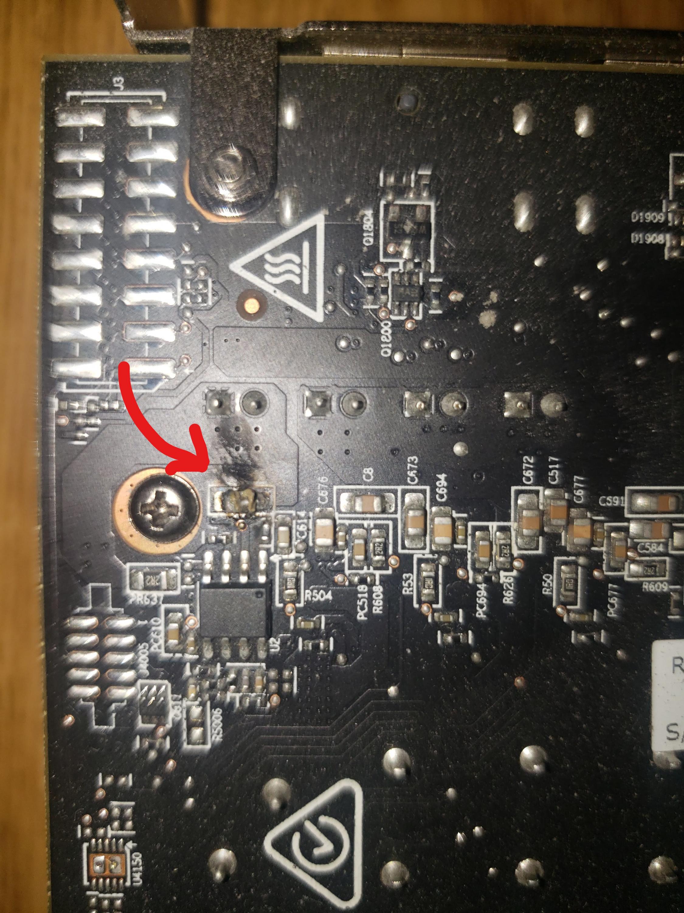

    Need cap information for MSI RX480
    I bought this card used a couple years ago, got a bit of time on the clock before it let the smoke out. The cap is toast and burned off the component number for the cap.
    Not sure if this is the only issue, but I figured I would try to replace it before I binned it.
    Anyone know the specs for this cap or have the component ID?
    Thanks!
  • Bozog
    • Jan 2022
    • 125
    Re: Need cap information for MSI RX480
    Could well be the only issue, looks like its in parallel with an electrolytic cap so it should work without it, maybe something to try before worrying about replacing it. Its probably something like a 4u7
    • joila
      • Feb 2022
      • 3
      Thanks! I'll give it a shot.

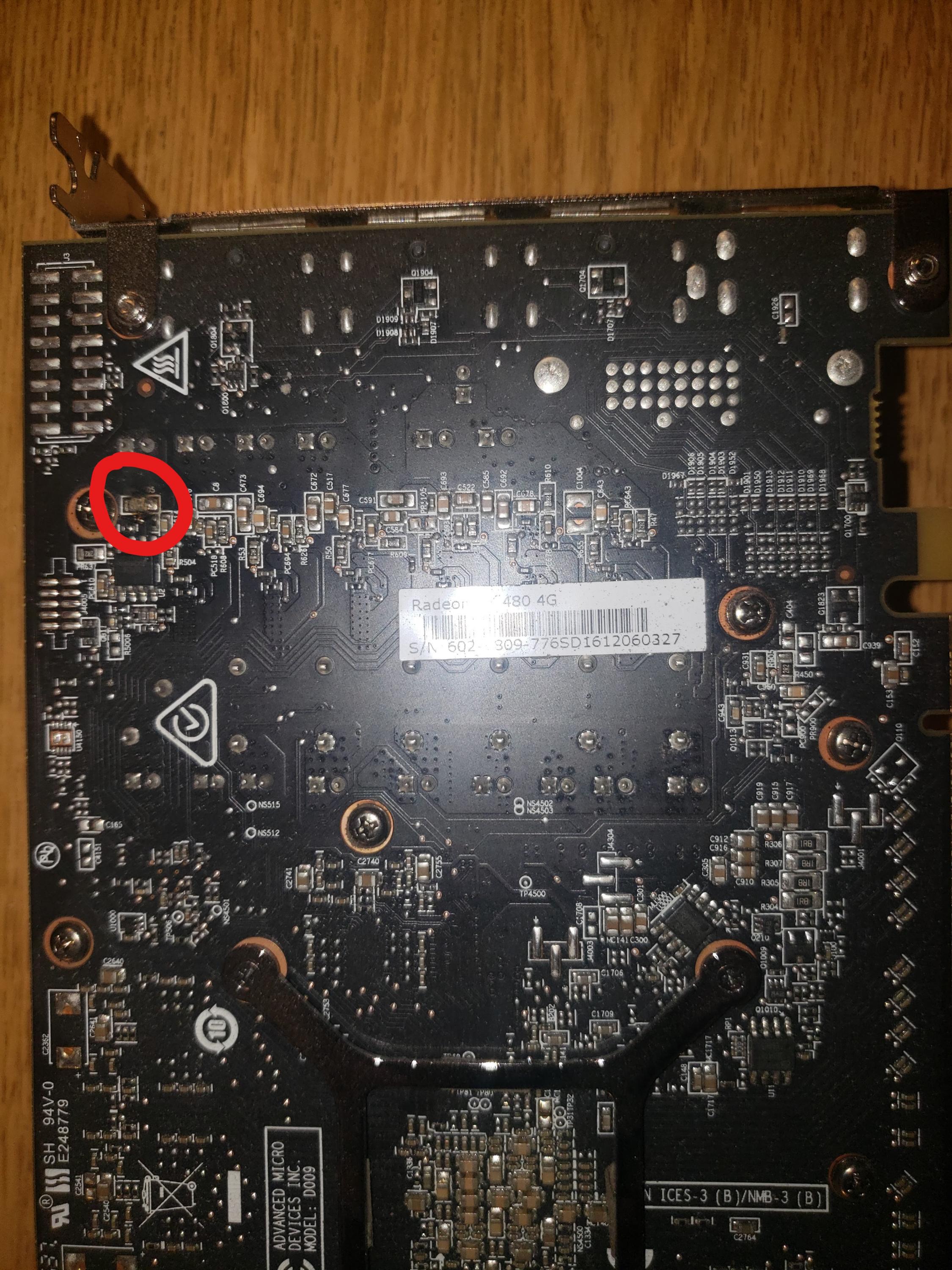

        Asus Dual RX480 04G component identification
        by ff007
        I have an Asus Dual RX480 graphics card which is missing a capacitor, the component in question is labelled PC141 and I have no idea what value to replace it with.
        I have searched the forums and had a look at the MSI RX480 schematics which has helped identify a couple of other components but there is no reference to PC141 or similar that I could find.
        The missing component is located in the top right hand corner on the back side of the card (not far from the HDMI connectors). I have attached a photo in case it's of any help.
        Than...
