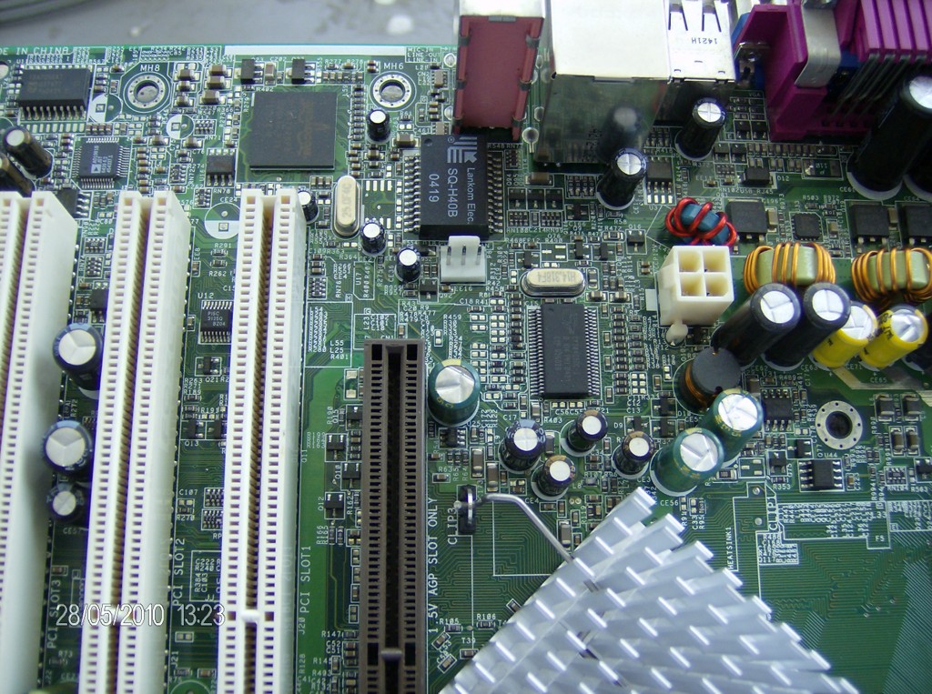

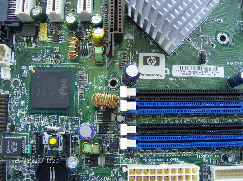

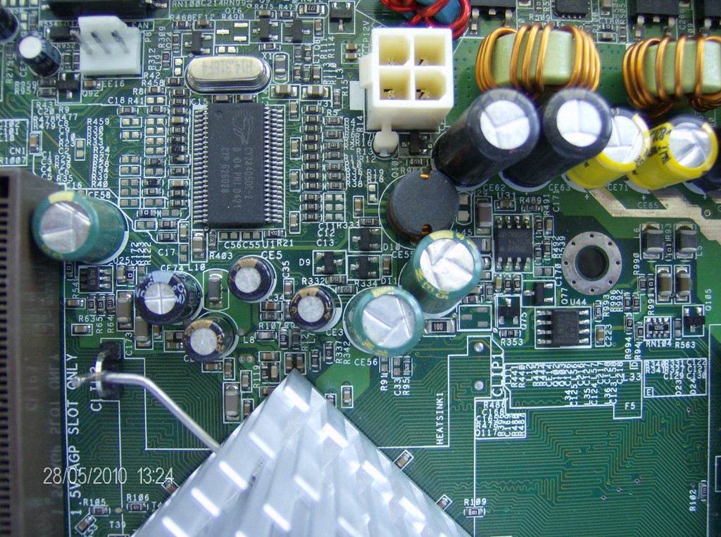

    Hey all, this is another p4sd i got today, the user says it sends no video, someone checked it before and didnt get conclussions on it, im gonna recap some of the caps i see blown, wich are marked in the first pic, i would like to hear opinions on those and the rest, if you consider i should recap any other please just advise... i am not touching the yellow ones cause ive been told in this site they're a special type and also cause i dont see em blown, -wel yeah i do, two out of four look bad IMO around the processor....- anyways i dont have such value/type so im not recappin those as of today...
    so i got no POST, the best it was on a try with no DIMMs showed the no memory error (the beeps and red flashes) and then i installed one and got nothing again
    so if theres any advise for me in this case please let me know, it'd be very much appreciated.
    Thanks.
    Overview... the ones marked are the ones im changing cause according to me they're blown...
    Peace.

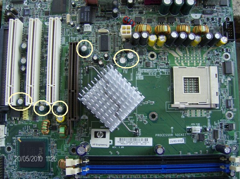

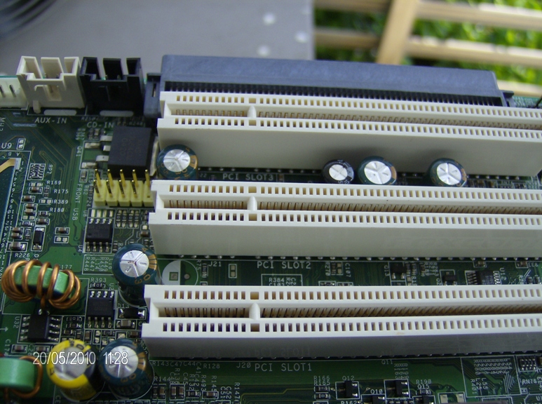

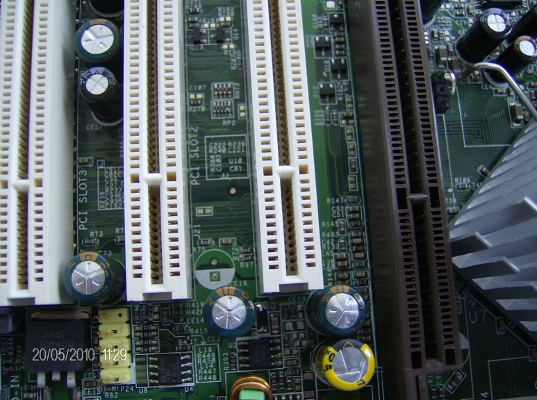

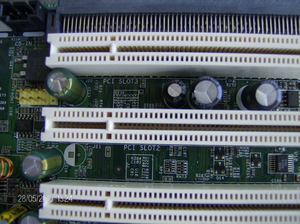

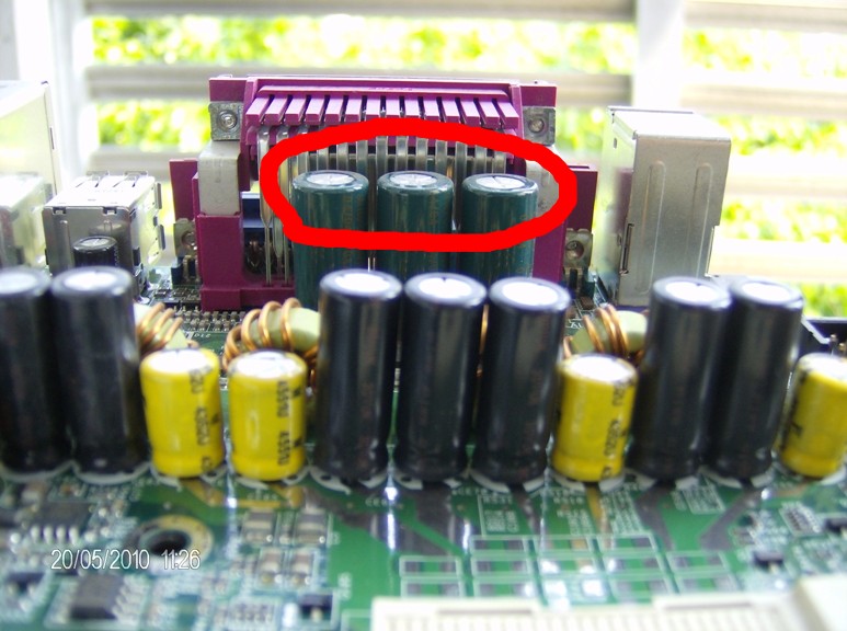

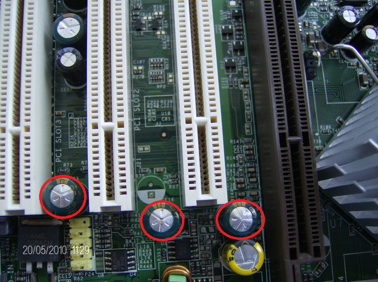

    Recap the board. I see 3 domed caps next to the PCI slots as marked in the attached photo:

      THANK YOU. I did change those caps... but, still nothing. Changed total of 7 caps, all same value.
      UPDATE: Hey, i recapped those I marked and then tested, nothing, no POST, nada.
      Then I used the hot air gun and heated it a little, allowed it to cool off and then tested, results still nothing.
      If somebody out there has anything on this board (P4SD) that'd help it'd be appreciated. I cant just change boards I wish I could.
      BTW all those caps i changed were 1000uf/6.3v TAEPO and i changed em others same values but the brand, Sanyo.
      Thanks.

        the yellow ones in the photos are sanyo??
        • c_hegge
          • Sep 2009
          • 5219
          Re: P4SD - case N3Q
          No, the yellow ones they are actually polys. Fujitsu used to make their polys look like lytics, but not anymore.
          Replace ALL teapo caps, bulged or not. they are notorius for failing without showing it. the ones which are most likely to be the problem are the ones circled here.
          Also, what brand/series did you replace them with?

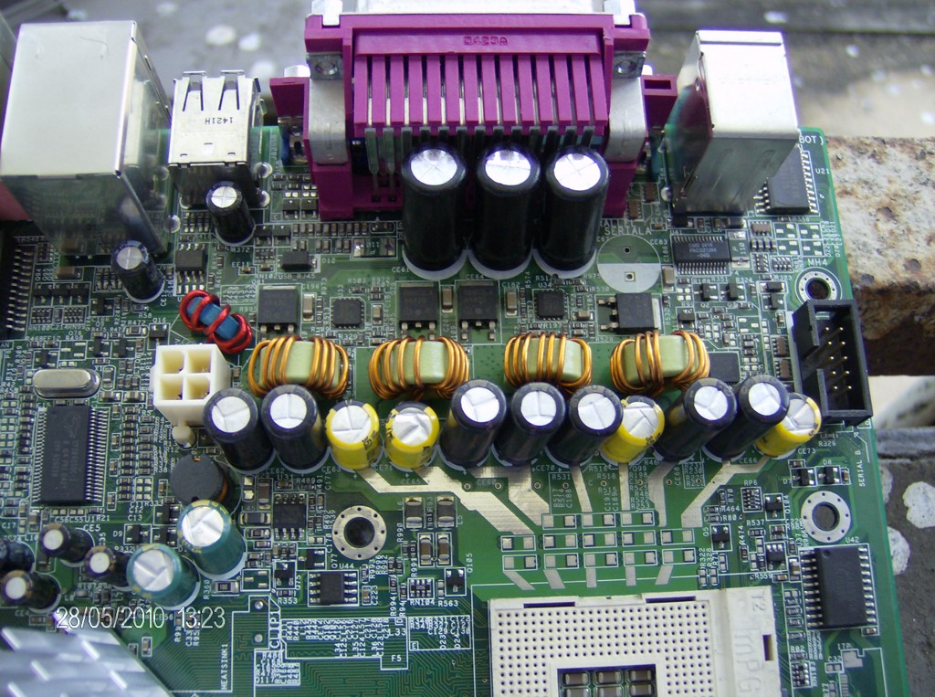

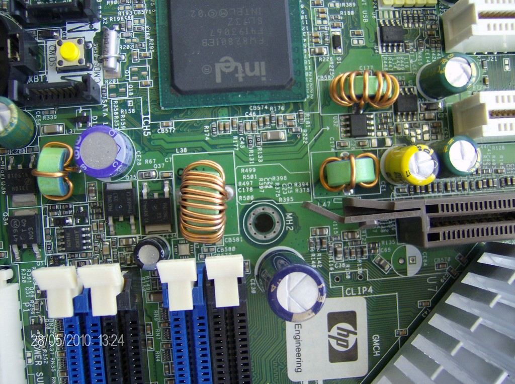

              UPDATE: I changed the few TAEPO cheapo the board had left, including the three caps marked by you c_hegge, results:
              after the recap I just added the processor and its cooler with one DIMM, it DID show the POST, I turned it off and thought it wasa time to put the other DIMM and place the processor and the board base (cause the proc was just put there no base no locks) once mounted it did not show POST or anything, i tried different DIMMs and processors, and obtained a few other failing POSTs, mostly memory test fail but I dont think is the DIMMs themselves cause I swap em and one time it gave me the memory error with the DIMM it originally worked out... so im stuck with this board that now gave me one sucessful POST a few other unsuccessful and now is back again to nothing... any suggestions??
              BTW i have figured that the 1800uf around the processor, the ones mixed with the yellow ones are not the originals but recapped... now they dont look bad but i was wondering if they beiing such a crappy brand might be causeing me this issue?
              wel im planning on applying some heat to it and see what happens, any idea is welcome.

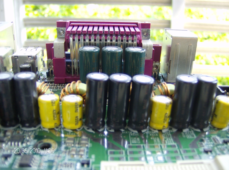

                  The ones around the CPU (the ones with T-Vents) look like Panasonic FJ. They are a reliable brand and can probably be left in place. Sanyo WG are fine as replacments, aut wendell are pure junk. You can get rubycon from badcaps.net

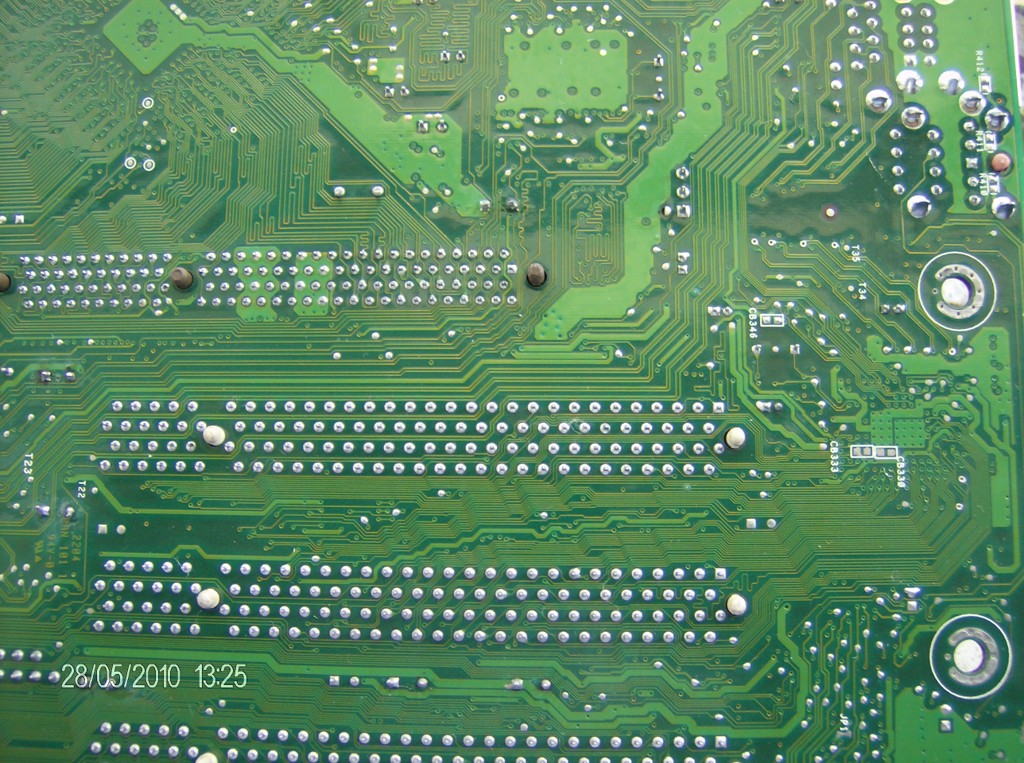

                          This board has just come back, no POST again ... I was wondering if some has any idea on what could i do to it, it worked for a few days and again, the same issues.
                          It was working on a wel ventilated area... when it arrived i tested it and it did boot up first time but got stuck at the middle of the OS booting, and thats it.
                          Any idea is welcome.
                          Thanks.

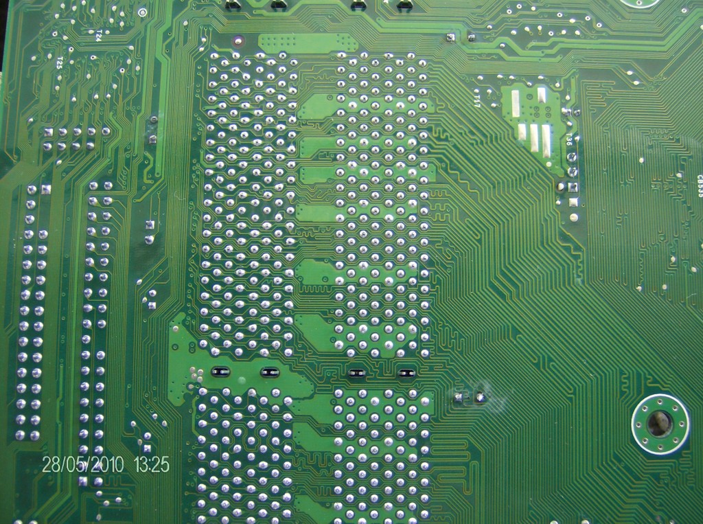

                            Re: P4SD - case N3Q

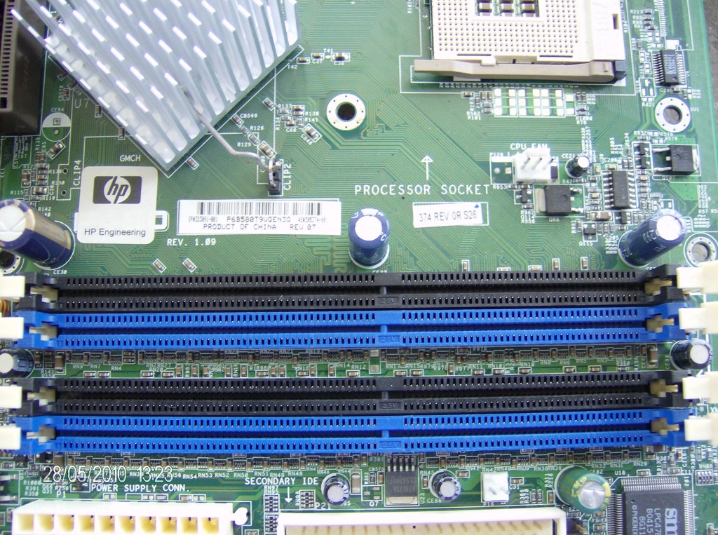

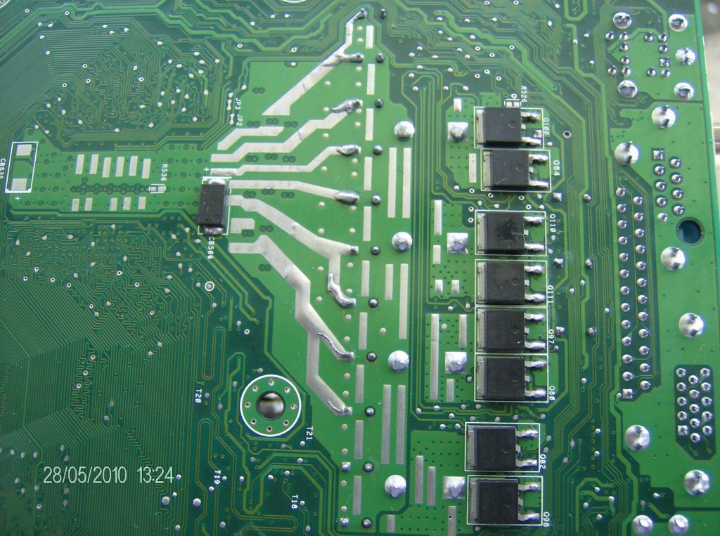

                            This is what it looks like today, i havent done nothing to it since it came back
                            Any idea is welcome
                            Thanks.

                              All I can think of is that you could be using an inappropriate series of capacitor in your re-caps. I'm assuming that the 3 big ones near the Parallel port are 1500uF 16v. In that case use these:
                              https://www.badcaps.net/store/produc...products_id=38
                              For the other 1500uF (6.3 or 10v I'm assuming) caps where you used LTEC, use these:
                              https://www.badcaps.net/store/produc...products_id=39
                              Correct me if I am wrong about te values.

                                the big ones on the parallel port are 1200uf/16v
                                the ones besides the DIMM slot are 1500uf/6.3v
                                Thanks for the info, Im checkin it out, unfortunetly I think I wont be able to order right there but I might be able to find better than what I currently have.

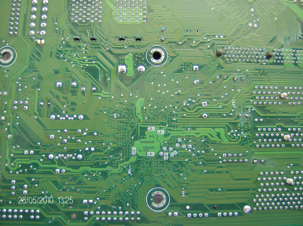

                                  UPDATE: I applied the heating method on the CPU socket w/Flux and the board has been working on mtest+ for the last 6hrs with 25 complete passes and 0 errors.
                                  Unfortunately i wont leave it on all night since weve had some source -electricity- issues and i dont wanna risk it.
                                  Tomorrow morning i will put it under mprime all day and see what happens, but so far, so good.
                                  Thanks.

                                    well... now you know what to do first on all the other P4SD's
                                    mine is still working fine. probably cause the PSU died early and it wasn't used/fixed since then. i'm currently using the board with a metal backplate in a standard µATX tower to prevent the cooler from bending the PCB too much and cause those socket issues..
                                    edit: something like this.. half a milimeter thick.. got it from ebay
                                    (not my pic)
