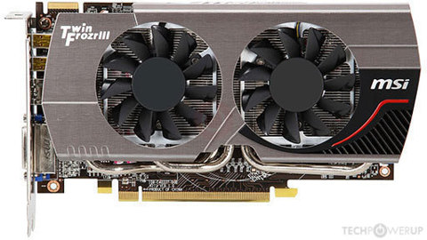

    MSI HD 7850 Twin Frozr III Capacitor burned
    I don't know if here is right category where I'm asking.

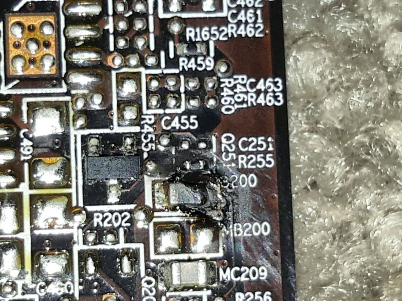

    My graphic card's FAN cable was problem it was my wrong that 2 wires of fan touched together and soddenly I saw the flash where one of the capacitors burned.
    *I tested Graphic Card works fine, but Fan doesn't work at all. I think the capacitor was for fan's power
    I want to order new replacement could you guide me what type of capacitor should I order?
    Thank you,

    Re: MSI HD 7850 Twin Frozr III Capacitor burned
    as first u need to remove it. as it is welded to pad u must rip it off or grind it
    but it looks like a coil

      Yes, I have air gun solder, one stupid question, Can I remove up cover and VGA Fans and put 2 fans from old motherboards and put on it and plug to mainboard socket? :-)
