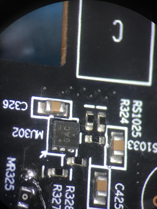

    Hello community, how are you?
    Entrance to the workshop is vga rx 5500xt 4gb, which does not give video and the fans do not turn. He proceeded to disassemble and measure. I have short on leg 4 of the integrated APL5934D, I raise inject tension and heats this other component MU302 that I don't know what it is. Would you help me? Thanks!

    How many pins does MU302 have? I see 3, how many on the other side?
      • 21853
      Re: I need help to recognize this component : rx 5500xt 4gb
      It could be an onsemi NCP718AMTADJTBG ,marking GA plus date code.The dot under the A meaning lead-free

        He has 3 more, 6 in total. mosfet?

          Thanks for the help, it seems to be what you comment. I have to see where to get it from
