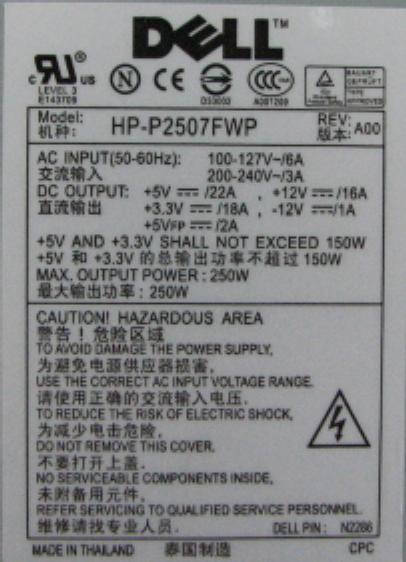

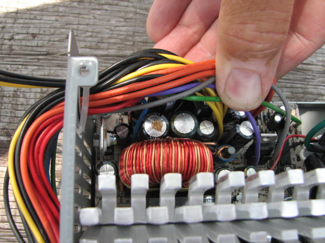

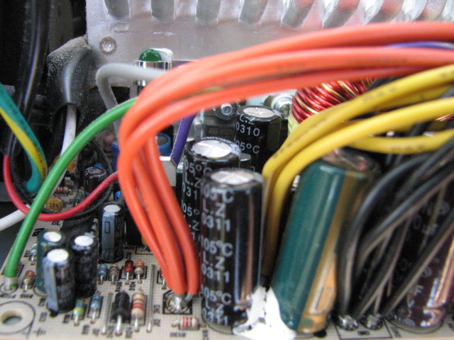

                            Re: Dell Optiplex SX280 Weird problem!!!!
                            Originally posted by momaka
                            Post some pictures too, if you can. Also, what brands are the caps that failed?
                            Been a busy week here, and lots of progress made.
                            First, some pictures of the swelled (several) and leaking (1) caps from the Dell Model HP-P2507FWP:
                            Leaking cap:
                            Swelled caps:
                            I'll have to oen it back up to get the manufacturer's name ...

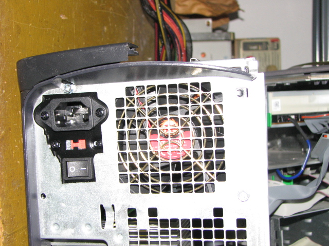

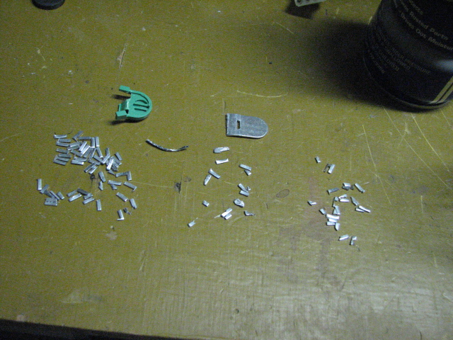

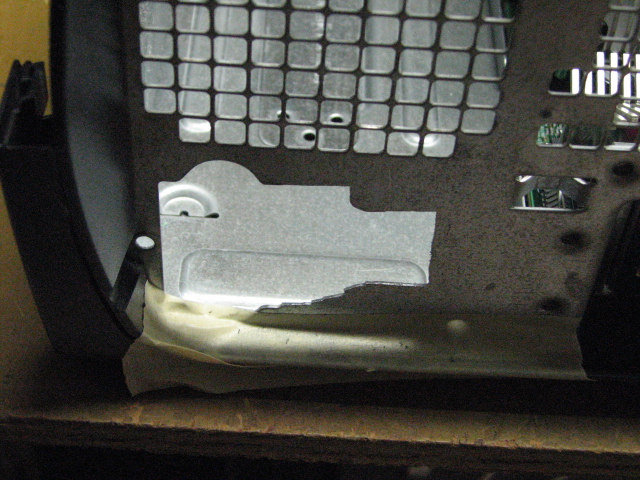

                              #34
                              Just make sure it will fit in your case. I have a TR2 as well (XP550-NP 430W) and it's about an inch longer than most power supplies due to the dual-fan design.
                              That's a good point, this TR2 is longer as well, but, by proper placing of the power supply cables I managed not to block the fan and also not get the cable crushed by the backend of the CD-ROM drive.
                              It took some nipping of the sheet metal with a nibbling tool and then the AC power switch on the PSU was no longer obscured/covered up.
                              Some pics - first, the still bits nibbled away, plus that some pieces (one piece of plastic) from that little 'arm' inside the PC that used to 'hold' the Dell PSU in place:
                              Rear PC opening nibbled to accomodate AC power switch:
                              Thermaltake TR2 430W fitted into new opening:
                              And - the GOOD NEWS is the GX270 came up with the HD attached now ... the new OS was installed without a hitch and the GX270 is back in 'service'. I owe this success in good measure to the resources, the information, the people of badcaps.net - thanks guys, I would have been lost without reading about the experiences others had with these PCs. Thanks again.
                              Jim
